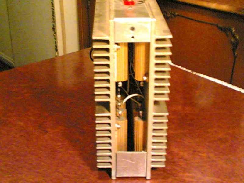

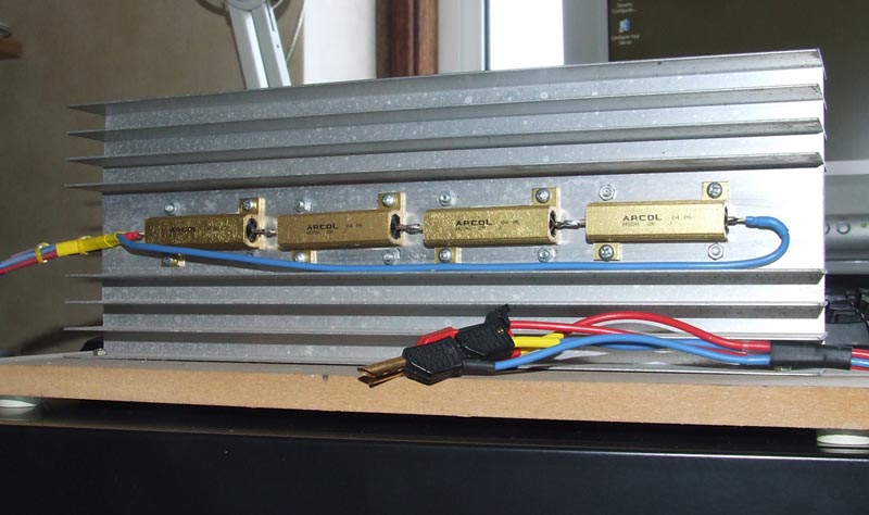

this is what I use. 15x 10w 56 ohm resistors parallel each side.
I figured if the amp would survive bench testing on 3.7ohm loads then it will do 4ohm easy. besides, resistance goes up when they start heating up. 🙂

Hi zeonrider
Have you run your power resistor at some higher power level for any longer period of time, so that it did heat up a lot? I am thinking of using same lab sockets, which are rated around 80-100 degrees. I worrie what if air inside generated by resisotors will be 300, then over time case will heat up to that temp. too, melting plastic. Did you have anything like that in your case, or it doesn't heat up that much?
And what is that red thing around sockets?
