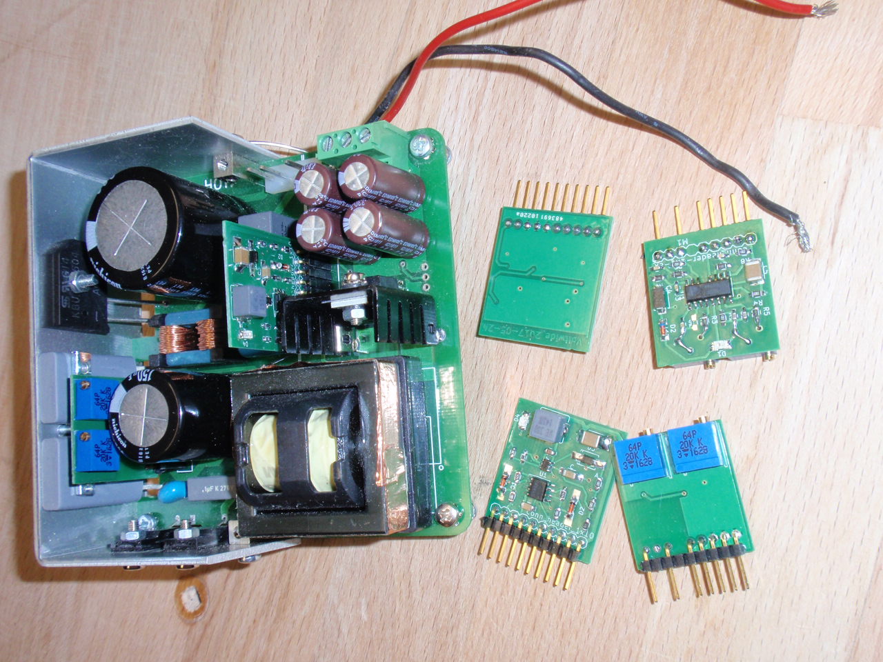

I have been thinking about an way to use off-set winding and also making the windings "taper off" as shown in the sketch. A quick test reveals that it should be possible to hit 45primary windings, and 100uH+300uH primary inductance with a approx 0,5mm gap in the center.
@voltvide: From what I can read in the differenr pdf's it appears that the x-former-window (the space to wind the pri and sec) is somewhat tailored to the application. So a transformer from an typical ATX-psu have a long and narrow window to allow best possible coupling and a x-former suitable for side-by-side (two-chambers) wil have a more square-ish window.
TroelsM
I do not see llc-xformers with square-like windows, because
they use the same core shapes as flyback or other converters.
The loose coupling is achieved with 2-chamber bobbins.
Have a look at one of my prototypes attached here:
I forget to mention that this xformer is readyly wound available from Wuerth Electronics, part No WE-760895651. Works nice here and could be a good starter for you as well. (Normally I do wind my own xformers, but I got hold of 3 free samples)

Thank you for the input. I see that most (if not all?) of the LLC constructions a side-by-side winding. With the stuff I have I cannot get a inductance-ratio of more than 1:2 and according to the literature you want the ratio to be between 1:3 and 1:10.
I just measured a " partly overlapping" transformer that measures around 360uH with sec open and 60uH with sec shorted. One problem is that the exposed part of the primary gets a little hot, maybe because the exposed part is the primary cause of the leakage?
It sounds clever with the PIC solution, but the LLC controllers are so cheap that the controller is not my main problem.
Did you make the transformer from scratch? did you measure Lp and Lm?
Kind regards TroelsM
I have used multiple strands and I'm pretty sure that the skin effect is not my biggest problem. It looks like the fringe flux around the center-leg-gap is a serious problem for the closest wires, - especially if they are thick.
