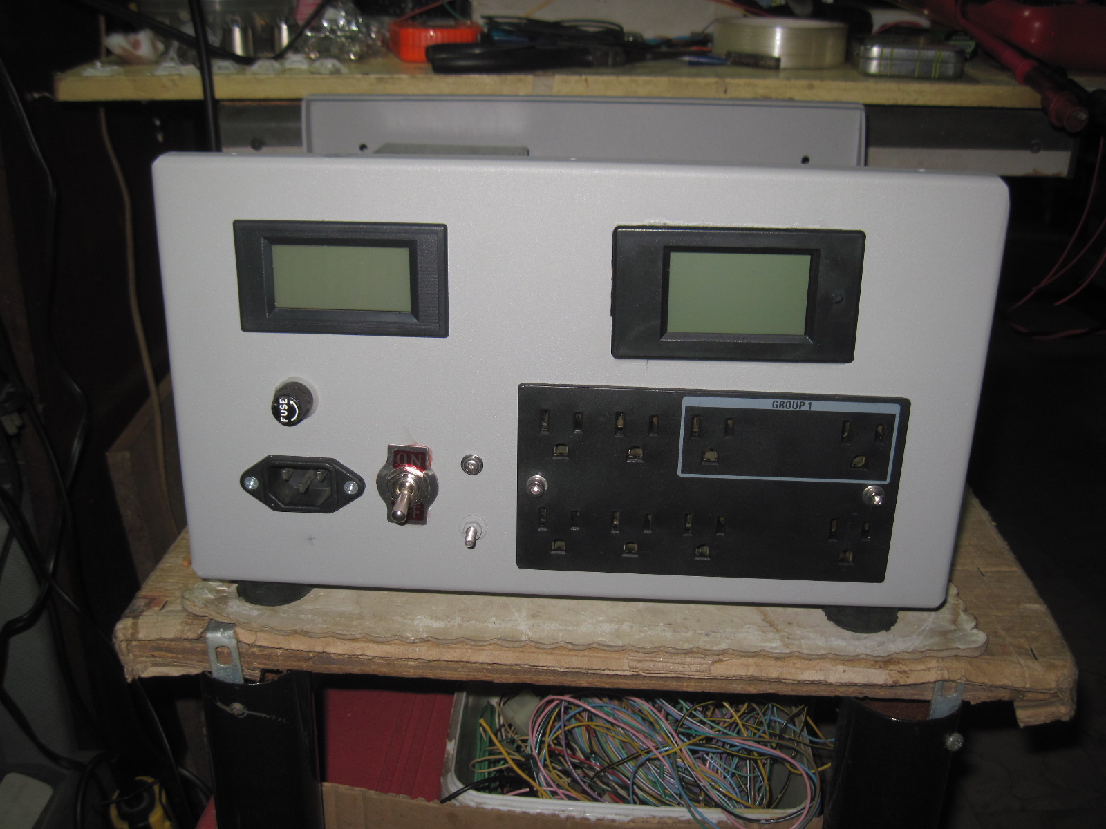

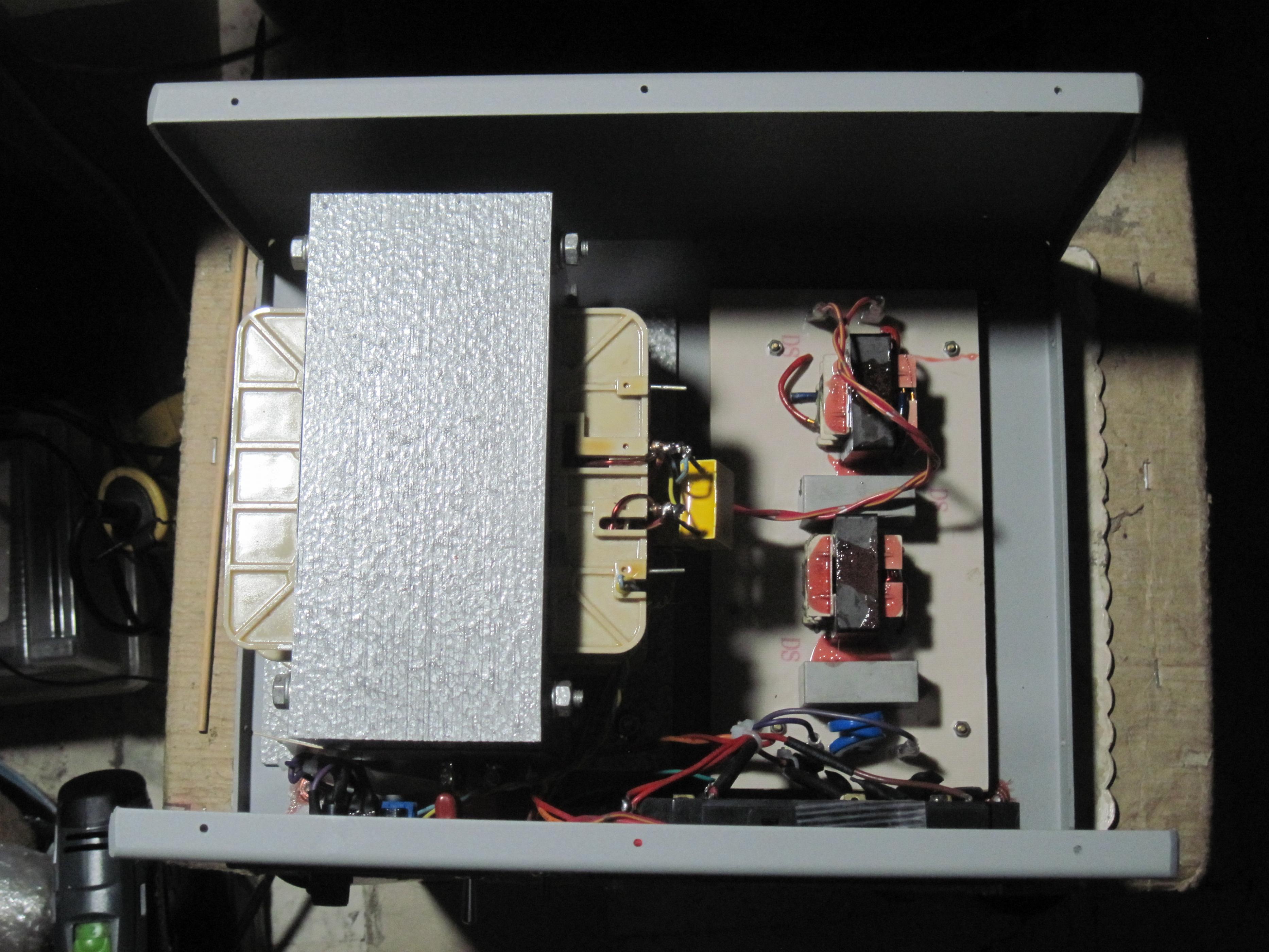

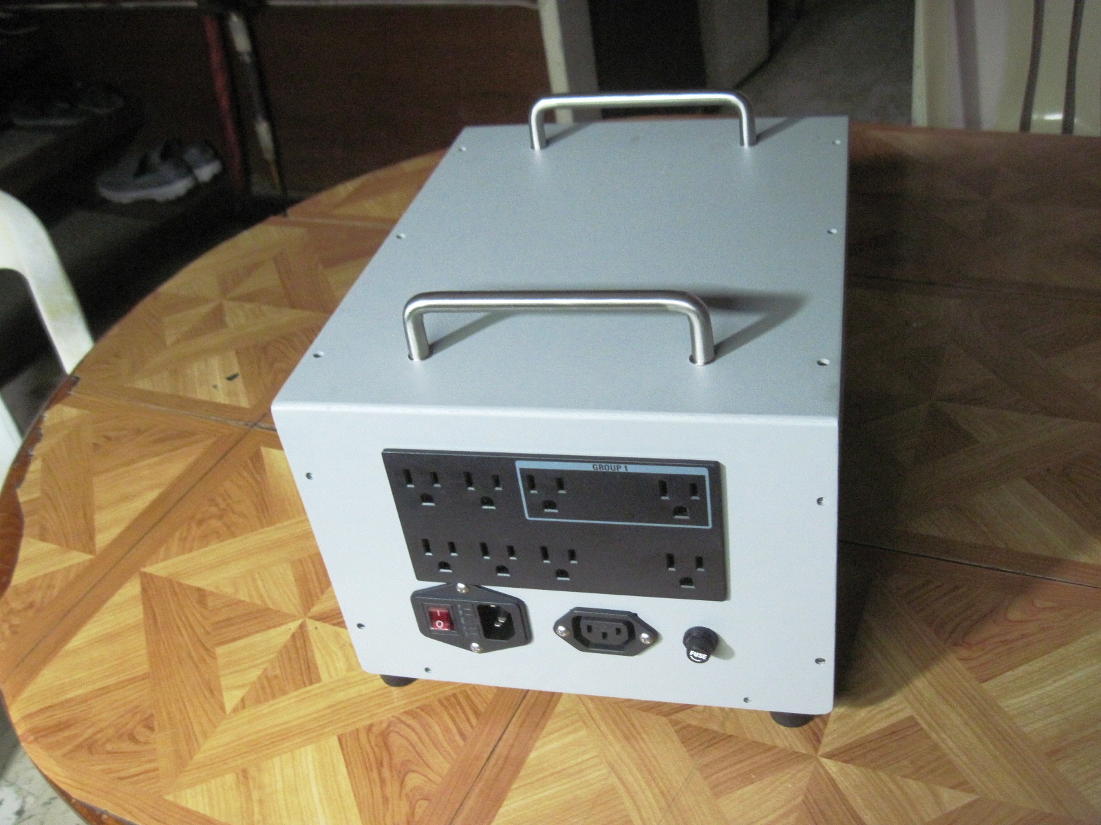

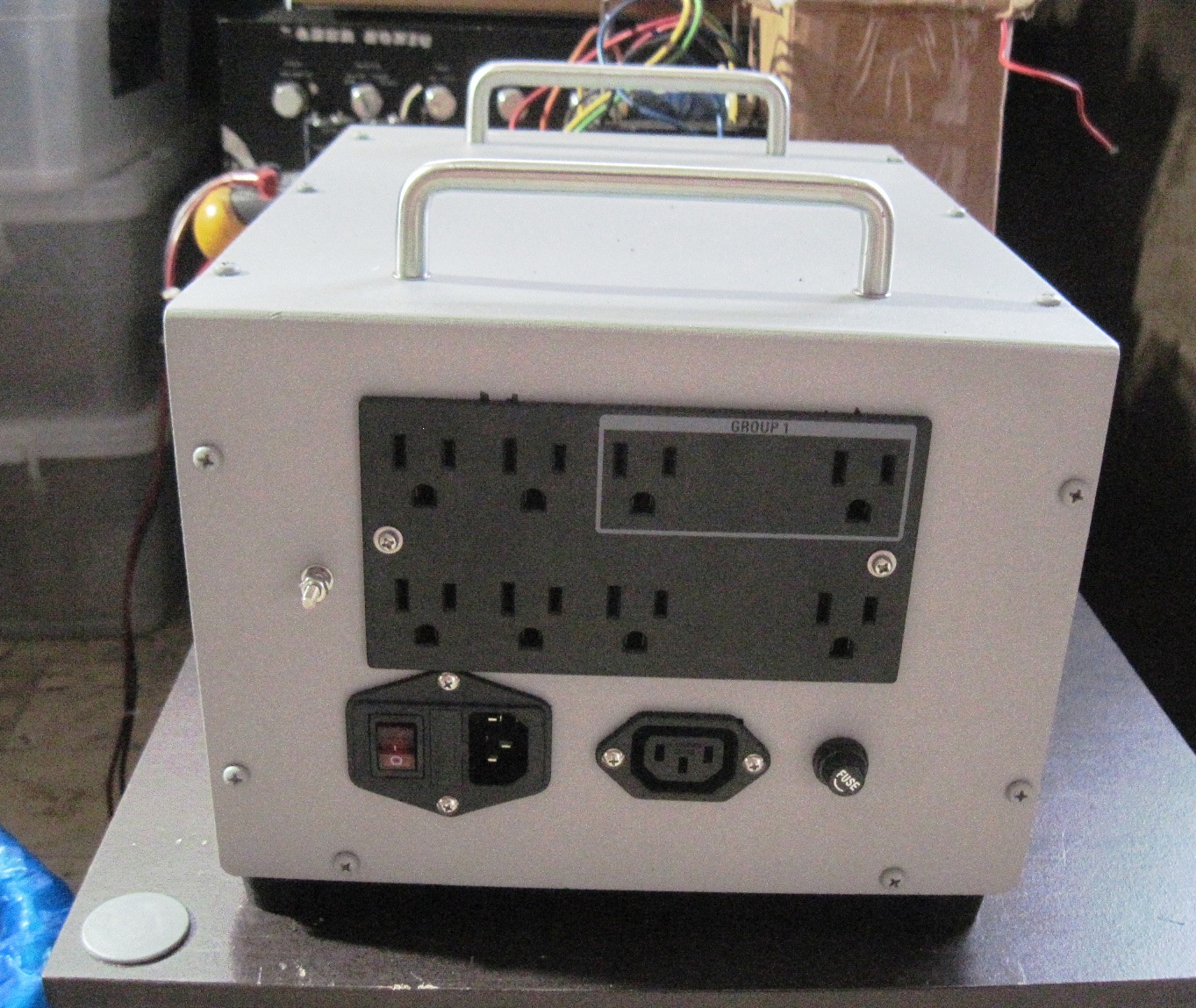

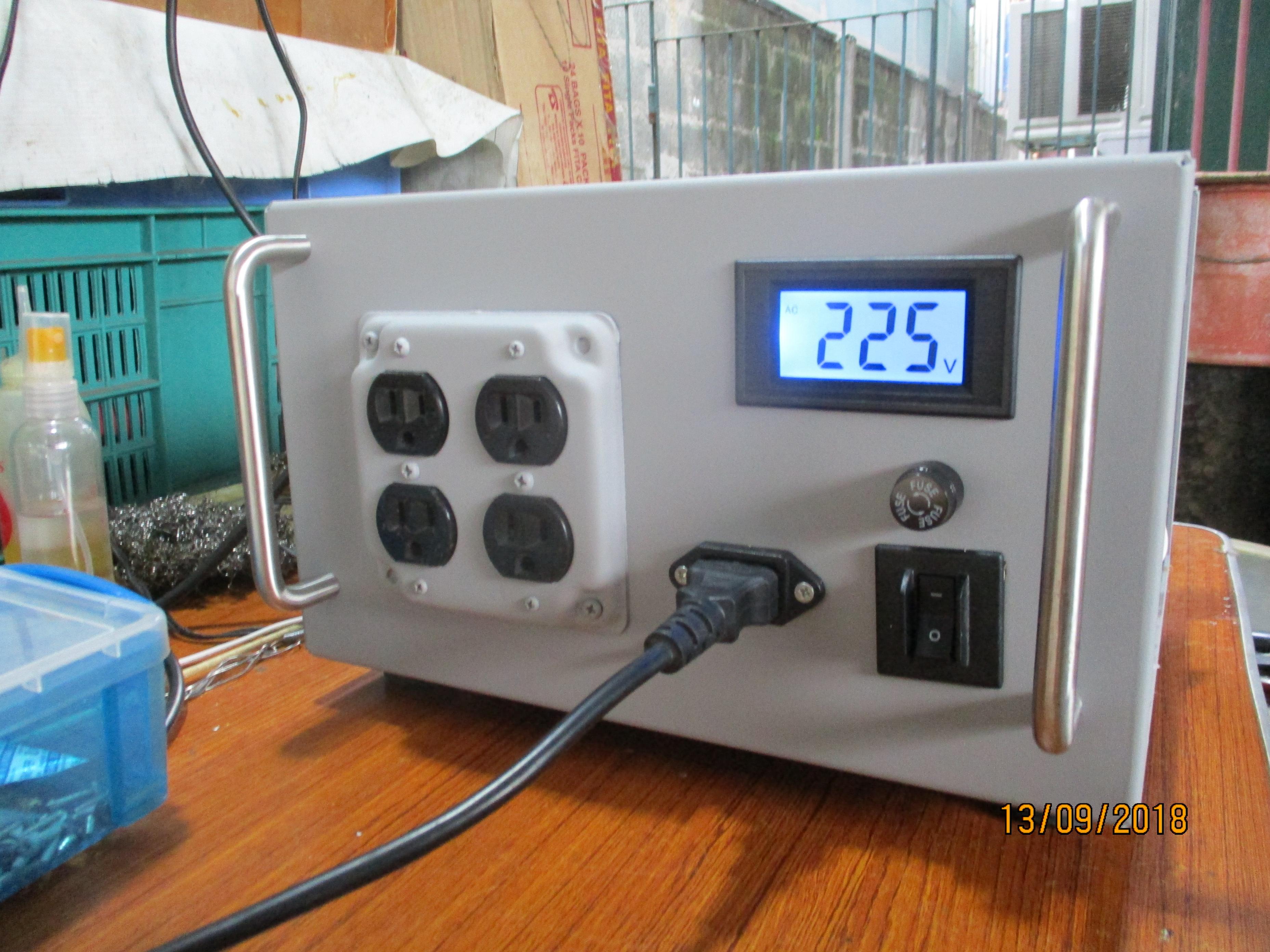

did it three years in a row 2016, 2017, 2018.....
rated at least 1000 volt- amperes,
240 volt primary to 240 volt secondary,
we used them in audio shows at the Dusit Thani Hotel, a downtown hotel...

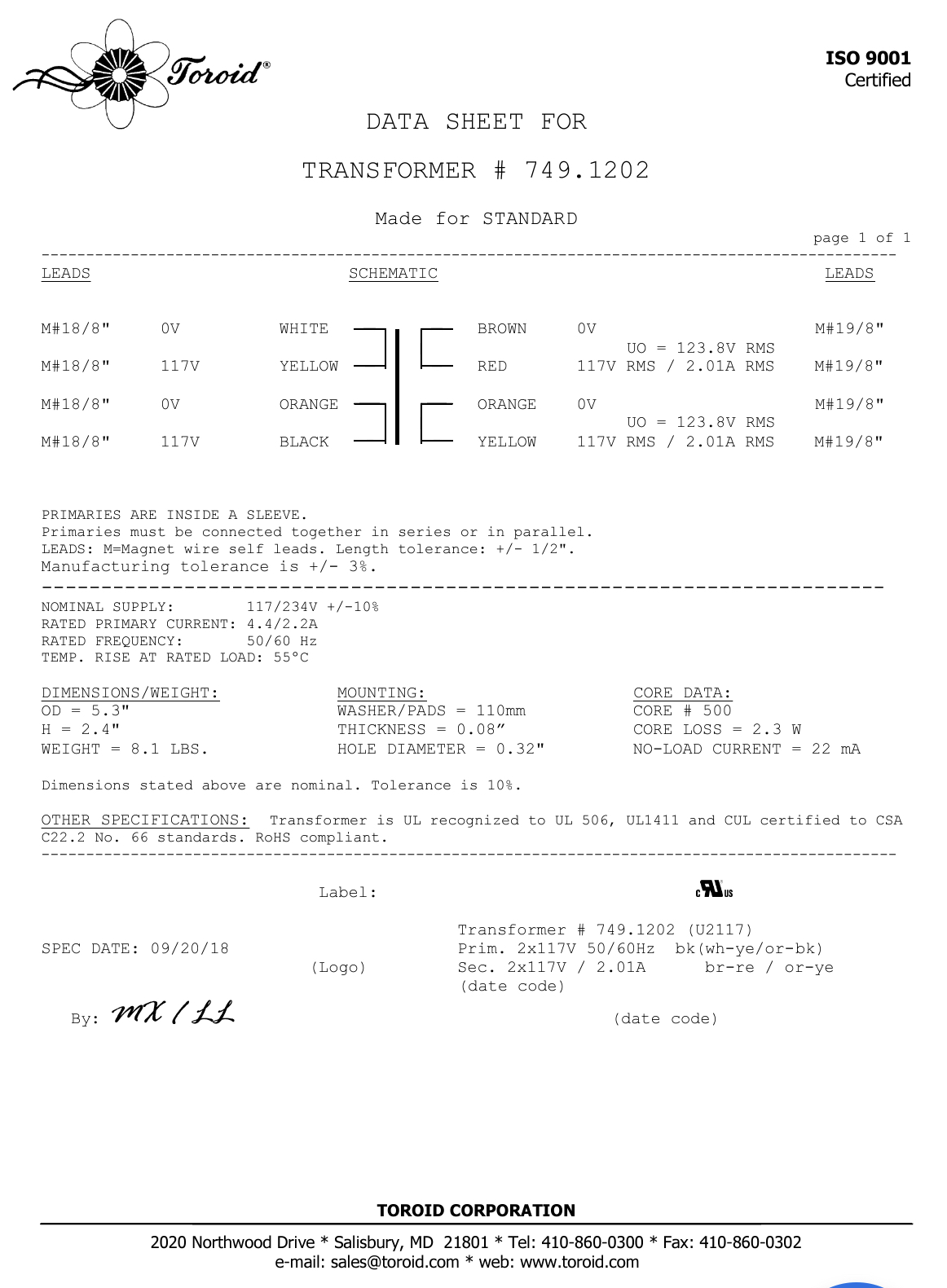

I’ve attached a datasheet for the type of transformer I’m referring to. I read that these will potentially filter out EMI and harmonics that might exist on the line power coming in. This would also be installed internally on an amp build.
