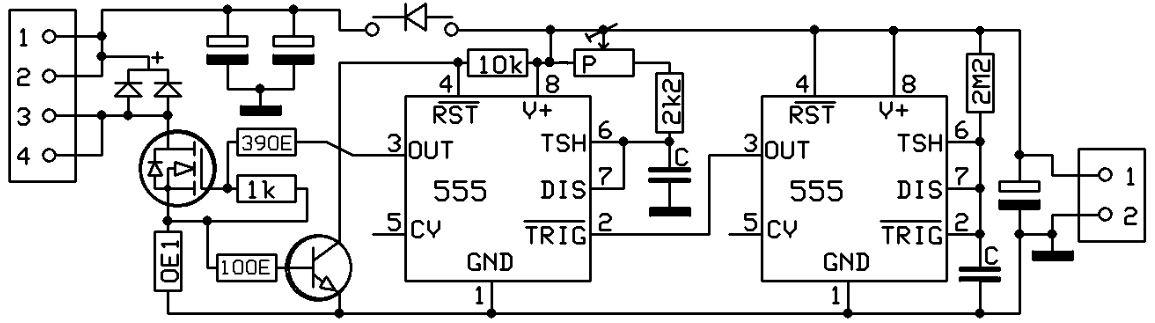

I found this circuit very simple and I ptu it in LTspice to simulate it. It worked as expected, but couldn't show me real inductor saturation as one would get with real inductor.

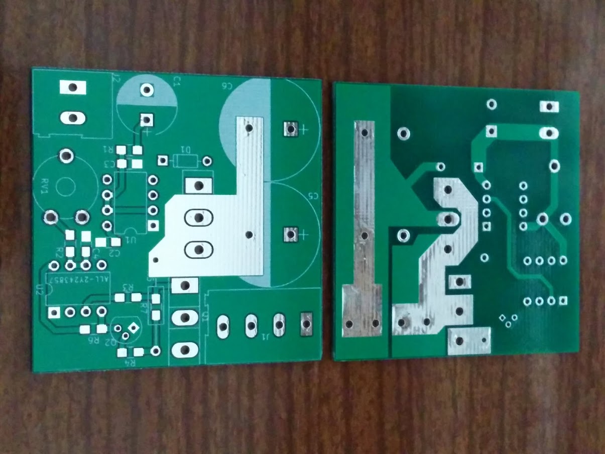

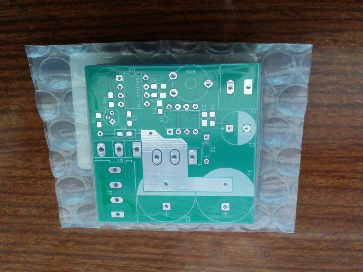

PCBs, I paid for 5, got 6 which is always nice
Top and bottom, pcbs came out perfect

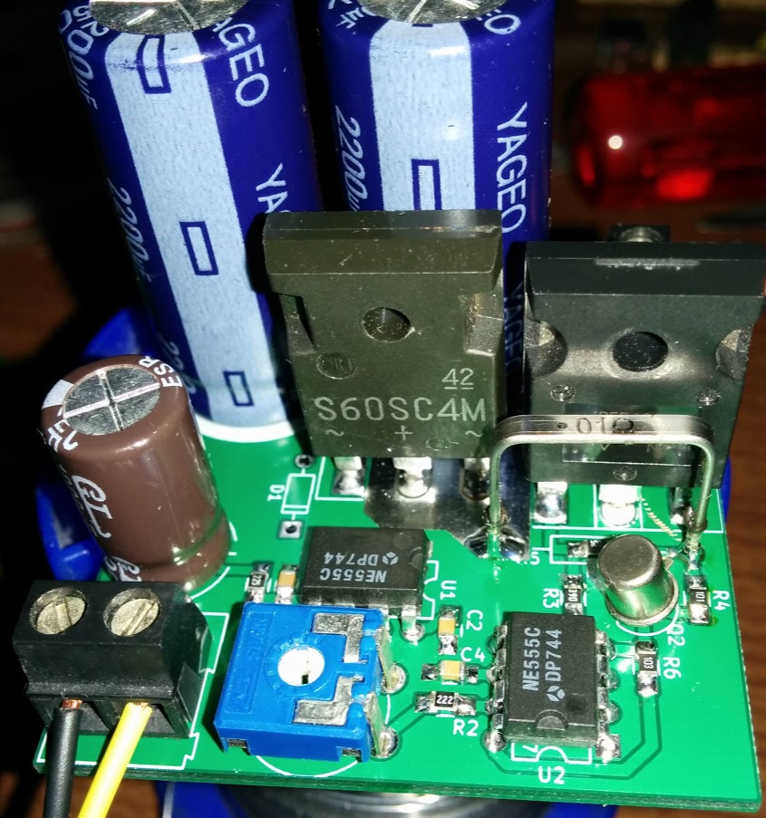

Components mounted
Current in some random inductor from pc supply. Saturation "knee" is around 16-17A.
Since you know the current and you can read out the time it takes to get to that current and you know voltage applied on this inductor, then you can calculated its inductance L with this formula:
L = Vs * Δt / ΔI
I checked this on few inductors, all were calculated just about the same as what LCR meter measured, that is great! And now I also know, when there is saturation and how that point looks like. Different material will behave differently!
Yes, indeed, that was one of the first things we talked about back in the day. That seem to be, to me, very useful, but not at that time, had to figure out many other things before that. But for this one I didn't want to build another pwm generator wit SG or TL, while it would work as well as this, I wanted to build alternative because... well 555s 😛
