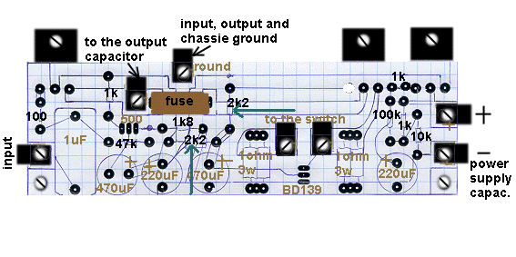

Hello
I'm in the process to give a try to the Power Follower 99C .Unfortunately I don't know how to contact to Andrea .
I do not have his E-mail address .
I have a question
On the schematic there is one 2k2 resistor and one 220R
On the layout there is two 2k2 resistor and no 220R .😕
I dont know which one is correct .Can someone help me lease with these problem .
Thank you very much 🙂
Greets gabor

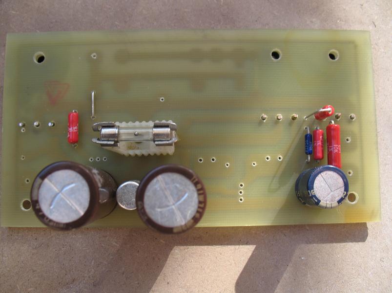

Gaborbela,
Am I seeing that right - the fuse in your photo shows a ball of melted metal in the centre as if it has already 'blown' ?
Anyhow, it looks like a very interesting project. You can probably get all the help you need in this Forum if you have trouble contacting Andy.
As far as I understand, and I have never built with MOSFETs, the 220R resistor is the 'gate stopper' resistor and is included for the main purpose of reducing the likelihood that the FET will break out into oscillations. I think it's a good idea to include this resistor. However, the lower FET in the schematic is a constant current source and the gate is nicely decoupled to ground with a Cerafine capacitor so Andy may have found that the gatestopper is unecessary and you can build it fine without including it.

Hello
Thanks for the help , I wrote to Andrea . I hope He has time to answer to my question .
The fuse is blown it was already in the fuse holder from another project .
These amplifier is not finished yet .
Until I'm not sure the right value of that resistor I do not power up the amplifier .
I do not want to destroy the mosfet or something else .
Greets gabor
I dont know which one is correct ....
Schematic is correct. 220R for MOSFET's gate stopper is the right value. 2k2 is too much in that position but it won't destroy the MOSFET - it will just limit its frequency response a bit more.
Schematic is correct. 220R for MOSFET's gate stopper is the right value. 2k2 is too much in that position but it won't destroy the MOSFET - it will just limit its frequency response a bit more..........
...........and the THD values in direction to higher frequencies
