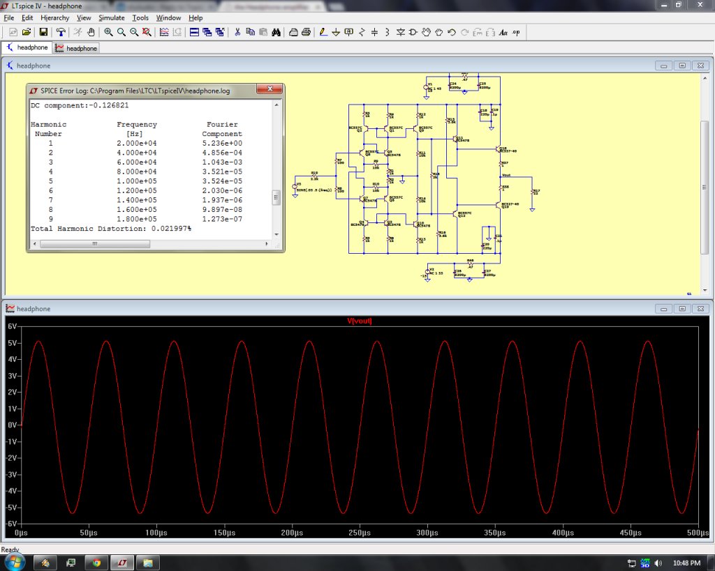

Here some files to produce the pcb and to make some simulations with LTspice.
Follow the first configuration simulated on 8 and 4 ohm load:
Vcc=40V
Ibias=3A
IRFP150
Pd=40 x 3A = 120W
Vin=19Vp => 13.5Vrms
Vout = 18.5Vp -> 13.1Vrms
Rload = 8ohm
THD = 1.5%
Pout=13.1*13.1/8 = 21.5W
Vin=12Vp => 8.5Vrms
Vout = 12Vp -> 8.5Vrms
Rload = 4ohm
THD = 2%
Pout=8.5*8.5/4 = 18W
