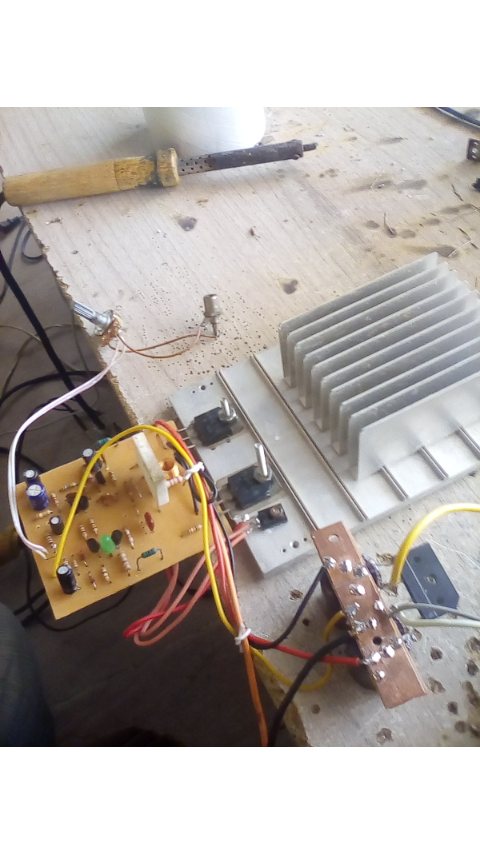

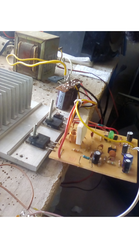

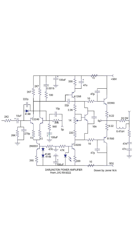

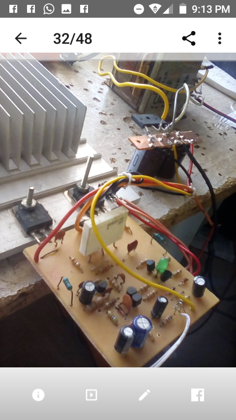

Hello Guys. Several days ago I built a power Amplifier whose schematic diagram I took from a JVC amplifier which I was repairing. The sound is very good and upload some photos of the amplifier and its schematic. Greetings.
