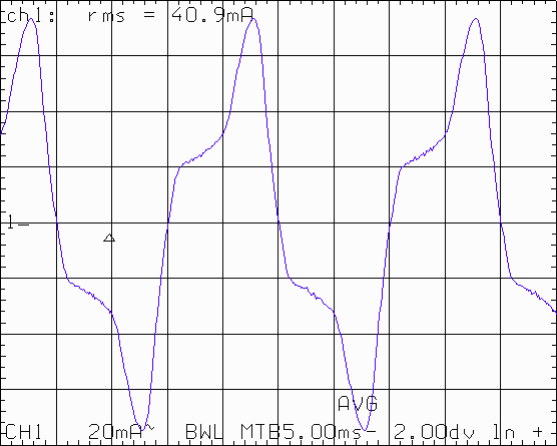

The current consumption varies depending on the supply voltage.
for 230Vac supply ON=36mAac, OFF=35mAac ~8W
for 240Vac supply ON=65mAac, OFF=65mAac ~15W
for 250Vac supply ON=130mAac, OFF=135mAac ~34W
That's some dissipation for a 21.6VA transformer !

But at least in the UK domestic users pay for real power not apparent power, so the question then is how much of that 34VA is real and how much of that is purely reactive?
Most of that 34VA is **NOT** dissipation!
My betting is that only about 10% or so of that is real power, with the rest being reactive.

FWIW a scope pic of a 230V/100VA type, China as well, from a consumer hifi. Test voltage was 250Vac, open secondaries. The transformer was humming audibly at this levels. While basically the idle current is inductive, once the core saturates inductivity decreases, making the current dissipating some real watts in the coil winding resistance while total power is some 10VA. The current peaks are not symmetric to the voltage zero crossings spaced 2 divs apart around the trigger.
Ignoring the iron losses (Not necassarily safe) the interesting question becomes, what is the DC winding resistance of the primary?
The copper losses in the unloaded case can then be approximated by I^2R where I is the rms magnetising current observed.

The transformer is stamped as 230V.
It appears that DAN have selected a 230V transformer that is possibly not a universal 220/240Vac unit to save costs.
When used on UK's 240Vac which can vary from 226Vac to 254Vac, that the transformer has gone into saturation at the upper end of the working voltage range.

Since you're measuring a high idle current with the secondary winding OC then it indicates significant iron loss, and NOT copperloss, and an inefficient core, bad lams etc.

I measured, but forgot to post, the primary resistance. ~ 77r for post27
But that only accounts for the primary copper loss when on no load.
There are the iron losses. These too are real power dissipation.

Is, perhaps a "made for 60hz" transformer running on 50hz instead? That could get hot.
