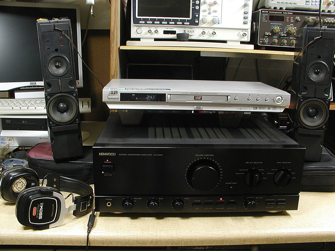

Any amplifier is capable to drive from 4 to 16 Ohm speakers, and no the speakers does not have eyes to see things.
I use currently two wonderful B&O closed cabinet, 2 Way configuration which originally was inside in a B&O TV set of 2000$ worth.
They are 16 Ohm 40 Watt and my KENWOOD KA7020 (2x115 at 8 Ohm) is driving them perfectly at 30% of volume level.
Impedance does not influence sound by a negative way.
