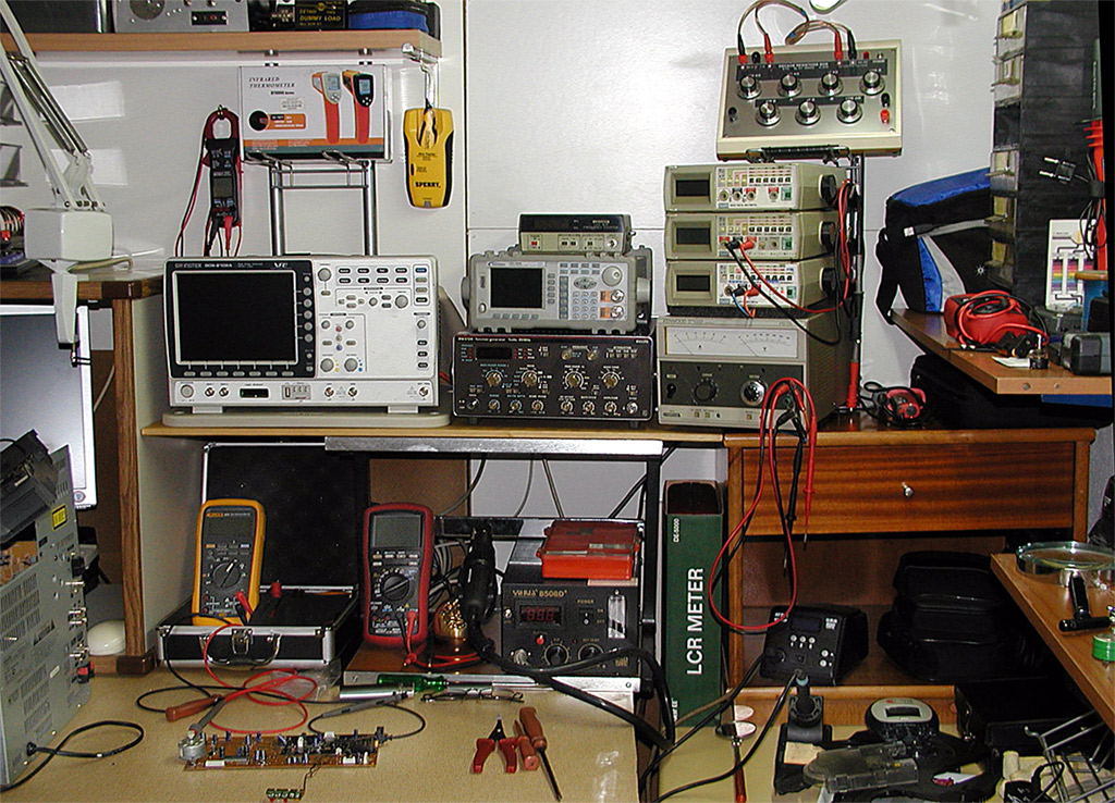

Recently I did some testing to my new differential probe, and in my surprise the power coming from my own UPS were far cleaner than the Mains in the grid.
APC Smart-UPS SUA1000XL | Amazing quality as inverter
Therefore by the use of my Oscilloscope I can verify with out using my ears, if any AC line filter or conditioner has anything positive to offer. 🙂
