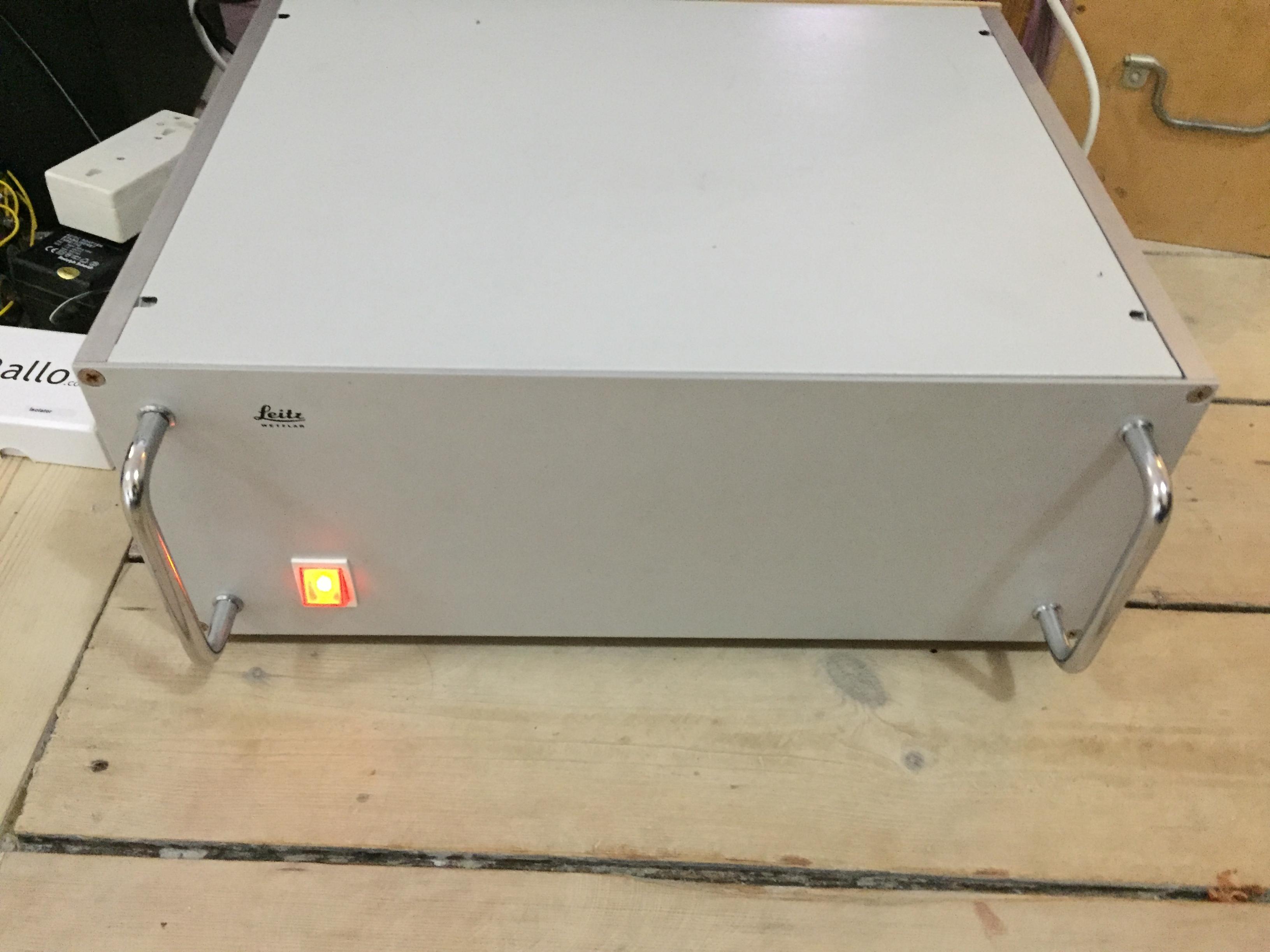

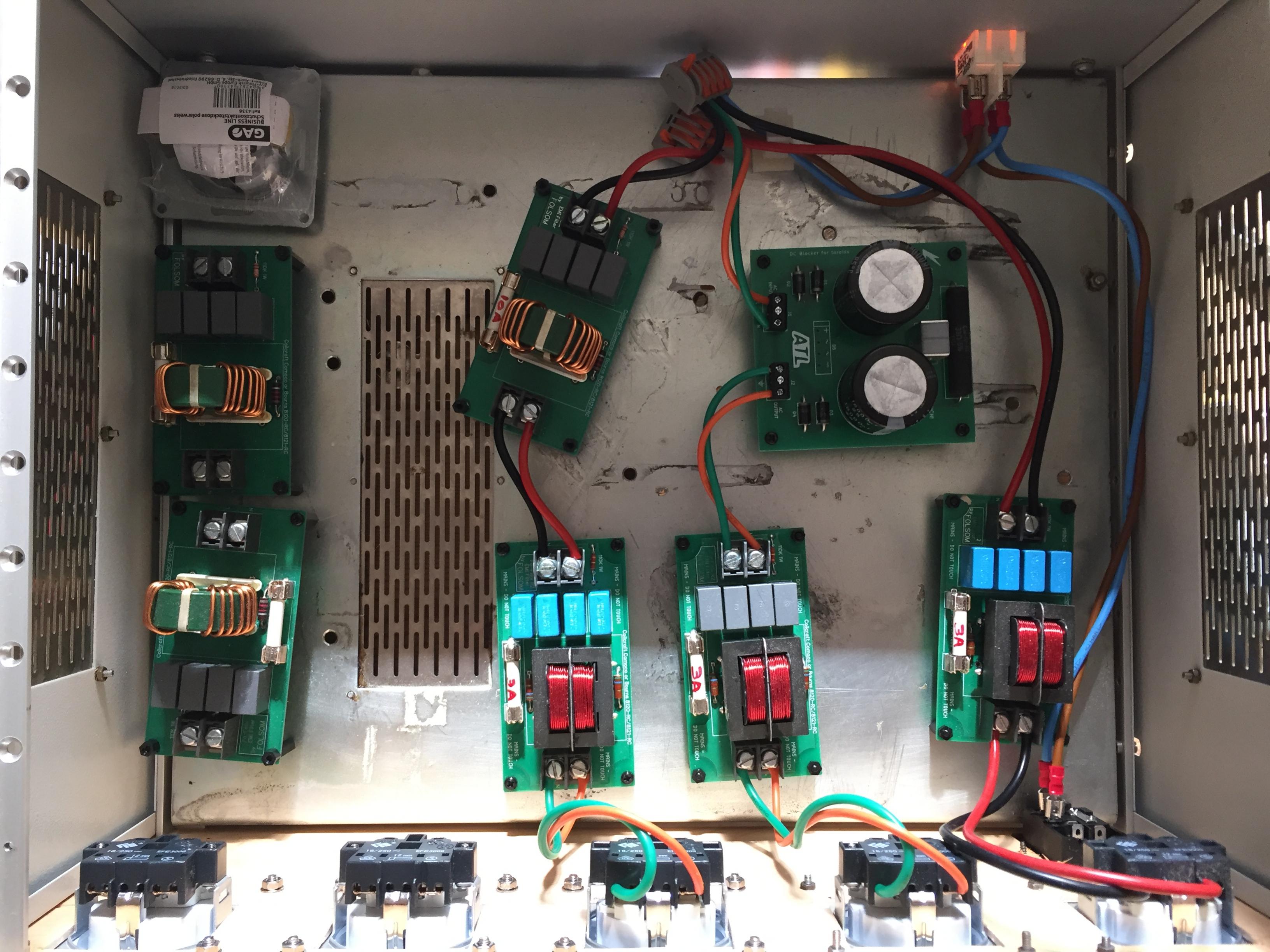

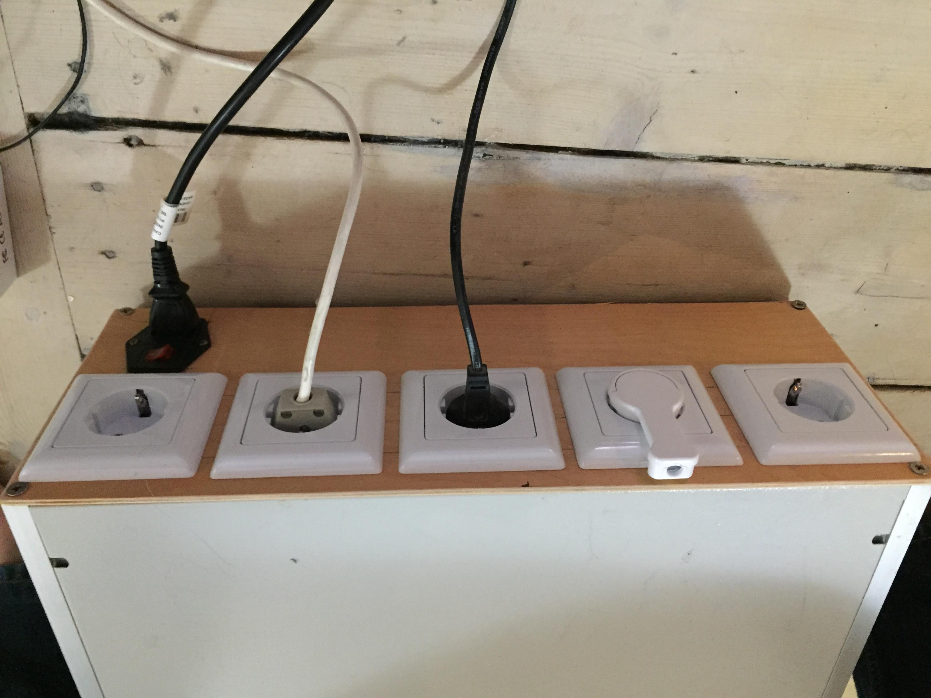

Setup is:
- Surge filter with 4X S20K275 MOV's
- DC-blocker with 2x 16V/100.000µf Epcos in anti-parallel
- - DC-blocker can be bypassed with switch
-- Higher white LED on front will be off when bypassed
- 2x Fo-Felix filter with Bourns CMC8120
-- 2X Fo-Felix with Comoco P3717 -3A
-- 2X Fo-Felix with Comoco Q4007 -5A
-- 2X Fo-Felix with Comoco Q4018 -10A
-Neutrik 32A plug for mains inlet
- 2 white indication LED's on front (Power ON + DC-blocker activated)
Enclosure is made out of black HPL plate.
Top will be made out of 6mm glass.

How did you get the Ben Janssen PCBs? I see a group buy for the Fo-Felix but not for the other boards.
Ah OK, I assumed that the person running the group buy was the designer. I see now that your pcb is not the same as the group buy. Do you have any of these boards available? Would make my power conditioner build a lot easier if i had a surge protector and 6 filter boards!
I don’t have 6 filter pcb’s, I have a couple of surge protector pcb’s.
I can send you the gerber files if you wan’t... send me a pm than.
I certainly do not wan’t to be in conflict with the actual group buys of these filters.
