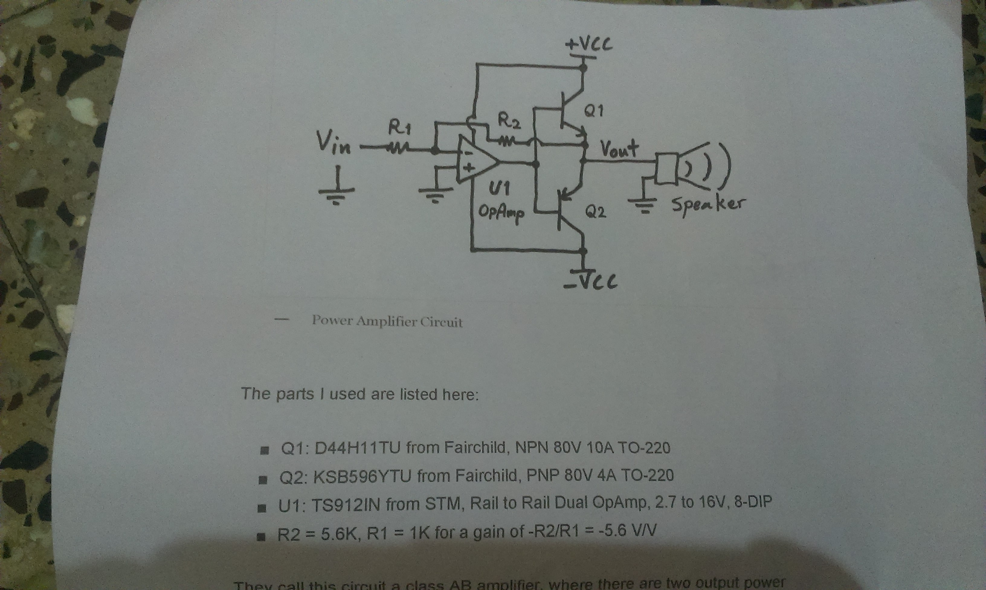

Hi,I am going to make this amplifier but I want to know the wattage of the speaker which is 6 ohm speaker..
+vcc and -vcc is 6v battery.
Vin is audio Jack connected to phone using Signal Generator app on phone.
So I want to know the wattage of 6 ohm speaker..
Please help..
View attachment RSELS08338-1.pdf
View attachment RSELS11220-1.pdf
View attachment CD00000501.pdf.zip
I also attached the main parts datasheets..

You loose say 1V from the Vbe and Opamp, gives 5Vtop on 6Ω.
Current top 5/6 A. For a square wave that is 5 x 5/6 = 4 1/6 W and sine wave half of that.

Theoretical max output power for class-b push-pull is Pa=(V*V)/(8*R)
so if your voltage is +6V / -6V then Pa max = (12*12)/(8*6) = 3 W

The maximum AC output voltage is ~1/3rd of the rail to rail voltage into higher impedance loads.
with a ±6Vdc supply the maximum output will be ~4Vac and more likely around 3.5Vac
Maximum Output Power = Vac²/Rload = 4*4/8 = 2W into 8ohms
or for a 4ohm loading 2.5²/4 = 3W into 4ohms.
