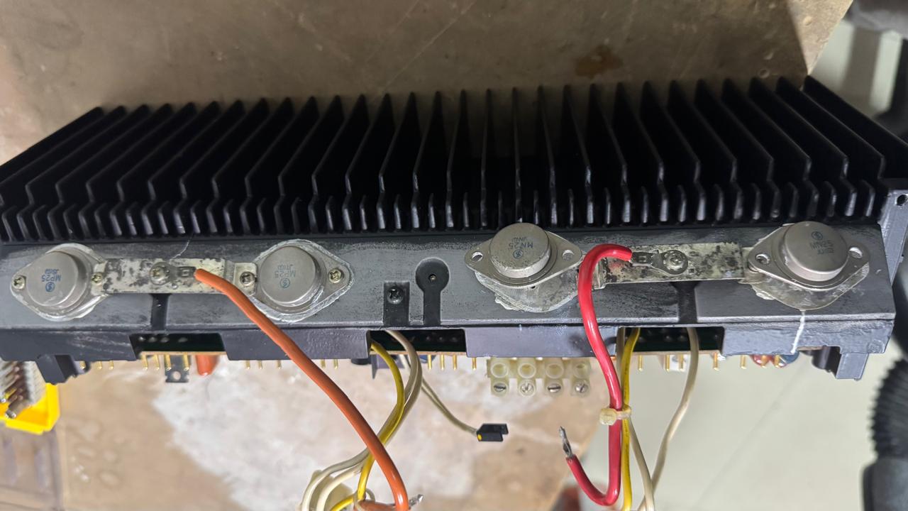

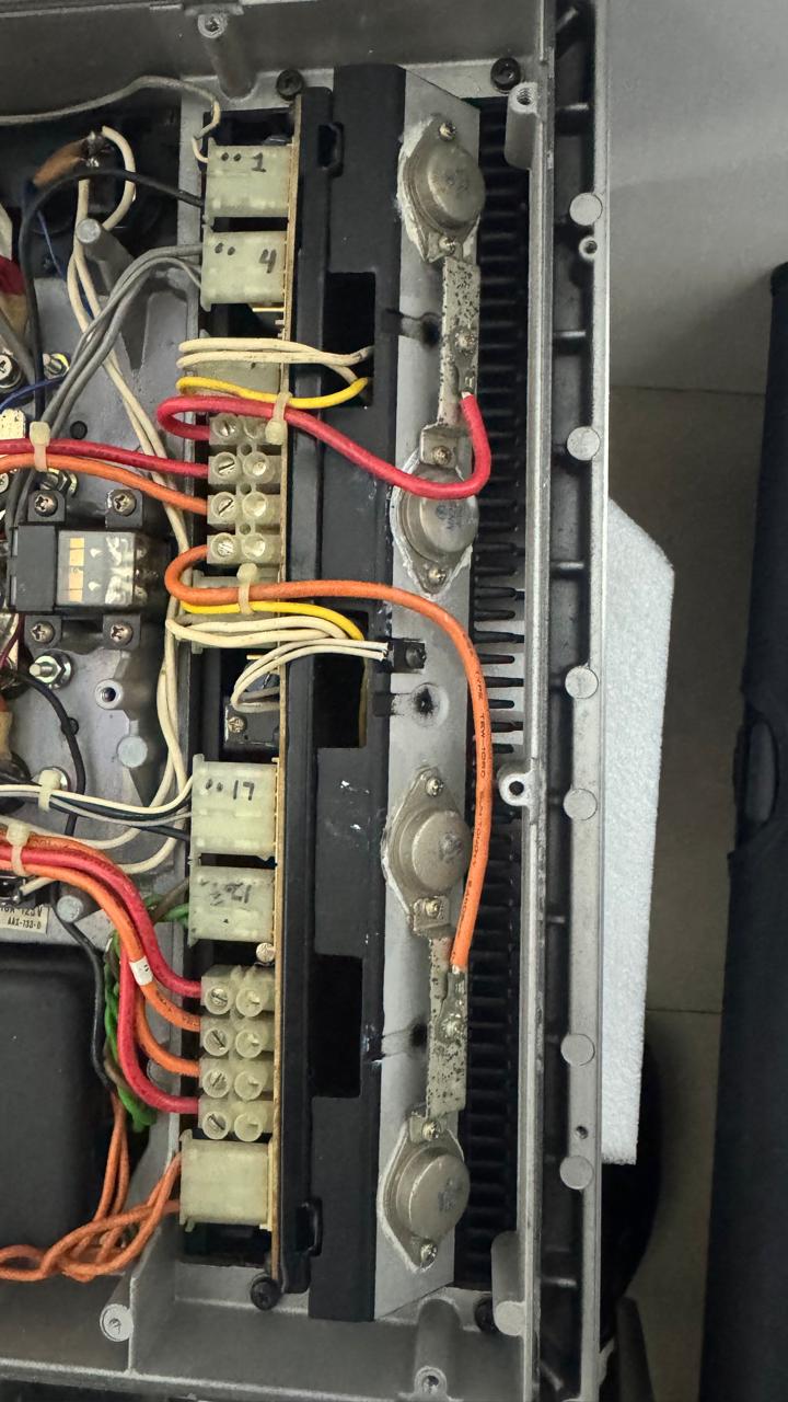

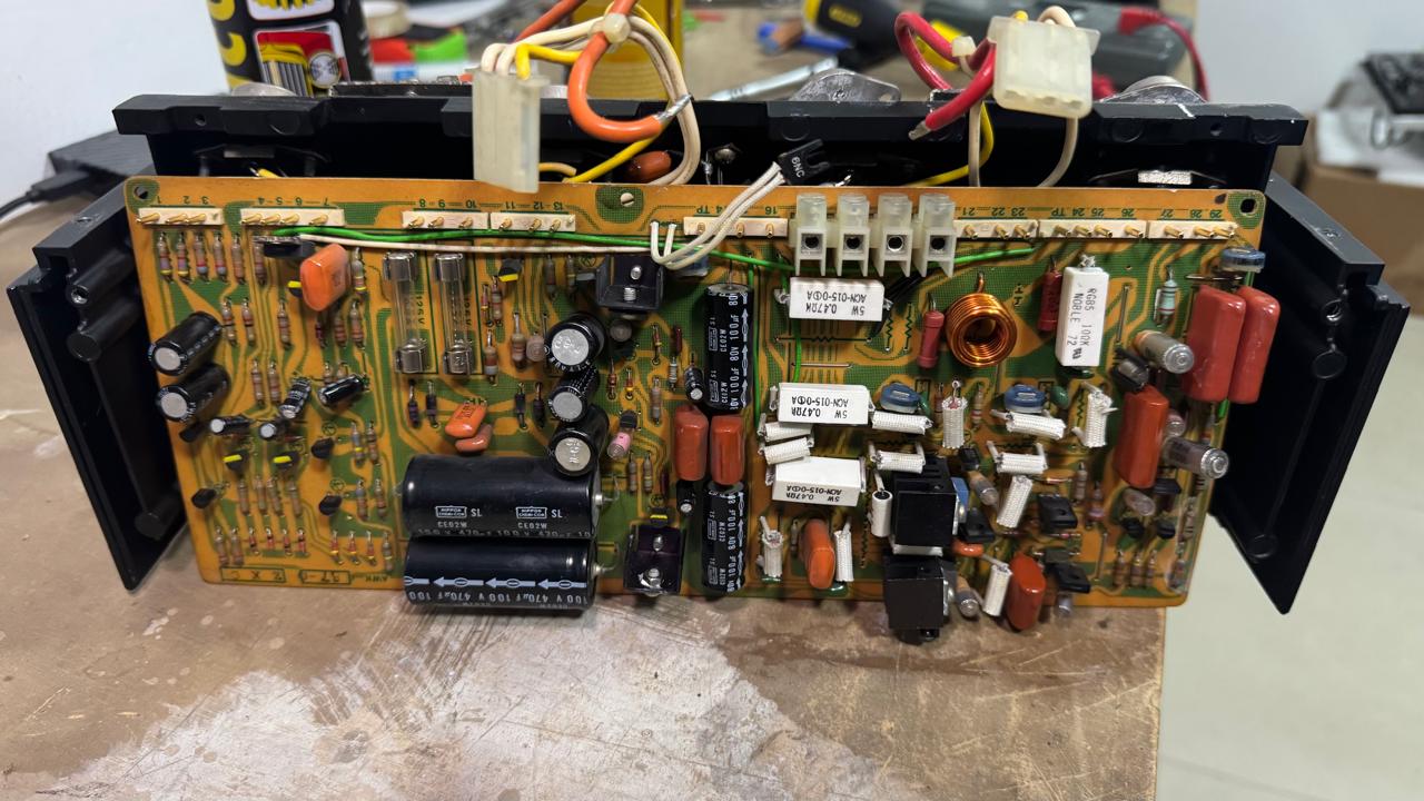

Due to improper installation of my left speaker, the left output burned out. Now I have the problem of not being able to find the MN25 and MP25 germanium transistors, which are internal numbers used only by Pioneer and not a commercial number or model, making them harder to find. Could someone help me with this?

Looks too new to be Germanium outputs. At 120 watts and one pair, really improbable. Mind you, Pioneer wasn't above over-reporting output power either.
What year was it made in? Can you confirm the model number?
Back in the 1970's, a Nikko Alpha II was rated at 120 watts per channel and used the 2SD555 and 2SB600 outputs, one pair of each. Normally at that power you would see 4 outputs per channel. Of course they were silicon, high power transistors.
