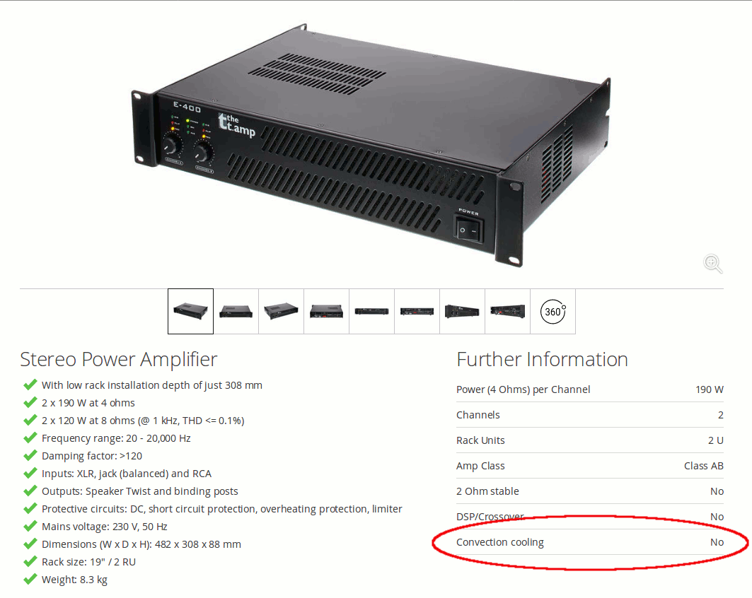

Checking some Power Amps, the one that I like the t.amp E-400 – Thomann Lithuania. Can I find better one than this? Is this thing actually have 190Wrms @ 4ohm?
At about 7:00 I am wondering on the heat sink area if it actually is Class AB, that is unless it has a fan.

Looks like it does use a fan (forced air cooling) - see attached image....unless it has a fan.
-Gnobuddy

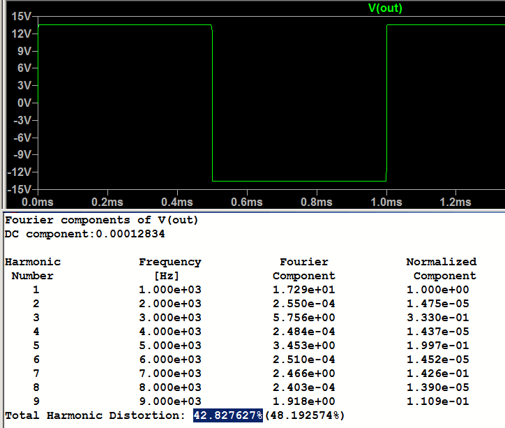

...100% THD (pure square wave)....
Just for our information:
A hard square wave seems to be about 42.827627% THD. (Maybe 42.749279%)
Here's my reasoning for the 100% THD figure:A hard square wave seems to be about 42.827627% THD. (Maybe 42.749279%)

I didn't go 10 harmonics and I'm sure that makes little difference.
The harmonic level falls with order. Even-order should not appear in a square wave.
The un-normalized numbers:
1 = 17.3
3 = 5.7
5 = 3.5
7 = 2.5
rms(5.7+3.5+2.5) is 7.
Ratio 17.3:7 is 0.41
Adding some more harmonics adds the last couple %.

The value of the fundamental of a square wave is not 1.0 but 1.27. That does not cover the discrepancy, but reminds up that wave-smacking is not a simple thing.
And that link contains the sentence "A pure square wave with infinite harmonics has THDF of 48.3%,[1][13][14]..."
The first of those references is available online, and proved to be readable, at least initially; I was able to follow the calculation of THD for a square wave, and it is {square root of ( ((pi^2)/8) - 1 )}, which works out to 48.3%.
So you are correct, and my estimate is badly wrong.
I think I found the mistake I was making: I calculated THD for a square wave and sine wave of the same peak value, visualizing an amp gradually driven from clean into clipping.
But if you take the Fourier series of a square wave, the amplitude of the fundamental is not the same as the amplitude of the square wave...it's bigger! (And so, THD is lower.)
This leads to something I didn't expect at all: if you feed an amplifier a sinewave, and gradually turn up the amplitude till clipping starts, and then push it further into clipping, the amplitude of that fundamental-frequency sinewave continues to increase!
-Gnobuddy
