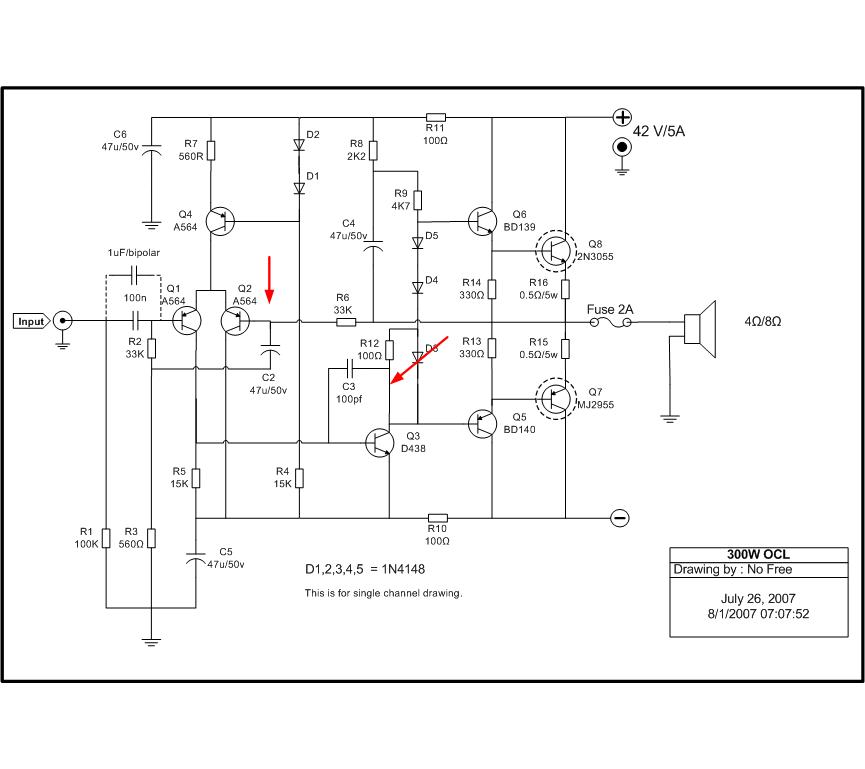

The double bootstrap is interesting, and I have used it myself to see how it worked.
The 560R/1K5 top bootstrap passes 24mA, and the 1K/3K3 passes 11.3mA. The difference is passed to the voltage amplifier, which then has an easier job to do. The benefit is the much higher current which now drives the output stage, giving better slew rate for a low current voltage amp, which dissipates only around 600mW instead of 1.2W. In earlier times very fast, low Cob transistors of high dissipation were difficult to find and rather expensive.
By careful dimensioning of the bootstrap resistors it is possible to roll off the HF response a little earlier, helping with the Bode-Nyquist stability criteria.

Thank you for the excellent description Hugh. Indeed, I can see this happening in a SPICE simulation now that I know what to look 🙂
This looks like a novel topology.
Considering the "glitches" and "ringing" I mentioned earlier; now that I investigated more, this seems to be a phenomenon related to rail sticking that (as far I understand) inherently troubles CCS loaded circuits: In conventional circuit with a single bootstrap (or active CCS) the positive half wave is more susceptible to sticking into rail during clipping while the negative half wave usually can clip without any prominent effect. When the PNP output transistor is equivalently fed by a CCS (as in double bootstrap topology) it will also begin to suffer from this phenomenon. The momentary sticking isn't as noticeable but will create a "glitch" or some ringing.
Well, those are my observations about the topic. My simulation circuits were quite crude and undoubtedly any good designs, where rail sticking effects are minimized anyway, are quite free from this trouble.

R9-C9 results to more negative feedback at higher frequencies, thus limiting the HF gain and increasing stability (if implemented correctly). R2-C2 shunts high frequency signals from voltage amplifier transistor's base to rail, again in order to increase stability.
As an aside, the bootstrap both ways technique would be useful for complementary Mosfet output stages using transistors with high Vgs

Bootstrap (on supply) is enough easy to understand,
if the cap is a Vs/2 charged when the output line go at full positive
supply the driver reach Vsupply+Vs/2 of capacitor and vice-versa.
That means the supply of diver reach a tension greater than main supply.
Nyquist stability criteria is used for determining the stability of the system.
This is a math approach for verify that the system
work without oscillation..

how can I Bridge this power amplifier? I need two identical stanges?
if i can... i will need a inversor circuit???
Yes, two amplifiers are needed and for most parts they should be as similar as possible. It's pretty easy to modify the configuration of the differential input stage so that it makes the other amplifier inverting, thus using additional phase inverter stage can be avoided. In theory the input is just connected to the non-inverting input instead (with a suitable series resistor) and that's it. In practice, the concerned 130W amp circuit should be modified more than this since input and feedback share the same resistor R4. The aforementioned trick will not work in this configuration. Also, there is no series resistor in the input that is essential for equalizing gains of inverting and non-inverting circuits.
I don't know if this circuit can be safely bridged but I would have to guess that no: The input stage as it is, in my opinion, is too simple to be replicated nearly identically in two circuits. Same thing with the bootstrap constant current sources loading the VAS. I think that these should be replaced with some sorts of active configurations that would ensure equal performance despite some component indifferences.

aguantesoda said:Hello, I found this power amplifier in a book; and I want to know a little about it, before make it.
What is R7 - R8 - C8 doing?
What is R13 - R11 - C7 doing?
PD: I write in spanish too, because I dont speak very well in english. Thanks!
In Spanish:
Hola, encontré este amplificador en una revista, y voy a armarlo, pero antes de eso me gustaría aprender un poco acerca de él.
¿Que función cumple R7 - R8 - C8?
¿Que función cumple R13 - R11 - C7?
PD: Perdón por escribir en los dos idiomas, pero no hablo mucho inglés, y por temor a equivocarme y por las dudas lo agrego. Gracias!

daol said:Hi, with +/- 42 volts you have 100 watts/8 ohms, no more.
Yup...I think u right...
Re: Sure...
They are similar, yes.
How it Sounds?
On +/- 42V, 8 ohms you will obtain ~110w
How it Sounds?
Hi,On +/- 42V, 8 ohms you will obtain ~110w
no it won't.
It won't even do 100W into 8r.
I'd guess it might manage 80W into 8r just before clipping.
