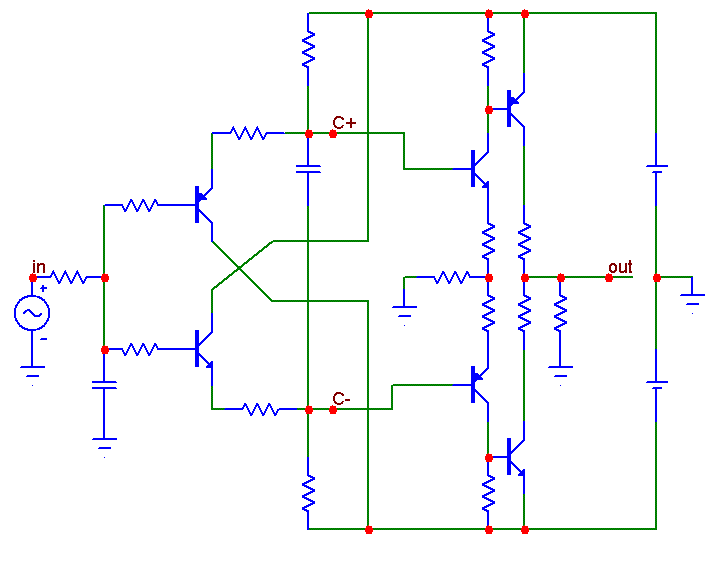

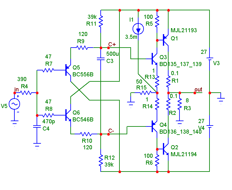

Hi Hugh and Chris,
thank you, I should add that the circuit is just a hint and should be precised into reliable circuit, the most important addition would be the DC offset stabilization.
Hi djk,
thanks for the link, I have not known it. Of course I have not invented the structure, it is based on diamond buffer and basic CFB topology. We must be, however, careful when comparing these circuits. The major difference is current output. Some circuits look similar at first look, but do not work the same way.
Best,
Pavel
Simulated 10kHz square response into 8ohm load looks like this:
