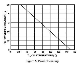

Hi Sam,
Don't worry about the MJE340/ 350's. They are built to take it. Even with a Tc of 80 degC they can still dissipate 11 watts each and the actual dissipation is way below this. So they will run very warm (definition is a personal thing) but they are well inside normal operating parameters. These transistors were originally designed for high voltage TV applications where they often run quite warm indeed.
They are probably the strongest TO-126 device around and at high voltages put seemingly stronger TO-220 devices to shame.
Mine are mounted inside a case that is completely sealed and ventilated by a central slow (very slow) fan. A picture of the case is located early in the thread and also in Solid State Pics.
