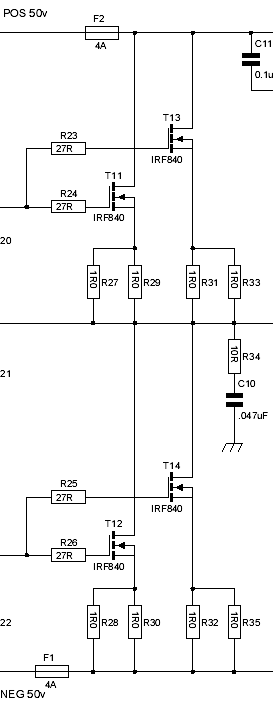

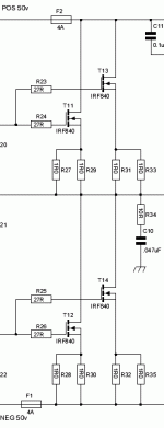

second, matching:
I have atteched a part of the shematic for my NMOS (the To-220 version).
If I understand correctly (that is what I would do), I have to compare the pairs - as the same current should be running throuh both of them.
The first pair would be T11&T12(A) the second pair would be T13&T14(A) - (A) and (B) for the different channels.
Now I would compare T11&T12(A) with T11&T12(B), if there are huge differences in current I swap two fets to combine these with higher Vgs and these with lower Vgs. Am I right???? Same for T13&T14 (A) and (B).

Hello,
Thank you Andrew.
Now, this is what I measured right now. Bias was set to 60mA in total.
Channel A:
T11 - VR=0,8mV, VGS=2,87V
T13 - VR=15,4mV, Vgs 2,86V
T12 - VR=8,6mV, VGS=3,18V
T14 - VR=7,5mV, VGS=3,18V
Cannel B:
T11 - VR=17,7mV, VGS=2,935V
T13 - VR=0,25mV, VGS=2,957V
T12 - VR=11,85mV, VGS=2,975V
T14 - VR=6,68mV, VGS=2,99VV
Well, I think I leave it as it is, the VGS voltages are quite similar.
Any suggestions?
Thanks alot.
Black
Hi Black,
I see that if you add Vgs to Vre you almost get a match across the FET + source resistor. These two voltages should be identical, have a look at the schematic and you'll see why.
I also see that channel A T12&14 are almost equal (only +14%).
Channel B T12&14 are badly in need of re-arranging (+77%).
The other two pair are a disaster, with over 95% of Iq passing through one FET. That's what happens with Vfets and their wide spread of parameters.
I recommend you remove these 6FETS and group them into pairs.
You should aim for Vgs difference <20mV at the same current for each pair, if you can't get close to 20mV just do as best you can with the FETs you have.
Work at low voltage to minimise the heat dissipation causing Tj to rise excessively. Even doing this you will have to try and take the measurements at the same time increment into the test so that each junction is near the same temperature. 10seconds and 8V may get you close enough.
BTW,
Iq=60mA is low for FETs, that's just 30mA each.
Most recommend over 50mA and some say over 100mA.
Borbely says over 100mA each AND about 500mA total.
I have some laterals set at 75mA each and only the the heatsinks prevent me going higher (4pair @ 69Vdc = 41W).
