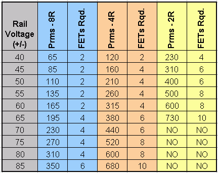

Hi Quasi !
for:
10 FETS - 85V - 8 Ohm = ___RMS??
what is the delivered power ???
regards
(sorry for my poor english !)
for:
regards
