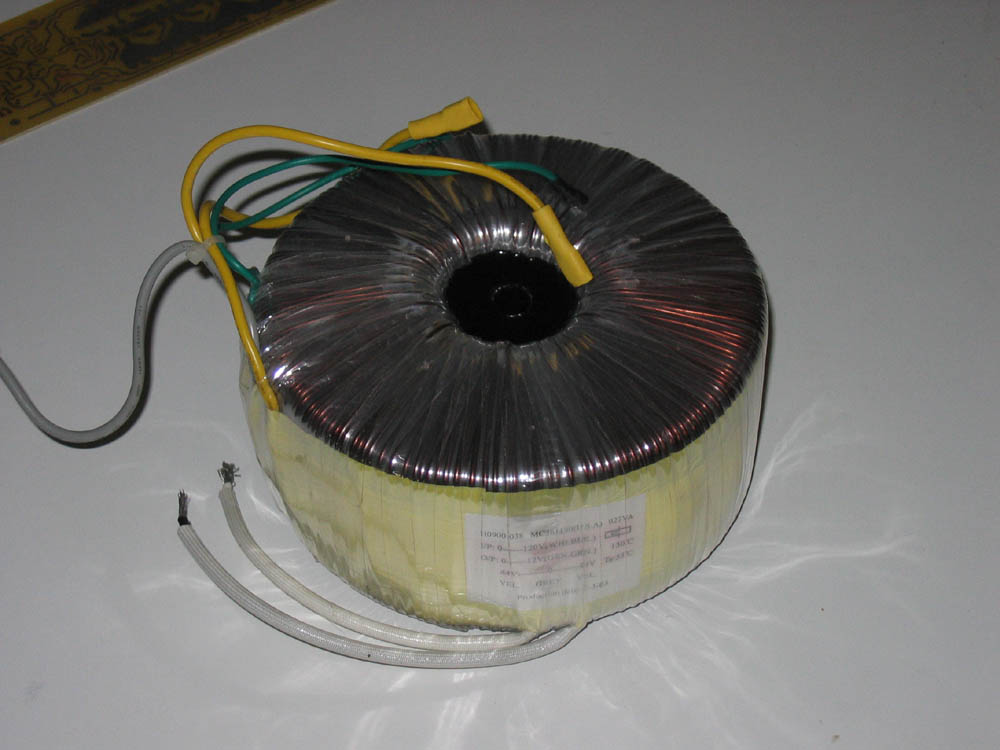

keypunch said:
Shawn, I know the toroids you mentioned.
927VA
Made in the USA
Production date: 3-03-03
Pulled from a "electric warehouse truck" batery charger system
Potted Core
Yup, they are very heavy and headed to Quasi land. I have four pcs. There are new toroids at Active hmmmn...39-0-39 6 amps something loke that, they look good and they stil have some old ILP toroids too.

Shawn,
Correct, the the 40V, 43.5V, and 44V toroids I have are like the one you have in the posted pic. They came from a battery charging system and were potted as you noted. All 4 of yours are 927VA? I discovered by accident some were 1127VA and picked up two of those as well. I thought I pic up one or two more of the 1127, but the last few they had, I was not aware they had no more in warehouse, were a bit rough looking physically and I was not sure about state of toroid so I was waiting for the next few to arrive that never did as they had no more as it turns out.
How many amp modules do you intend to run from one of these 44-0-44V 927VA toroids?
The 39V ones at 6A are not potted and look poorly made and often the wrapping comes off of those 39V 6A ones.
Last time I was at Active there were only a couple ILPs left and they were the 40-0-40 2A ones. I did not want to run a seperate toroid to driver stage so I never picked those up.

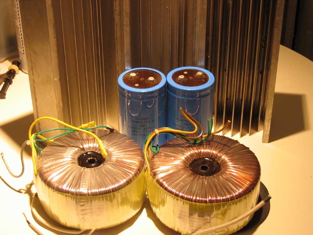

TomWaits said:
Here is some of the stuff, I'm getting closer to Quasi time.
Shawn,
Thanks for the pic of caps and heatsinks with toroids. The caps are what value/voltage? Darn how many of those caps did you get for $40.00? From Sayal as well?
I am going to have to improve my parts hunting skills 🙂
