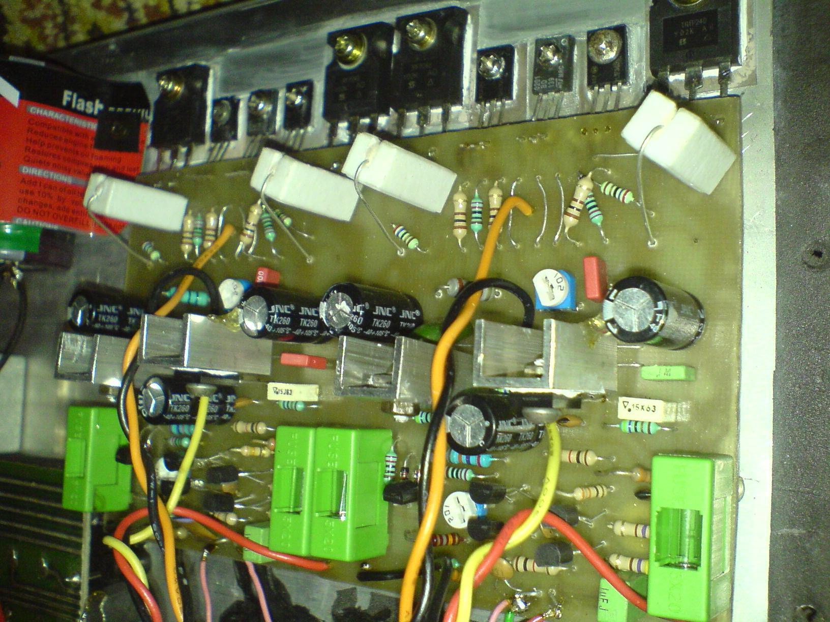

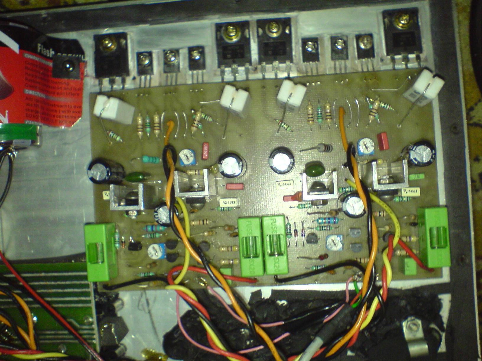

hey quasi and other diy'ers a few month's a go i build NMOS200
i found a thread in a romanian forum posted by alex mm
after browsing the net i found the original tread 😀
WOOOWWW maaan there a over 3600 posts 😱
what can i say this amplifier realy BLOW my speakers
the rails of NMOS200 is +/-32Vcc but the sound is so clear
now i wanna build NMOS350 version whit the rail of +/-85v
thank you Quasi for sharing this nice amp
sorry for my poor english
here some pics

for the output which transistor u use and thermal track transistor.
how do u adjust the bias?
can u share the romanian web u find.
can u share ur pcb layout.
i use irfp240 for output stage and bd139 for termal track
for adjusting bias i use a normal digital ampermeter in series with +v rail
(i know it was better to set bias with 100ohm /5w and 10ohm resistor as quasi sugested in his web site http://sites.google.com/site/quasisdiyaudiosite/home)
first befor powering up i set vr2 cursor to R13 i use a jumper in input
then powering up
i set ampermeter to 250mA and then adjust vr2 to get 50mA
after that adjust offset to les 10mV (i don't known exact value because it was a few month ago)
the amp is still working even whit low v rail of +/-32v
i use it with 8 ohm speakers and sensitivity (1w/1m): 90 dB
and i think i got about of 50w because of low v rail
but it sounds very loud and clear to (i think it's because of the sensitivity of the speaker)

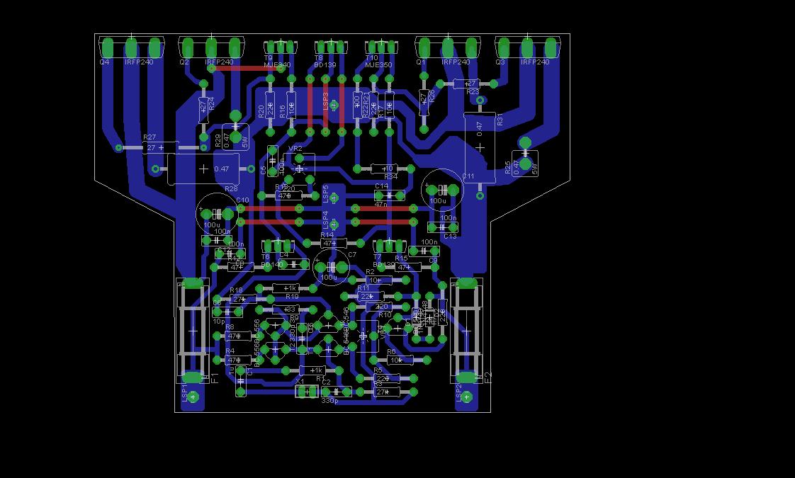

this is the PCB i use
you must open the files with EAGLE
when i print this i forgot to disable the mirror option that's why some resistor apear to cross other resistors
after i did those modifications whit no exageration the board (2xNMOS200 on single board) works for the first time i power up
i use press n' peel metod to create pcb

hey everybody
what do you think about this version of nmos200 pcb whit 2 pairs of irfp?😀
if somebody wants this version of scematic pcb just let me known 🙂
did u check this amp. how many watts and what is transformer voltage?
is your nmos200 transistor getting very hot?
this schematic you see here is the one i use and posted here http://www.diyaudio.com/forums/solid-state/43331-power-amp-under-development-370.html#post2508414 whit one pair irfp
basically is the original nmos200 whit one more pair of irfp
i do not see why this may not work
i think the power whit 2 pairs of irfp is around 80w 8 ohm (i think)
somebody correct me if i'm wrong
the transformer voltage should not exceed +/-50V as quasi said
but if you want to increase rail voltage more then +/-50 you may need to change T1, T5 to 2sc1845 and R7 (10K) to 18K or to be sure check nmos350/500 schematic for modifications
in quasi website one pair output gives 200w into 4ohm.
why your 2 pairs output deliver 80w into 8ohm.
why is low wattage of yous?
+-50Vdc (from a 35+35Vac transformer) limits the maximum output voltage to ~38Vpk with a Source Follower output stage. This gives ~90W into 8r0.why is low wattage of your amplifier?
80W (35.8Vpk) into 8ohm speaker seems very normal for a mosFET amplifier as a continuous maximum rating.
It might be able to give as much as 42Vpk as a transient peak capability, if the duty cycle is low enough.
Why do you think it should be any different?
hey everybody
