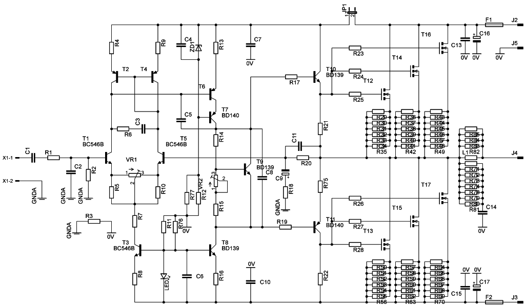

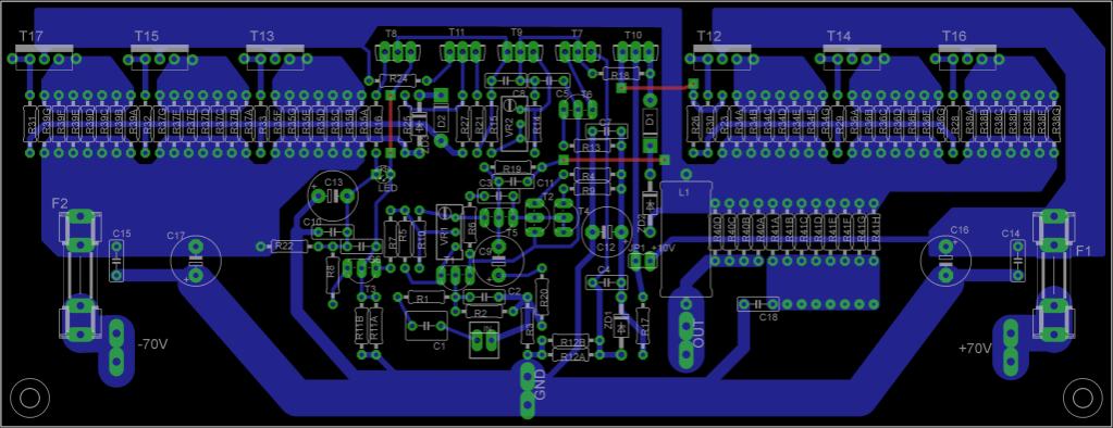

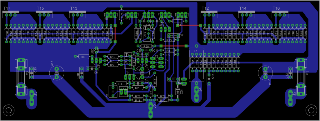

hi qsa,nobody interested
to add supporting 2 Step Class H for NMOS +/- 140 V +/- 70 V
or +/- 40 and +/- 80 V ???
you have done so far regarding nmos,
quasi's design said from german(siemens),design now back to geraman guy
congratulation,
regarding nmos + class h,that would be great,
thumbs up for that
keep up the good work
