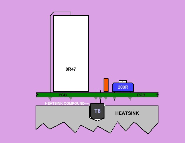

Hi Quasi,
I see you are quite the artist. Having seen your second example of artwork it is clear you are very good at doing technical drawings.
I was not aware you actually placed T8 into a bored hole in the heatsink. A very interesting and thinking outside the box approach for a TO-92 case.
The reason I had asked a while back of using an alternate to BC546 was I was not sure how I would be able to properly secure a TO-92 case thermally. That was why I asked about using a flat case type with a hole such as TO-126 would allow and, at least for me, easier to to ensure a sound thermal mount.
I know many in other threads, discussion venues and projects have bantered about the importance, or not, on the topic of directly mounting the T8 like tracking transitor on top of one of the output drivers or on the heatsink beside/between the output drivers. I am inclined to mount T8 ontop of one of the output drivers. I thought this would be the "safe" approach, hence my desire for a flat form factor with mounting hole for T8, such as a TO-126 like form factor.

Hi duran_1960,
Thank you for your wishes. All the very best to you, your family and friends for the new year.
I'm glad you have found this thread useful. Are you building anything at the moment?

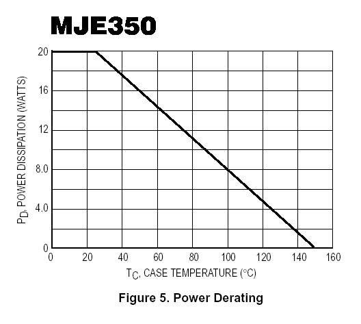

Questions on Some Part Ratings/Values
Hi All,
I been searching parts stores locally here for capacitors and non-output device tranistors mixed in with some research on component functions. I know the parts for this used were largely used from what is available. 😉 I can find most of those parts, but some other parts for basically the same cost are available that may merit consideration. I do not have the stockpile of existing parts other have. So I have the following questions to help me understand ratings or key ratings so I can decide if an alternate may be suitable:
1) What would be the reasonable minimum ratings for Vceo(V), Ic(A), PD(W), and fT(MHz) required relative to PSU voltage (like +Vrail + x, or % of +Vrail) for:
a) T8?
Alternates under consideration are 2SC4495, 2SC3964, 2SD669, BD139, MJE340.
b) T1/T5?
Alternates under consideration are 2SC2240, 2SC2547/6.
c) T2/T3?
Alternate under consideration is BC560.
d) T4?
Alternate under consideration is BC550.
e) T7/T9?
Alternates under consideration are 2SD669, 2SC4883.
f) T6/T10?
Alternates under consideration are 2SB649, 2SA1859.
2) Is C7 an Electrolytic or non-polar? What is the rated working voltage required related to PSU voltage (like +Vrail + x, or % of +Vrail)? Would a Rubycon 120uF electrolytic pose issue in terms of the 120uF value or fact it is a Rubycon? I have read lots of pros/cons to Rubycons and when to or not to use with or without circuit specified bypass cap. So far it is a challenge to find a 63V rated part. The Rubycon is tight fit for PCB that may need to be modified by me to fit. A Nichicon 63uF, 250V cap is available. I am not sure if the 63uF value will pose issues being lower uF or what that may imply using a lower value. For sure I will need to modify the board to enable the Nichicon stubby form factor capacitor to fit. I can still search for the 100uF 63V version, but I thought I mention the options just in case. I am aware of the likley 20%-25% tolerance electrolytic caps have, but I am ignoring that for the purpose of the question.
3) For C2/C3 can I use 470pF? I can buy some 470 pF ERO KP's for this. Or is it better to be a MKT type (whilst trying to skip the passionate discussion of MKT vs MKP)?
4) For C4/C8 is Silver Mica good, great, so so or do not use?
5) I have seen C11/C13 listed as 220uF, then 330uF for the 350W version, listed as 470uF for the 500W version. How does one determine what is best value for these on board supply PSU filtering caps is? I am assuming for the 500W version there was good reason to list as 470uF? I have good access to 330uF, 470uF, 590uF, 680uF and 1000uF. Reading I have done so far is suggestive of values towards 590uF, 680uF or 1000uF independant of power rating of amplifier. The 590uF is a Sprague terminal screw type. The 330uf will fit the existing board layout. I will and can modify the board to handle the larger diameter values. Thoughts here would be helpful.
6) Is C12 supposed to be 0.1uf or 0.068uF? I have seen a board layout a while back indicating a value of 0.1uF, but the schematic shows 0.068uF. The current board layout does not list the value for C12. Is not the issue for me if the value is on the layout, just which value should be use and/or what reason to use one or other value.
7) Regarding C1, I can use a MKT ERO 2.2uF 10%, or a MaxCap 1.0uF Polypropylene 5%, ERO MKP 0.68uF 10%, Rifa 0.68uF 5% or a yellow tubular 1.48 MKP 2% with logo that has a small triangle just above fitting notch of a retangle. Of course the design specifies 1uF. I cannot find any info on the MaxCap, so I am not sure if it is worth using nor if 24K plated leads implies good quality. Anyone know anything about MaxCap's? I am torn between using the MKT ERO 2.2uF, 1.48MKP and MaxCap. I am weakly inclined to use the ERO MKT for a known level of behaviour despite it being a 2.2uF. It seems 1.0uF and 2.2uF are common values used for the input coupling capacitor. Thoughts and any idea what the 1.48MKP maker is as it is a 2% tolerance using G on rating markings?

Hi John,
I have attached the schematic again, this time with key current flows shown. This will allow you to calculate voltages for key components and with the current flow information, help to select components.
Example 1: the maximum voltage across T8 will be 12.5mA x 717 ohms (sum of R13, VR2 & R14) = 8.9 volts.
Example 2: The approx voltage across T1 / T5 = positive rail voltage - v(R4) - v(T2). with 70 volt rails this works out to be; 70 - 0.6 - 1.2 = 68.2v.
Example 3: The approx voltage across T4 = negative rail voltage - v(R7) - v(R6). With 70 volt rails this works out to be 70 - 0.6 - 46.8 = 22.6v. By changing R6 the voltage across T4 can be varied.
Have a go if you like at working out the other voltages.
2. I used a polarised electrolytic (I can hear the screams from other members as I type). You can use a non-polarised one if you like but because the DC voltage here is 0v (or should be) a polarised electrolytic can be used. 120uF or near value is fine, though the bass roll-off will be affected slightly. I don't subscribe to sonic differences between capacitor brands (is that more screams I hear?) just make sure it's a well known quality brand (rubycon, philips, nichicon etc.)
3. Yes ok.
4. I used a ceramic (more screams). Silver mica is ok.
5. Use anything up to say 1,000 uF, it doesn't really matter. The main job of this capacitor is to shunt broad spectrum ripple developed by heavy currents flowing through local tracks and the fuse. More is better here with diminishing returns though I doubt you will hear the difference between the 330uF and the 590uF. Do not however omit the 0.1 uF polyester / MKT bypass capacitors.
6. This is a basic filter to stop RF entering the amp from long speaker leads. It also provides a high frequency load to quench any oscillations (that shouldn't be there in the first place). It doesn't really matter so select what you have on hand, just make sure its rated to at least the rail to rail voltage.
7. You can use anything you want here of the polyester / MKT variety over 1uF up to about 4.7uF if you can get it to fit. Only use a non-polarised capacitor here to provide protection against faulty connected pre-amp. Tolerance matters diddly here.
Of course comments from other members is welcome, I suspect there will be a few.
Cheers
