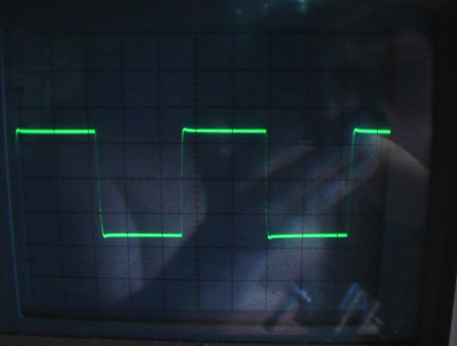

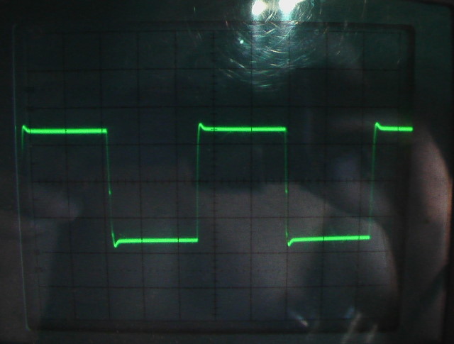

NMOS200 in practice
In practice it doesn't perform OK at all ! You are right about that the upper top clips slightly before the negative without R21.
But when you use 100 ohm as R21 the negative top clips way before the positive. And what an ugly clipping
Strays and ghosts around the negative clipping area.
There is also another issue using this R21. All the same in practice as in the simulator. It's most obvious if you have a square testsignal and look at the scope. If you use 100 ohm as R21 you get that nasty crossover distorsion when the signal goes from positive to negative. I raised the quisent current to 135mA without getting better result.
Today I lowered the resistor to 50 ohm. Now the nasty crossover remainder dissapeared with 135mA quisent current trough the emitter resistors R29 and R30. The clipping is symetrical but still flippering and ghostings around the negative clipping area.
Guess what next? I took away R21 and shorted it. Slightly positive clipping before negative but really good looking. The nasty crossower distorsion dissapear totally above 50mA quisent current!
I must say that the signal looks all clean up to more then 200kHz. I haven't tested the bandwith yet. 10 and 20kHz squarewaves look impressive. This amp seems to be of very good quality. My tests clearly shows that you have to short out R21 though.
I will also do some computer based distortion tests later on with my audiophile USB card and more exiting, listening tests 😀. I hope I'll be back here again next week or so.
I use an + - 40 volt PSU (under load)
You mean that I could have done something wrong? I don't think so 😉 It turned out the simulation wasn't that bad 😎

Hi Quasi
You didn't read my post very well 😉
The results are first hand tests on the allready built modules.
They differ slightly from the simulation. But the simulation opened my eyes for a potential problem, that also showed up in the real module.
In the real module it's only visible on the scope if you use squarewave and looking for the thin drawing when the signal switches from positive to negative. There is a jagged crossoverproblem visible. Use some more intensity on the scope.
This crossover distorsion only goes away if I dissmiss the R21 or use very high quisent current and 47 ohm as R21.
I use 8 ohm in both the simulation and on the real stuff.

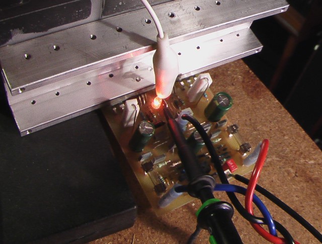

A Pal opposite side of the globe
Cheers mate, how's it going down there? (Did it sound like Paul Hogan?)
In a couple of month's we will have summer here, and you? Tipping over to the winter season maybe? Maybe you don't have any snow any time of the year where you live? I am not that good on the climate in australia. I just know that you have Santa and Christmas when it's the hottest period of the year 🙂
Offcource I will do the test. I don't have much friends you see ... 😀
A constant voltage about 2 volt would be a test to consider. I see your point.
I propose an amber LED for the ~20mA current trough the drivers (~1.9V). Whatyathink?
I will test this very evening as soon as I have finished my red wine

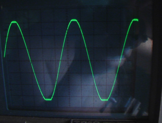

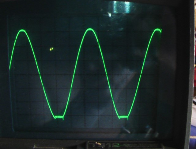

Some breathtaking news
Woahaha
Here I'm having fun and you'r asleep Quasi.
First hand test with these so "o' so amber lighting" yellow LED'S.
Test reveals 1.845V across LED and guess what.... ?
Apparently, Quasi have gathered some good knowledge as being around with these similar FET designs along time now.
I was astonished, Quasi, that you predicted something like this that well
The result is is perfectly nice looking clipping and also symetrical (8 ohm tested so far). And what's more, no nasty crossover distorsion whatsoever, even down to a quiasent current around 25mA. But no less is accepted, or you get some other fenomenon on the scope picture. This is the best so far 😀
A sidewalk of this thread, because I'm happy. A good enthusiast will be glad to read 😱
I am really happy to be building this amp, Quasis amp, and also contribute to it's eventually impovement. I havent even guessed before I started. Thats the happines of life. You never know...
Everything allways seems to be solved. But what do you know, even after several hundreds of replys to a mailthread here in such a large community, there's allways things to tamper. And guess what..?
98% talks, 2% builds and 0.5% have such knowledge to build this amp right of. 70% of that builders succeeds and never ask for anything more.
The rest is like me. I build because it was easy and cheap ( I had the goods) and I have built several other electronic projects before. But I never accept anything as obvious . I'm sorry but thats the working day for me as an employed. I am a technichian to solve maintenance problems. Different everyday....
And also, In this "ampdesignthread" I learn along the way to my "all cheap thermaltrak amp" that I'm about to design. I have lately done some extensive reading and "upped" my slightly rusty knowledge and also ordered some reference litterature on the subject so... My "All DIY peoples thermaltrak amp" will take it's time to evolve. All in the glory of the fun to explore.

Radioman62 said:Hi Quasi
As an FYI quasi's square wave results for 1KHz and 10KHz.

NMOS200 Scope pictures
My NMOS200 with 100 ohm R21. An ugly assymetric clipping.
Same module lower signal and squarewave 10kHz. Here you also see crossover distortion artifacts, from positive to negative going.
My NMOS200 with R21 exchanged with Yellow LED (1.9V)
Much better clipping. Near symetrical
Same module and the 10khz Squarewave. Also less overshoot. Original signal from functiongenerator not shown here but was almost perfect (slightly undercompensated)
Nearly no sign of crossover.

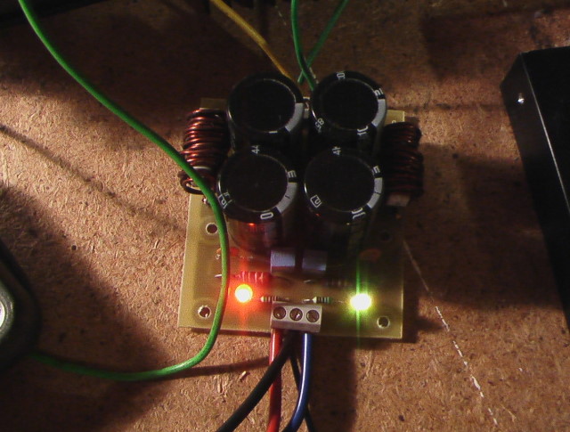

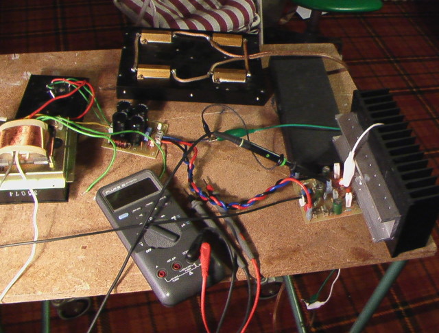

NMOS200 D.U.T.
Some testpictures from the above session.
The PSU is from Nordic's (on this forum) PCB layout. He is helping Carlos with the on going DX amp projects, as you may all have watched growing.
I'll come back tomorrow with distortion numbers. This forum is lagging severly this evening
