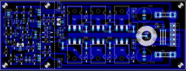

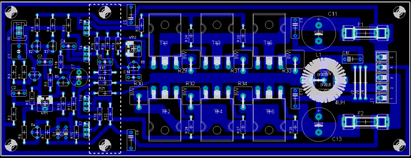

jethari said:
Hi Quasi, Key and everybody else,
Here's another version of my pcb design. I've managed to get the board width down to 4.05 inches. Take a look at it and tell me what you feel about it.
Hari
Hi Hari,
I have the following comments:
1) The track side copyright is now out of the board area. If you rotate the text 90 degrees and place is in the space between V POS and PCB edge there is likely enough space to do so.
2) The space between C7B and T7 is very very tight. I think it presents two issues. The first is the ability to access T7 so you can use a screw to attached it to a heatsink T6 and T7 will share. Second is thermal considerations. T6 and T7 will run very warm, which is a given, but that heat is going to radiate very much so to C7B and possibly cause C7B to fail in short time.
3) L1 and R35 should share the same point of connection, not around and about the trace as it is now. I would move L1 and the associated output pad to the space above C13 as the space above C11 and C13 look to be same.
4) T8 is not centered again, close, but not centered as I believe you once had centered in last PCB.
5) R23 is a smaller footprint than R24/R26/R27 are.
Did you want to include the Leach Feedforward NFB option to your PCB design?
I think I am forgetting a point or two, but all I can recall right now.

it's a pity V+ & V- are so far apart and also so remote from power ground.
I think these should form a tight loop.
Do you realise you can eliminate that link above T5?
Take the middle pin trace up, then left, then between the cap pins.
Take the left pin trace down and then right, then to the pot. It's also a shorter route.

John
Thanks for the quick and concise observations.
1. I missed the copyright part. That will be shifted into the board.
2. I'm shifting C7B away from the transistor, more to the left and also little down.
3. You're right, I can very well shift L1 to the right side, the space available is the same.
4. Centering T8 is not an issue - there's a lot of space there.
5. R23 has the correct footprint for the given value. I've used larger footprints for the other three just to get across the large tracks/lands.
As for the Leach feedforward, I think I'll skip it for the time being. Maybe in a subsequent build I might just include it.
Thanks again
Hari
Andrew
Thanks. You're dead right there, never looked at it that way:smash:
I've already done the changes, will be posting the updated version soon.
Cheers
Hari

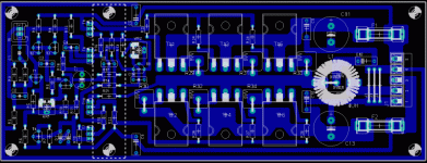

I'm finished drawing Nmos350. And change place between T9 & T6. No have jumper, If it's Ok I will make PCB. Can you help me find mistake.
Thank you very much.
But where is the NFB tapped off from?
There is a trace that runs from the output ground all the way along the bottom and up the left side picking up a resistor and then to the top and along the top to another cap.
What is that trace? What resistor is that ? What are those caps?
