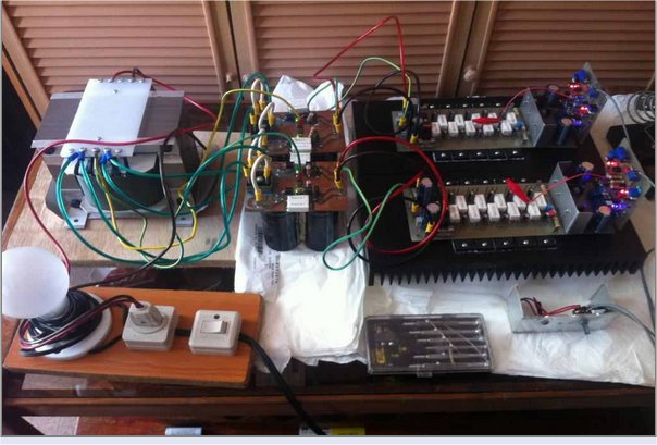

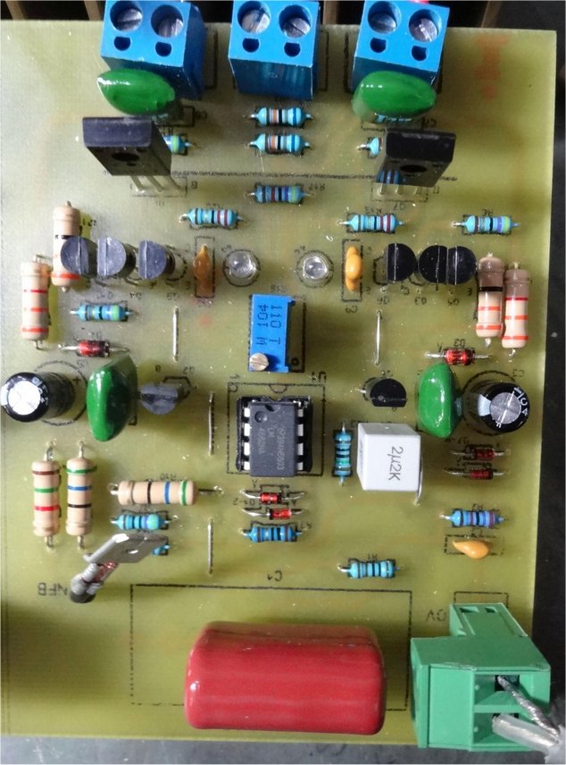

You all missed the latest , greatest Alexander based amp.
http://www.diyaudio.com/forums/solid-state/248105-slewmaster-cfa-vs-vfa-rumble-99.html#post4110623
Member still4given built it without trying different op-amps and getting the
current right - he finally got the current right in a later post and was pleased.
another member (Thimios) built it and tested it , even.
http://www.diyaudio.com/forums/solid-state/248105-slewmaster-cfa-vs-vfa-rumble-144.html#post4326318
They run it with the "no BS" 300W slewmaster. (below)
Apex audio has the A9 amp that also uses this topology.
Don't bother with those 20th century designs or Rod Elliot 20'th century assessment.
Eyesee and apex A9 work at overload , any op-amp , and output stage.
This design has been "aced" !
Edit - hard to find with such a long thread , but (below 2) is the perfect Alexander IPS.
OS
