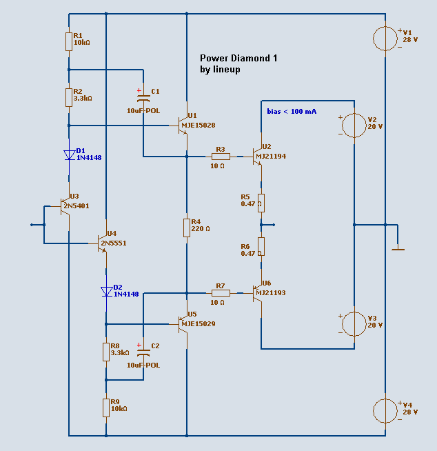

Here is another output stage.
Power Diamond
Uses 2 driver stages + Output, just like in your Follower.
By adjusting R1, R2, R8, R9 we can set the idle bias like 50-100 mA.
D1, D2 should be placed in contact with main heatsink, for thermal tracking.
MJE15028, MJE15029 drivers should have separate heatsink.
With the bootstrapping C1, C2 capacitors
and the regulated +-28 Volt supply for driver stages,
this output has very low distortion.

More than 40dB at 20kHz with single-pole compenstaion means certain oscillation problem. You could squeeze around 60dB of problem-free feedback using two-pole, but 78dB is way of the range.
Your amplifier roll-off OLG only with the help of internal parasitic capacitance ... not good IMHO.
Any folded cascode stage need some sort of load to ground (lag) compensation
