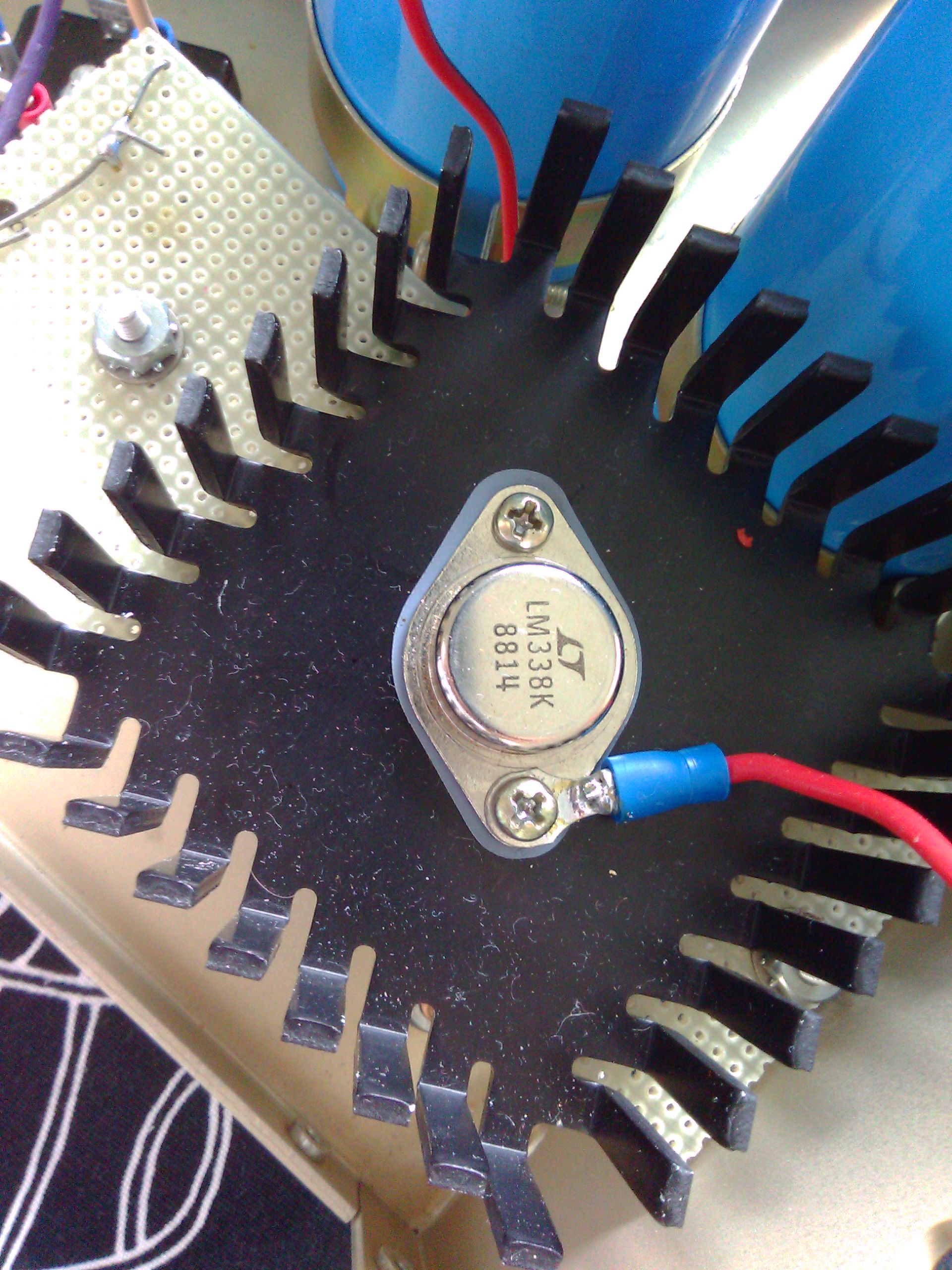

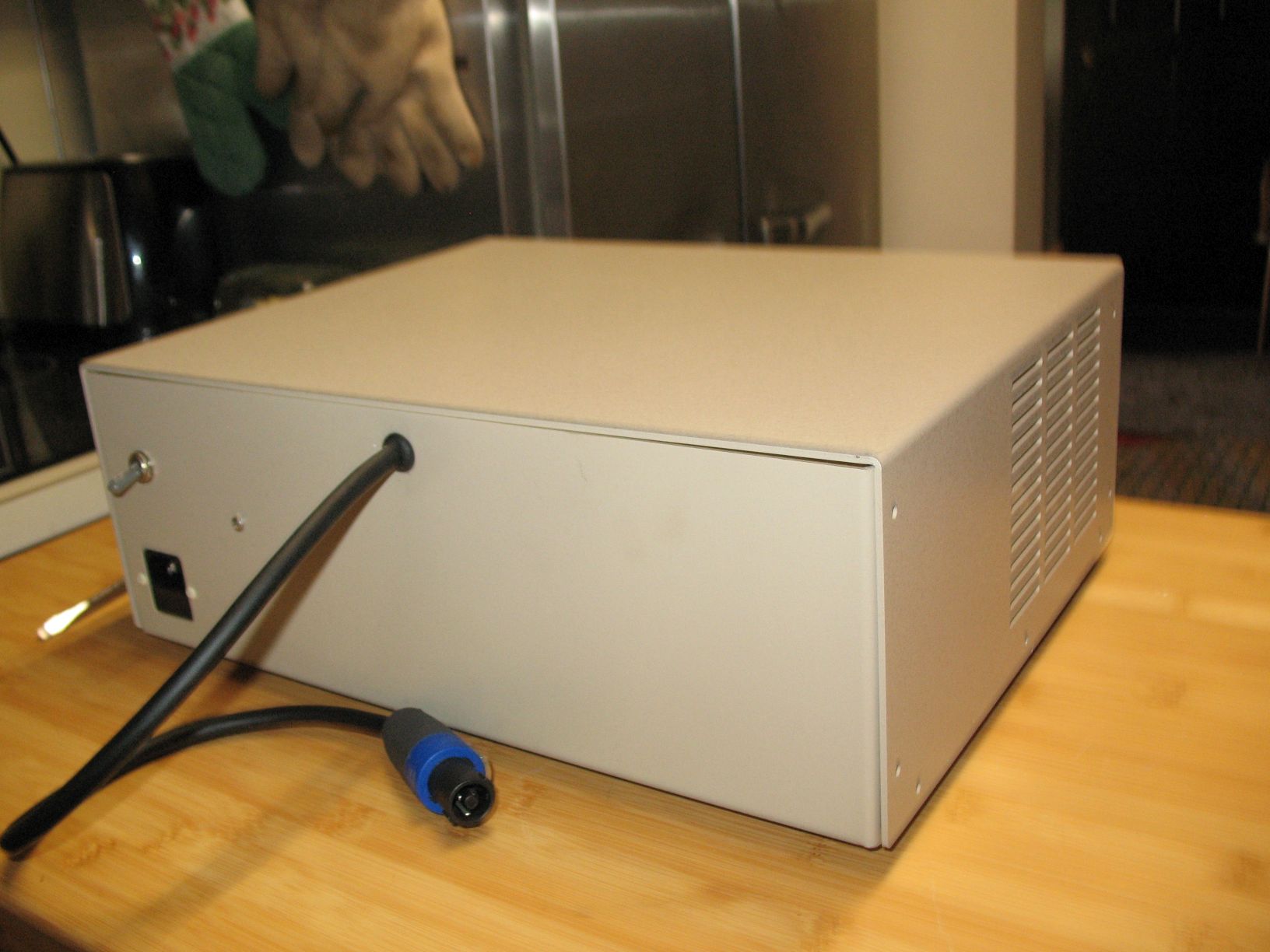

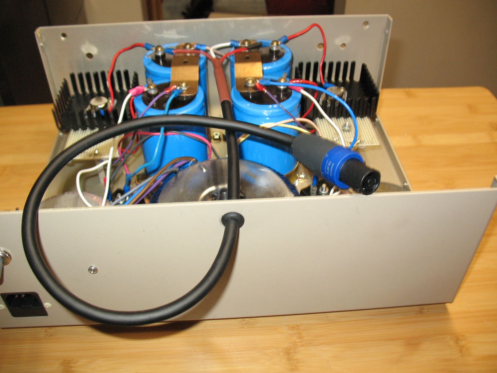

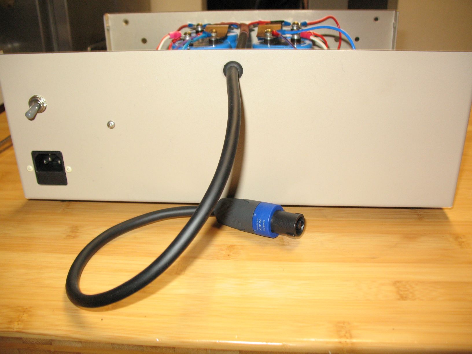

On the other hand, if you want to do something totally over the top that's impractical from a cost, size, weight and usability perspective...
500VA 30+30 transformer > 25A Bridge rectifiers > 22mh toroidal chokes > 50V 30,000 uf capacitors > LT338 regulators (set at 23V) > 50V 30,000 uf capacitors. Connected to the ACA with Neutrik terminated star quad cable.
Kind of silly for a a measly 8 watt amplifier, but if you have all of parts in your amp-building stash, why not? Thanks to Nelson Pass for the excellent design.
