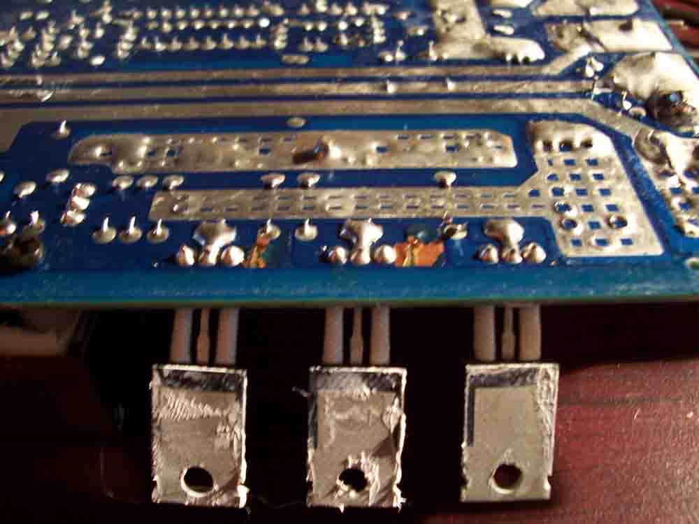

how do i chase something like that down? is there a place i should be looking at more than others? i pulled the board from the heat sink and the underside lookes like an assmbly line workers first day with a solder gun.
i have about 1000 ohms resistance between the + and the - chasis terminals which seems to support your diagnoses.
How much resistance do you have between leg 3 of the power supply FETs and the chassis ground terminal? It should be 0 ohms.
You can't use solder only to jump the trace. Use a piece of wire or desoldering braid.
I think you'll find that those FETs are shorted.

i pulled all 6 and from the gate to the other 2 legs on diode check i am getting 1.5. im getting this on all but 1 of them
is this enough to be replaced ?

The only way you should have a 1 displayed is if your meter displays a 1 when there is an open circuit. There should be absolutely no DC continuity between the first leg and the other legs of the power supply FETs. The following page (and the links on it) will help you to learn to test transistors.

on 5 of the 6 power supplies are reading about 1 ohm between the gate and the other 2 legs. i tried using the meter on diode check and i am getting what i think is .001. it is certainly not open. it reads OL when i turn it on and when i put the leads on it jumps straight to 001. im pretty sure they are bad because the one that is ok seems to pass all the tests.
