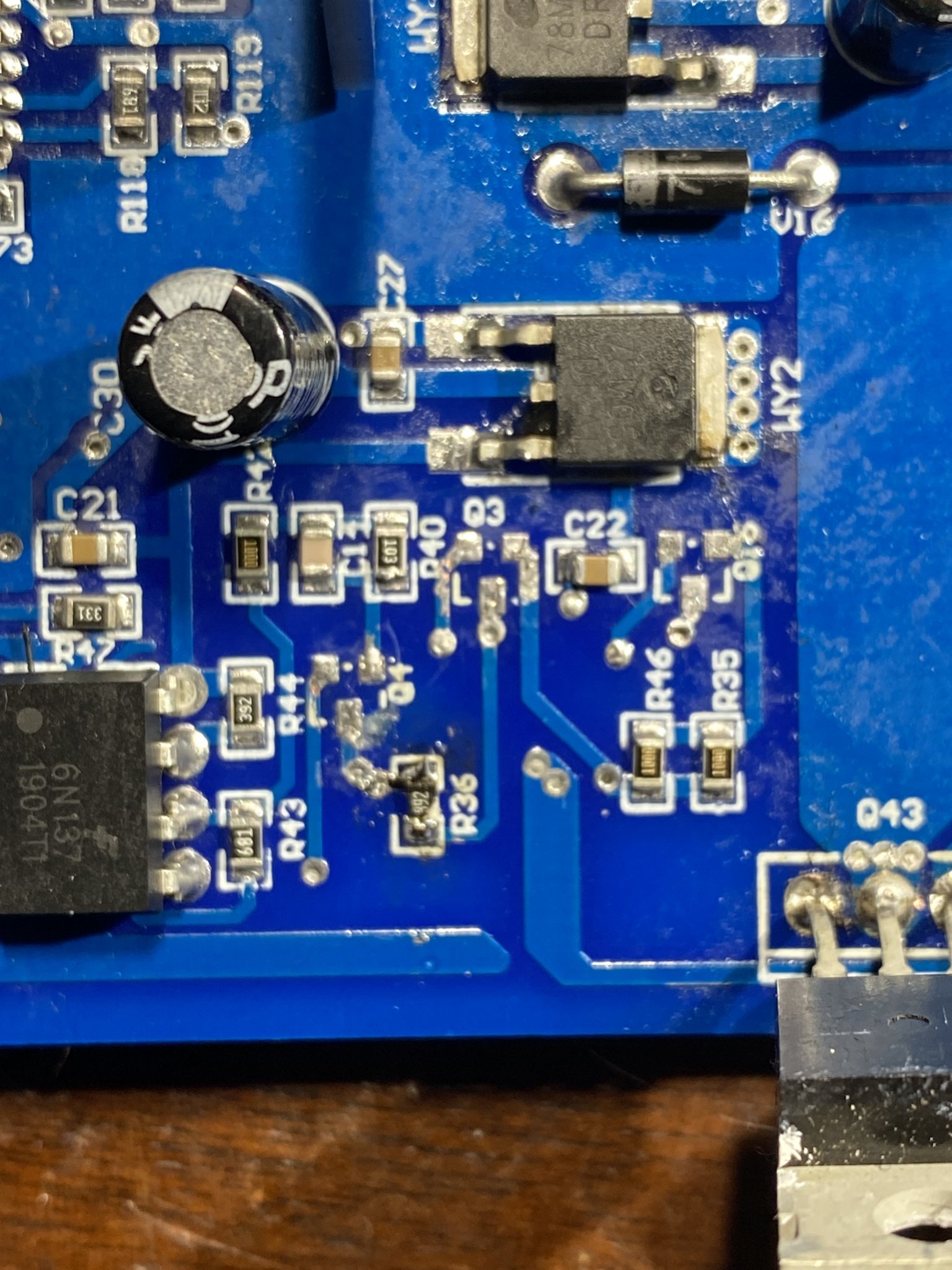

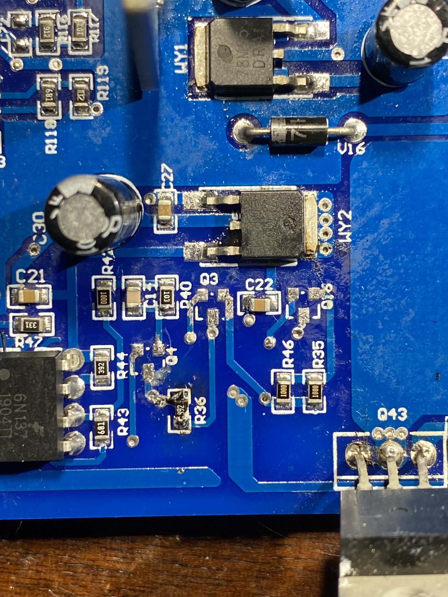

amp has a few snapped power supply fets replaced them. Then I took out the rectifiers and powered it up and a 2x(q3) kept heating up on the same side. Pulled it and noticed 9 volts sitting on pad 1 of q4 (2t)and pad 2 of q16 (2x). On the working side of the amp a resistor pulls the voltage down going to them. On this side it’s not pulling it down. It’s the same before and after r36. And the 9 volts I’m reading is what’s coming off the voltage regulator. I pulled the resistor and the voltage went away. Tested the resistor and its good. I’m lost. Only thing I can e see to pull that down is the resistor that seems to be good. Any help appreciated

the voltage comes from the regulator to r36. On the back tab it supplies pin 1 of q3 on the front tab it supplies pin 1 of q4 and pin 2 of q16. With the resistor out I get nothing on those pads

When I removed the resistor I lost drive but still have the extra 9v. Would a 3.9k ohm resistor even be used to drop the voltage?
