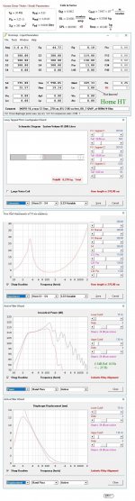

I would just like some dimensions for a sealed box for a MOFO 10, the owners manual says NA under sealed box, then says to use polyfill in sealed boxes and to staple insulation sheets on the ported box. So im confused, I thought they said NA under sealed box. Anyway they say 1.75 cu./ft. For the vented box, but don't include recommended styles or dimensions. So some sealed box #'s & some ported box #''s would be greatly appreciated. Thanks in advance.
1.75 ft^3 tuned to 35hz and 1 ft^3 sealed are the generic car audio go-to's. without the actual parameters it would be very difficult to come up with something "better". as for dimensions, anything you can dream up that allows the driver (and port) to fit. 3" pvc could be used for the port, in lower power situations 2.5" could also be used. the volume of the port should be added to the 1.75 ft^3 figure, so you'd likely be aiming for right around 2 ft^3 in design.
An educated guess of the T/S could be in place:
