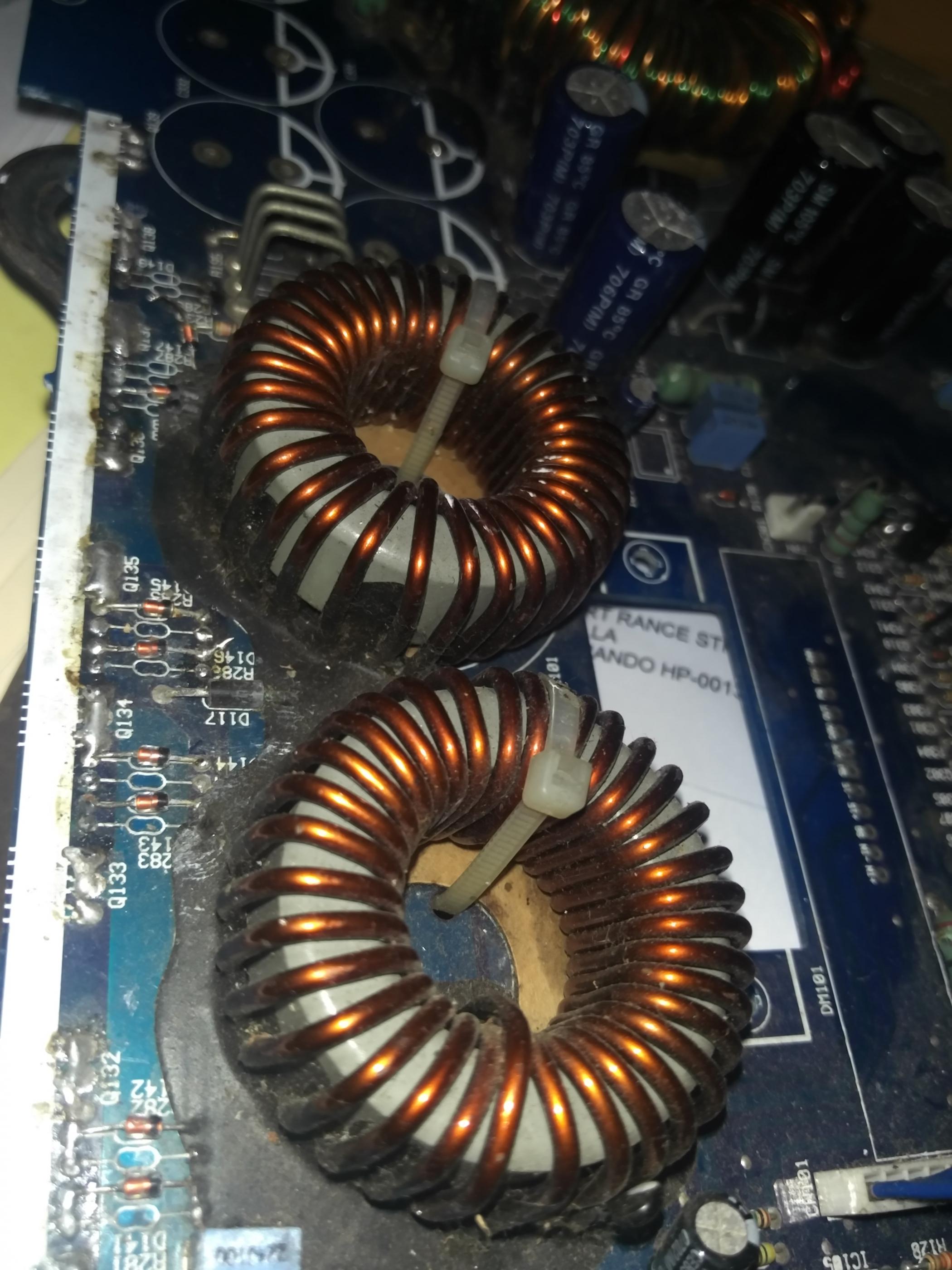

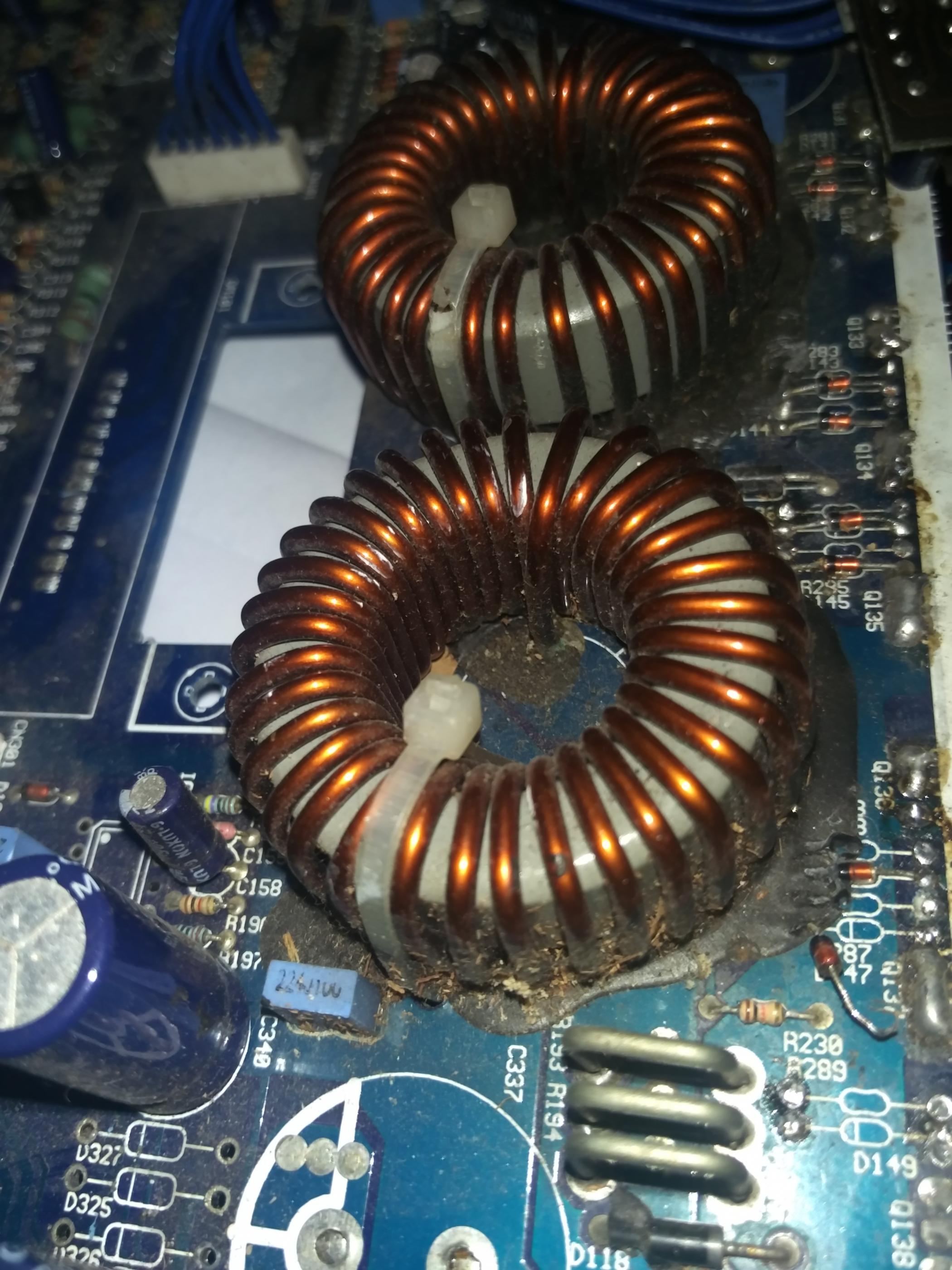

Look for a powdery substance where the terminal winding meets the rest of the windings. See attached for an example.
The most common reason for the caps to fail is a drive problem causing one rail to increase. If that's not the problem, it could be shorted inductors. It's also possible that the terminal of the capacitor shorted to the board.

The rail filter inductor may be able to cause the rail caps to overheat but that would likely only be at heavy loads. When they fail, they generally short the high and low rails together, causing excessive current draw or blowing open the inductor windings. To eliminate this as a possible problem, find and insulate any areas of the windings that are damaged. This generally happens where the terminal windings meet the rest of the windings (top or bottom).

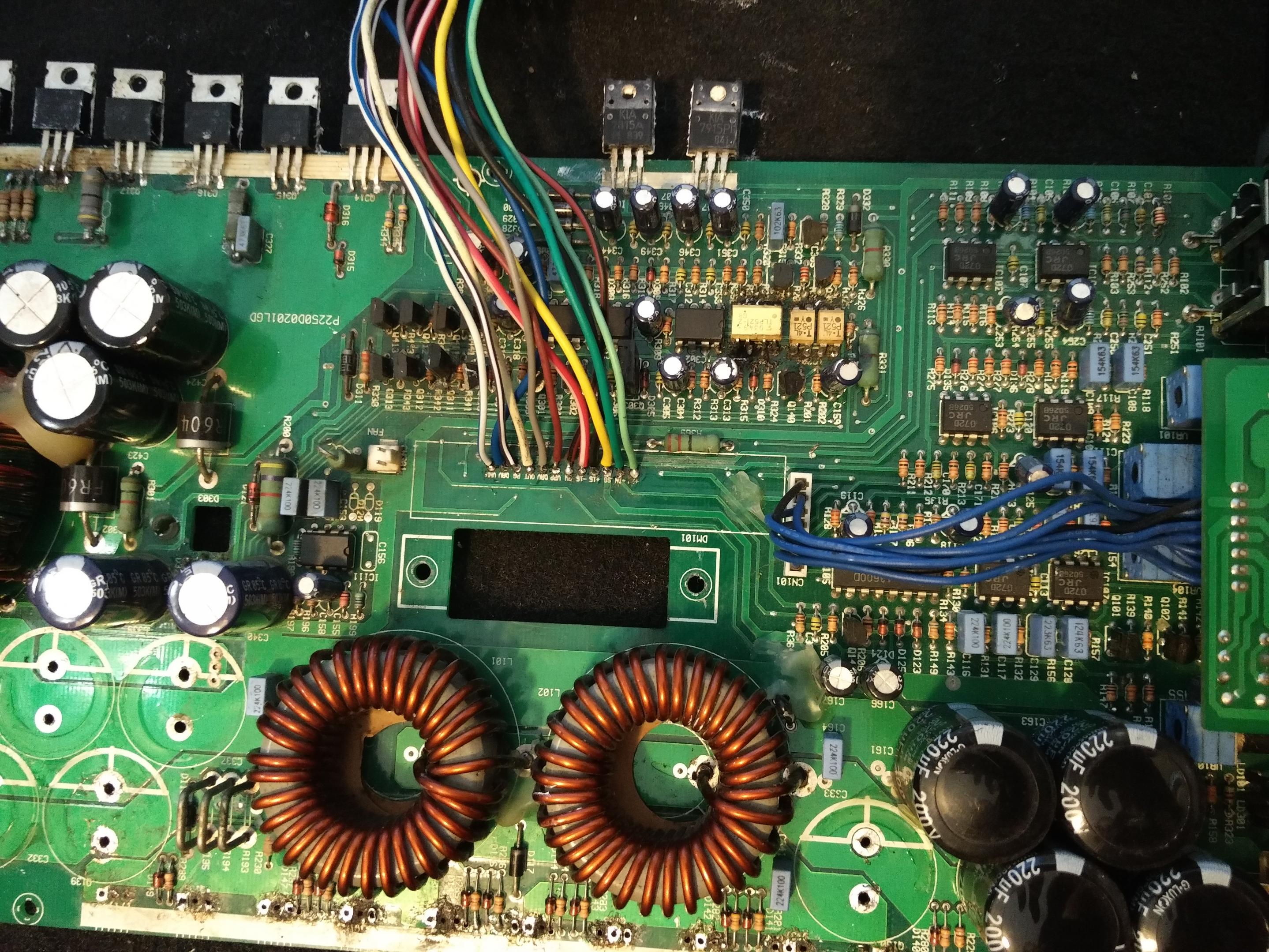

Also, to make it easier to troubleshoot the driver board, I have attached it with wires so I can access both sides without twisting up the amp sideways and such. Is that a problem?

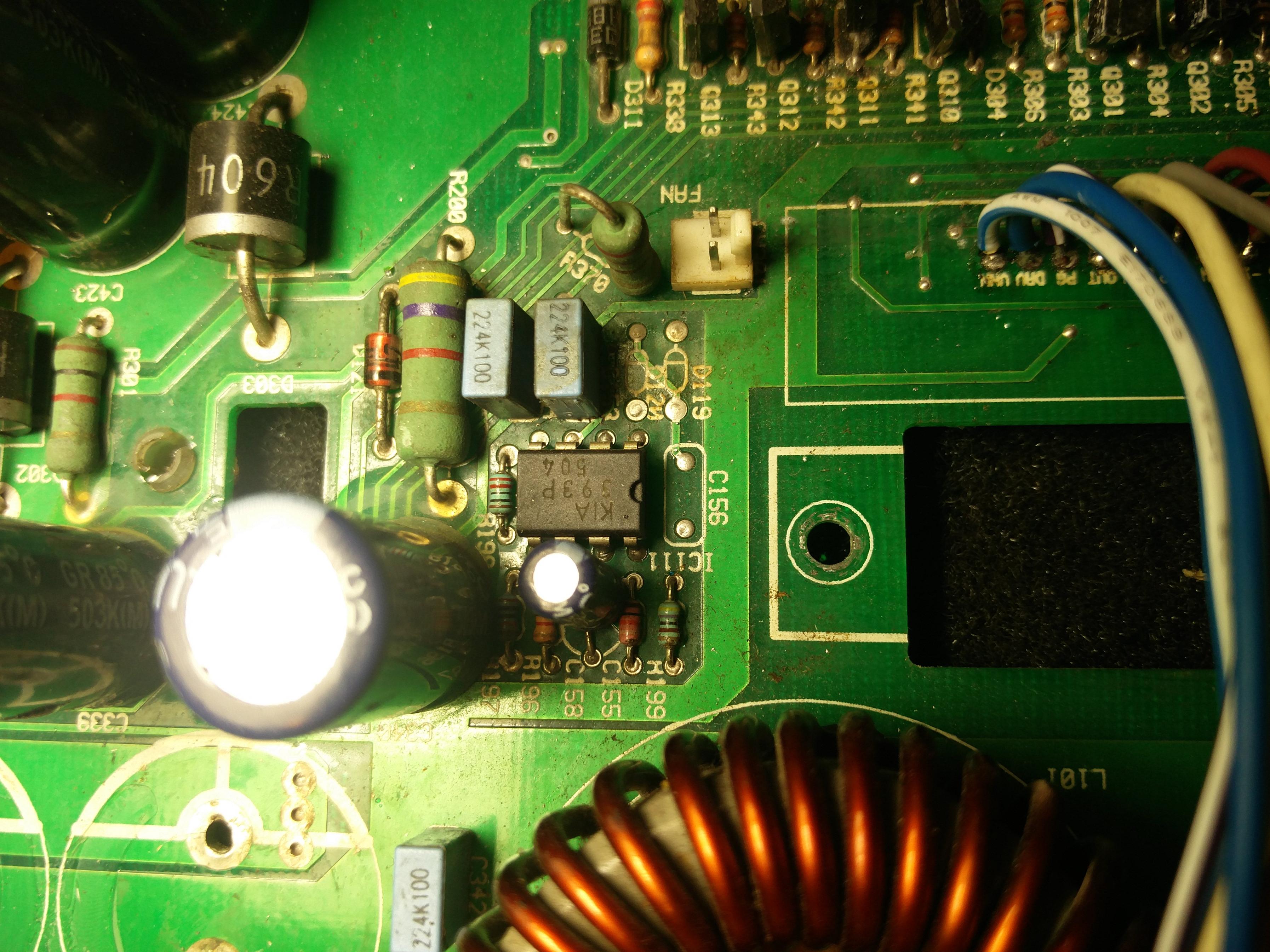

Look around the board close to the KIA431 look
For resistor maybe R70 it is a 150k resistor unsolder 1 end and check to see if it is within tolerance ..

From the pics it looks like that board is pretty much shot ..
I will let Perry continue to help you since he has more knowledge of this amp ..

Voltage on KIA431 pin 1 to pin 2 is 0.6v and resistor measures 151.5k ohms.

KIA 431 is shorted between legs 2 and 3. I don't have a replacement so I will try to locate one tomorrow and install it. I will post the results when I do.

TL431 is equal.
This is part of the regulator. If there are no more defective regulator components, the rail voltage should return to normal.
Replaced KIA 431 with a TL 431 and rail voltage has gone up to +/-65v with 13.4v of supply voltage. You have 80v of rail in your notes. Is there anything else to check in an effort to get the rail voltage higher?
