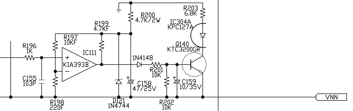

Is there any upgrade to the protection circuit in this amp and the clones like it ?
Wondering since every amp I see like this if the outputs blow the protection doesn't kick in and the amp also blows the power supply fets every time the outputs short ..

You can reduce the voltage divider threshold resistor to lower the protection circuit threshold for shutting down. In the attached photo, R198 is a 150 ohm. It was originally a 220 ohm. It may be possible to reduce it further (I've gone as low as 100 ohms in some amps).
