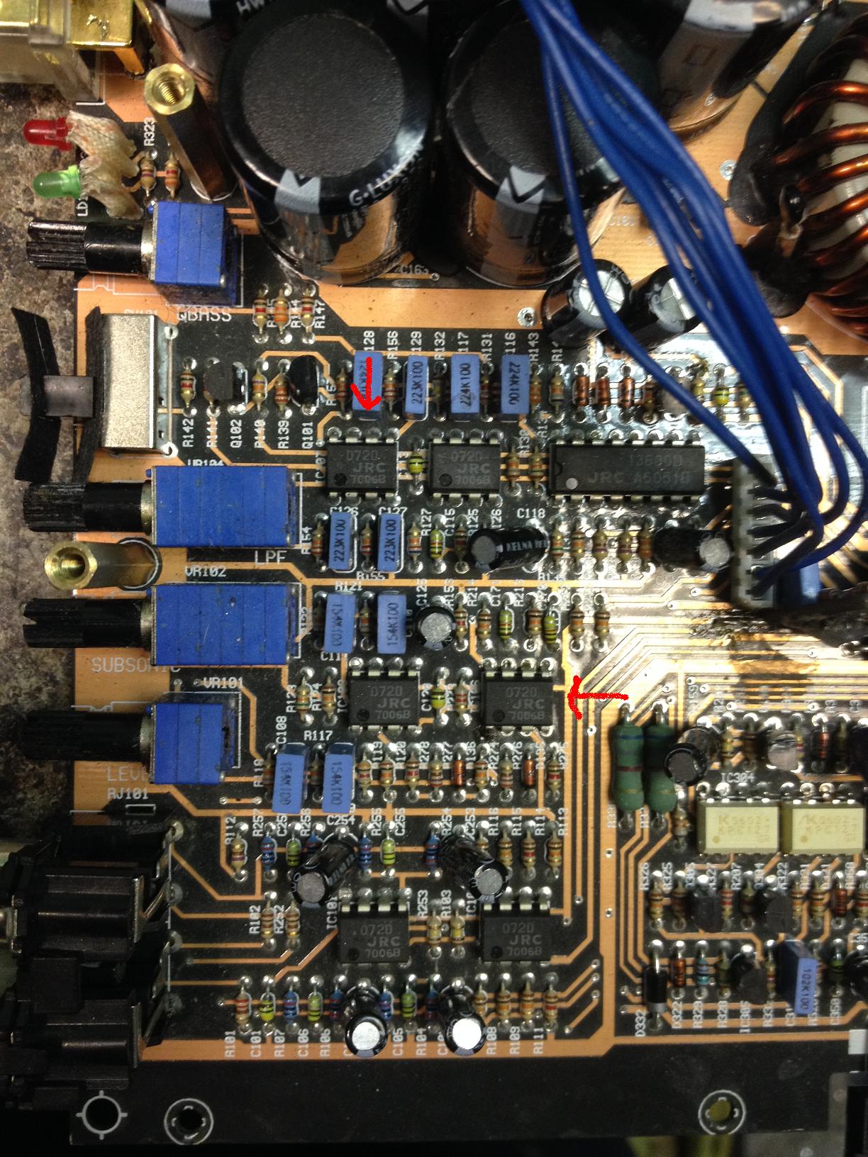

Ok I figured out why the amp protected again that problem is solved..
I still get no outpit from this amp at all..
Any ideas on what to check??

All op-amps have 0.00 volts on Pins 1,2,3,5,6,7 and have the correct + - 15volts on pins 4 and 8 besides theese 2 op-amps..
The voltage on the pins are
Leg 1:-8.34
Leg 2:-3.14
Leg 3:0.00
Leg 4:-13.28
Leg 5:-8.26
Leg 6:-8.26
Leg 7:-8.26
Leg 8:13.64
The other op-amp
Leg 1:-8.30
Leg 2:-8.30
Leg 3:-8.30
Leg 4:-13.28
Leg 5:-8.30
Leg 6:-8.30
Leg 7:-8.30
Leg 8:13,28
Is this normal for theese 2 op-amps or do the appear to be defective?

IC106
Leg 1:-8.34
Leg 2:-3.14
Leg 3:0.00
Leg 4:-13.28
Leg 5:-8.26
Leg 6:-8.26
Leg 7:-8.26
Leg 8:13.64
IC107
Leg 1:-8.30
Leg 2:-8.30
Leg 3:-8.30
Leg 4:-13.28
Leg 5:-8.30
Leg 6:-8.30
Leg 7:-8.30
Leg 8:13.28
