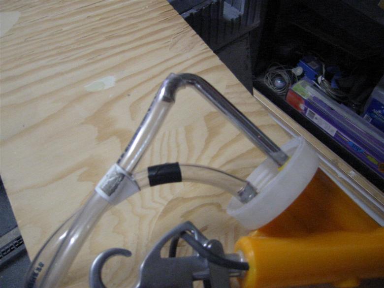

I have done this mod to my HF powder gun and am highly pleased with the new output. The only problem I have is storage. The gun is attached to the power supply with that long cord and makes it difficult to put in a box. Has anyone thought about cutting the electrical wire from the power supply to the gun and rewiring it with a small plug and socket?? This would make it much easier to store and use the gun.
