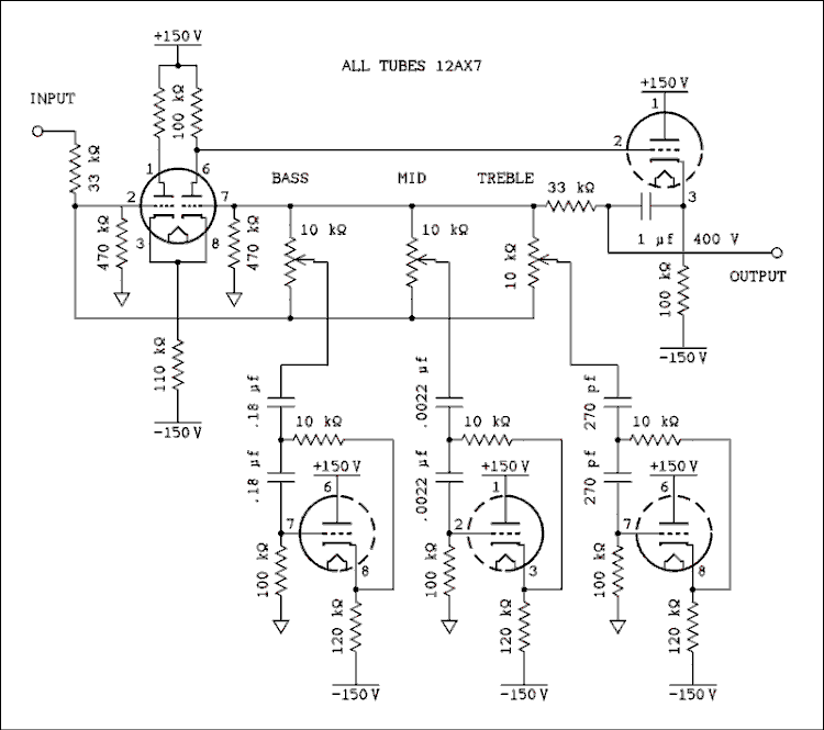

The main difference between potentiometer values is overlap between bands. As you can see in the two figures, the individual band filter tubes have the same values of passive parts in both diagrams. The 3-band eq has smaller values for the pots because the filters need to cover more frequency range. The smaller pots lower the Q of the filter, which widens the filter's effective range. Likewise, the larger pots increase the Q of each filter to within a narrower range of frequencies. This ensures they don't overlap too much.
The best way to learn for yourself is to build a 3 or 5 band circuit and hear how it changes when the controls are adjusted. Then switch out a single pot with one of a different value and listen to it again. Nothing will get blown except your mind.
You are correct, the pot does not set the center frequency, instead it is the 10k resistor in the gyrator, but the pot value does have an effect on the peaks and valleys, 100k giving a bit more range than the 10k.yes but capacitors are the same in both circuits.. i've checked it.. only pots are diferrent (10k vs 100k)

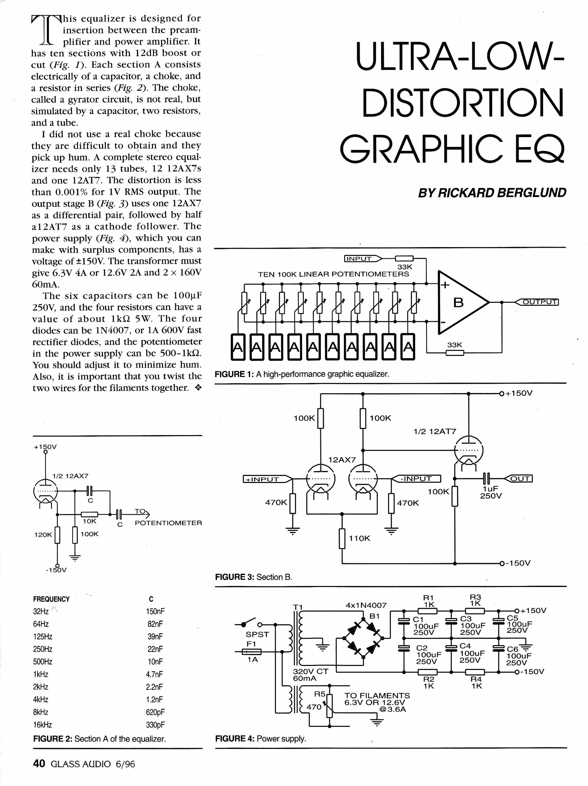

Ouch!!! what a poor design.
Tubes trying to do (poorly) what SS does easily.
No advantage at all by building an Op Amp and Gyrators equalizer where tubes miss what's needed by far and to boot can add nothing of their magic.
Nothing against tubes per se, just the wrong tool for the job.
The circuit in general looks like a 10X lineal scaling of a very common SS circuit, to the point of using symmetrical +/-150V power rails instead of +/-15V and so on.
Best for this circuit are Ideal Op Amps , to which SS ones are very close real world versions; while tubes are very far from that.
from: Ideal Op-amp Characteristics
* Infinite voltage gain ... NO , think about 50X or so , best reasonably achievable is around 100X or 20dB , any run of the mill 50 cent Op Amp boasts 70 to 90 dB open loop.
* Zero output impedance ..... Op Amps: fractions of an ohm; Tubes: tens of kiloohms, down to hundreds if cathode follower.
* Infinite bandwidth ... well, there tubes are flat, at least within the audio band ; problem is that they have such a low gain that such capability gets unused.
* Zero input offset voltage (i.e., exactly zero out if zero in)
This is the worst offender: an SS Op Amp can have output offset within a couple millivolts of whatever's at the input, and has special pins dedicated to offset zeroing if needed to go down to microVolts, a Tube Op Amp can be lucky if output is less than a few volts away from input.
This circuit could have made sense 60 years ago (or more) when Tube Op Amps were developed for Military and Space use and nothing else was available.

Back to the original question: 10k is ridiculously low, and probably a mistype or transcription error, typical graphic eq pot value is at least 3X the input or feedback resistor value.
Since 33k was used here, a 100k linear pot is fine.
As a side note, best pot resistance curve is "S" curve: log at one end and anti log at the other, for smoothest operation all over the range, but for cost reasons linears are often used.
