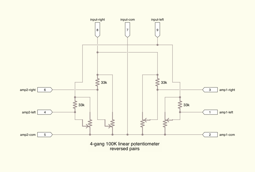

twin amp balance control
Anyway, as I mentioned in previous post, I plan to use 2 stereo amplifiers.
I came to idea to build a balance control potentiometer that I will use between preamp and 2 amplifiers.
Something like in the attachment... any correction is welcome...
...it is 4 gang linear 100k pot, in center position both amps should have equal attenuation, as low as possible...
