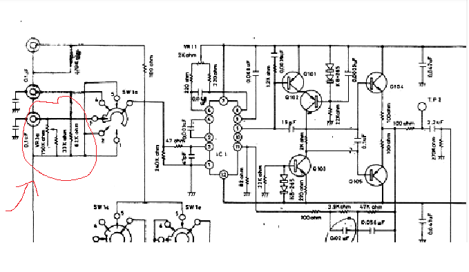

Potentiometer instead of load resistors in phono pre
You can certainly do that, but the sliding contact of the pot may introduce noise in a circuit that has that much voltage amplification. Try it and see how it works out. Be sure to use a linear taper pot. If the pot has a metal case, be sure to ground that to avoid noise pickup.
Yes. I came up with this to see the difference of different loads on the sound, as it can be done while the record is playing. I have acquired a Grade Prestige Green p mount. It's on a Technics SL-10.
Charged with 47k without capacitor. Just the capacitance of the cable.
According to the manufacturer it can be loaded from 10k to 47k.
It's good to experiment with the pot to quickly home in on an optimum value. Measure the pot's resistance after finding the best setting and replace with fixed R for best noise performance. Plus, you won't accidentally bump the fixed resistor to a different value the way you might with a pot.
I found what you were asking for. Luxman C12 preamp

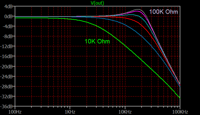

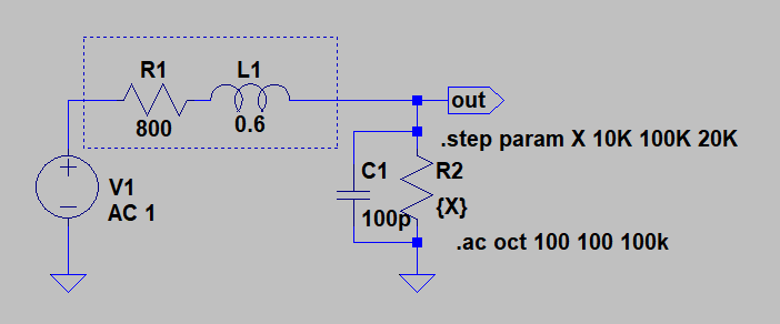

When the resistance goes as low as 10k 15k you significantly reduce the high frequency output of the cartridge. Probably best to pick a reasonable range of values, say 35k to 75k
I can be agree.
But your is a simualtion and, as usual, it is a virtual world, there are also mechanical aspect that is not possible to simulate and each MM is different from others.
We can use the simulation only for a general discussion

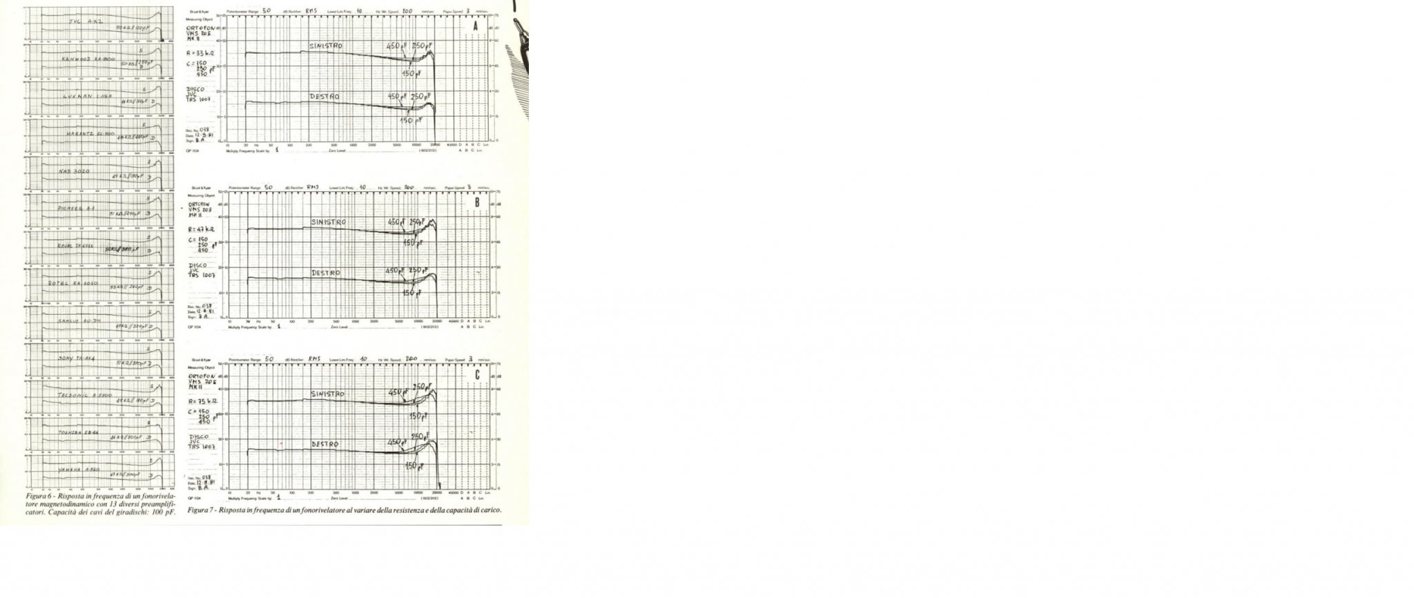

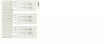

In case in attach a old graphics done at Audioreview ( where I have a coolaboration) around frequency response of a MM on different load.

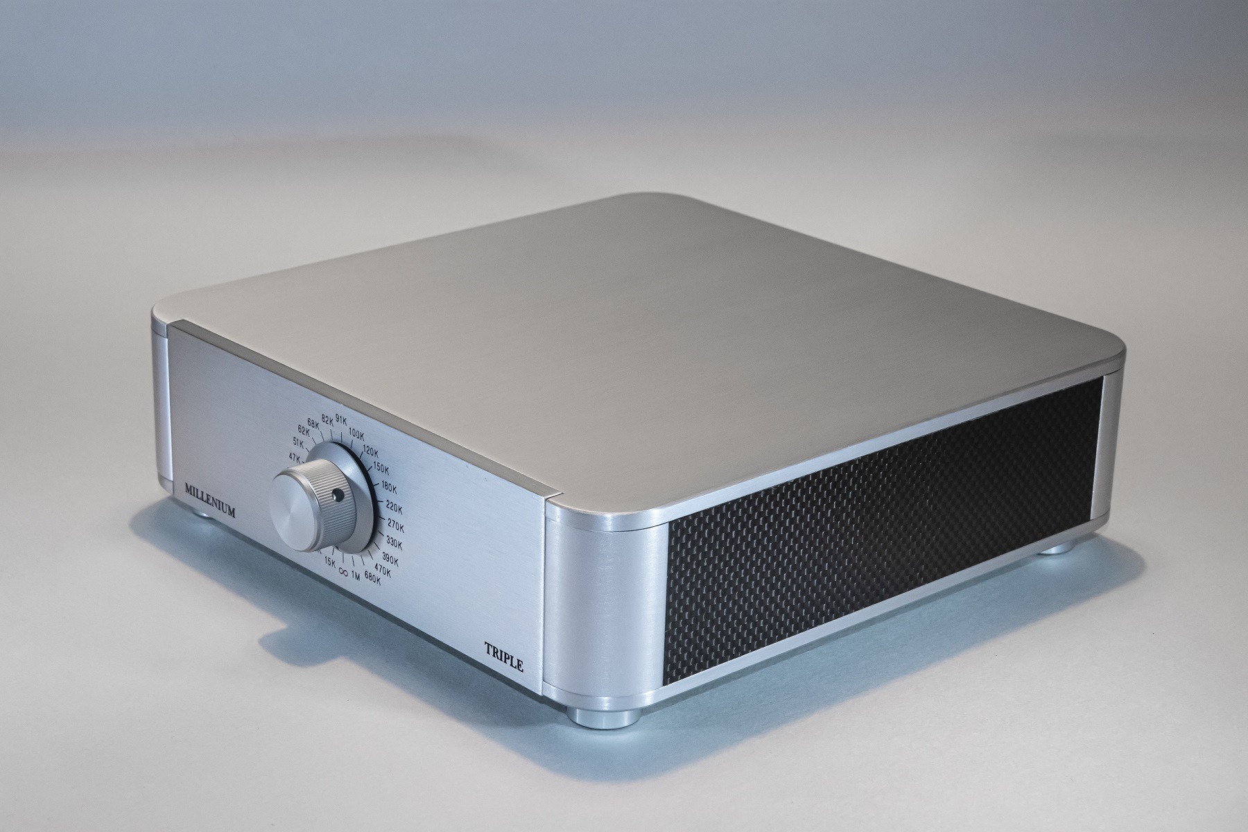

In addition a step up I am building with 3 ratios (10,20,40) and a 24 position switch that put in parallel on secondary differetn values to macth the Zsource od a MC
