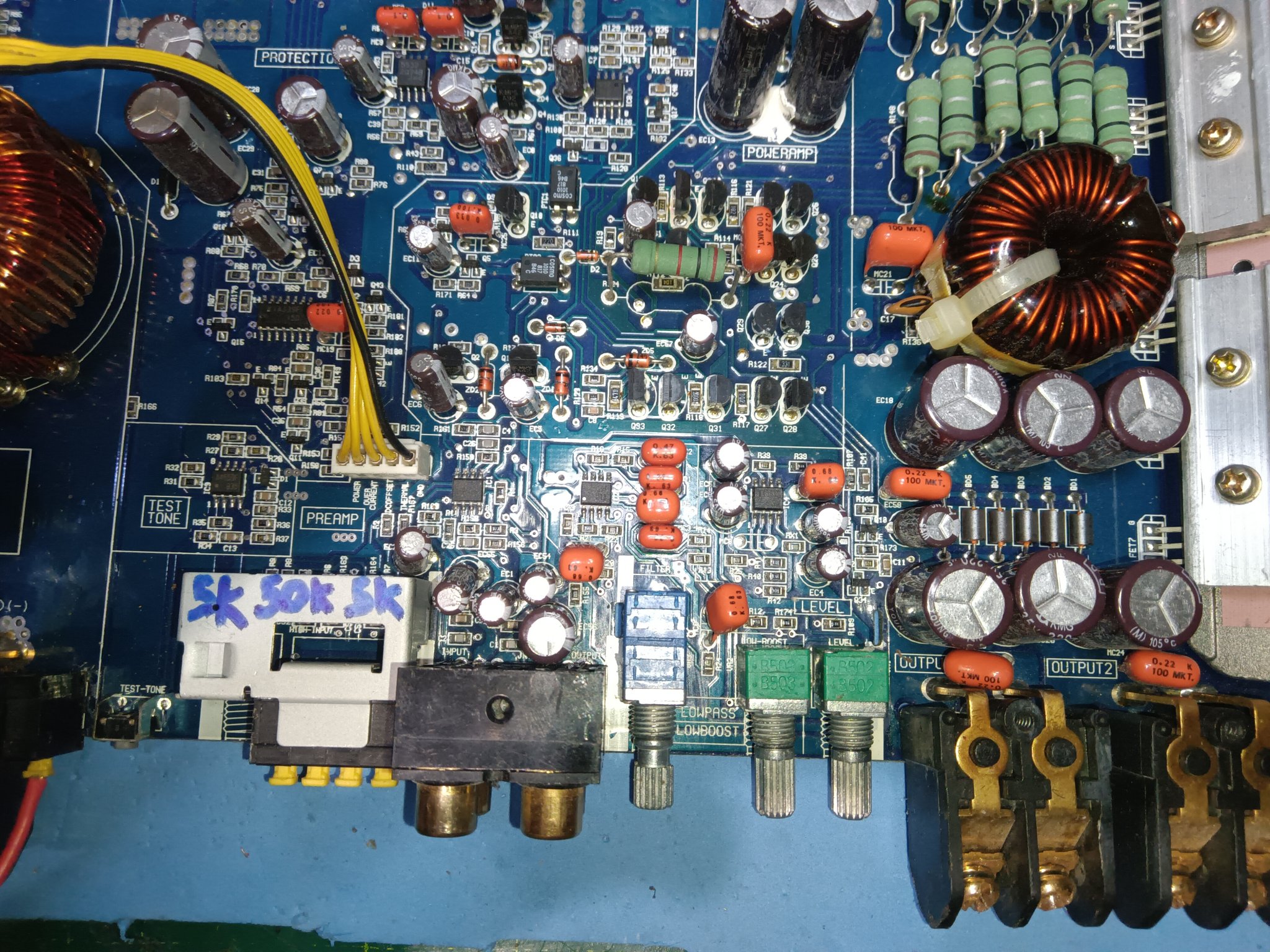

I'm working on a Sony XM-1600GSD and the Filter said it needs a 12 pin 5k and I cannot find that anywhere from the USA to China. I stuck a 10k in its place would that be ok? I got the amp with rusted pots so I’m not sure how it sounded but after changing the Gain (6 pin 5k have it), Low Boost (6 pin 50k have it) and Filter (12 pin 5k did not have changed for 10k) the sound comes out playing very nice but the volume is very low to where I turn the stereo completely up and the gain all the way up and it’s like playing at level 2 maybe. Do you think the 10k might have done that? Remember I did not get a chance to hear this amp before I changed the pots. What might be the problem or where should I look? Thanks

Set the test tone to about 50Hz and the crossover pot fully clockwise and measure again.
Measure pins 1 and 7 on IC1, IC2, IC4 and IC5. Also measure the voltage on the RCA jacks with the probes on the shield and the center conductor on the back of the RCA jack. All of these are AC voltage.
Oscilloscope set on AC
IC1
Pin1 = 5.26v
Pin7 = 5.39v
IC2
Pin1 = 1.20v
Pin7 = 4.43v
IC4
Pin1 = 0.00v
Pin7 = 0.00v but flashes random numbers like 338mv, 409mv
IC5
Pin1 = 1.53v
Pin7 = 0.00v but flashes random numbers like 405mv, 280mv
RCA Input with 50Hz
Shield and the center conductor = 2.66v
