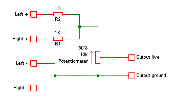

I am in need of some help, I have built a dub sound system with a mate of mine and am now in the process of making a rack mounted volume control to control the level of the bass without having to adjust the two volume channels on the power amp.
We run everything in mono.
The volume wheel I am making is to be placed in-between the limiter/crossover and amp. I have a left and right channel I need to put into it, so I was thinking with it being in mono just attaching the +L input to +R and –L to –R, leaving two inputs I need to send to the pot, (and obviously the same for the output.)
Could someone please tell me the best way to wire the pot?
(I think I have looked into it too much and all the different ways of wiring them have just been moulded together in my mind.)
I understand as much as point 1 on the pot is ground, 2 out and 3 in, but what does one do when there are two poles to send into it and out of it??

Hi
I meant to wire it up like in the pic below.
This is assuming that the equipment has single ended inputs and outputs (e.g. with RCA connectors). In that case L- and R- are both earth connections.
If it's balanced (e.g. with XLR connectors), then the story gets more complicated.

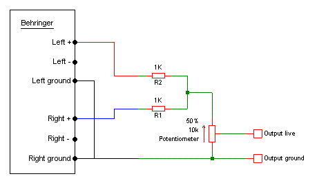

edit: Drat, I looked up the Behringer DCX2496, and it only has balanced outputs. I'll post plan B in a few minutes.
I think the easiest will be to just use the "+" outputs from the Behringer, and leave the "-" outputs unconnected, unless someone else has a better idea.
Depending on the Behringer's circuitry, it might work better if you put a resistor from each "-" output to ground as well. Resistors only cost a few pence for a bag of 10, so experimentation is (financially) painless.
If the Behringer has genuine balanced circuitry, then probably no as the '-' has to take the signal return current. If only pseudo-balanced then it should be OK. On cheap semi-pro gear 'balanced' is often only pseudo-balanced.
If it is only a short connection in a benign low-noise environment then you can may get away with an unbalanced volume pot in a 'balanced' connection: just treat '-' as ground for the pot.
