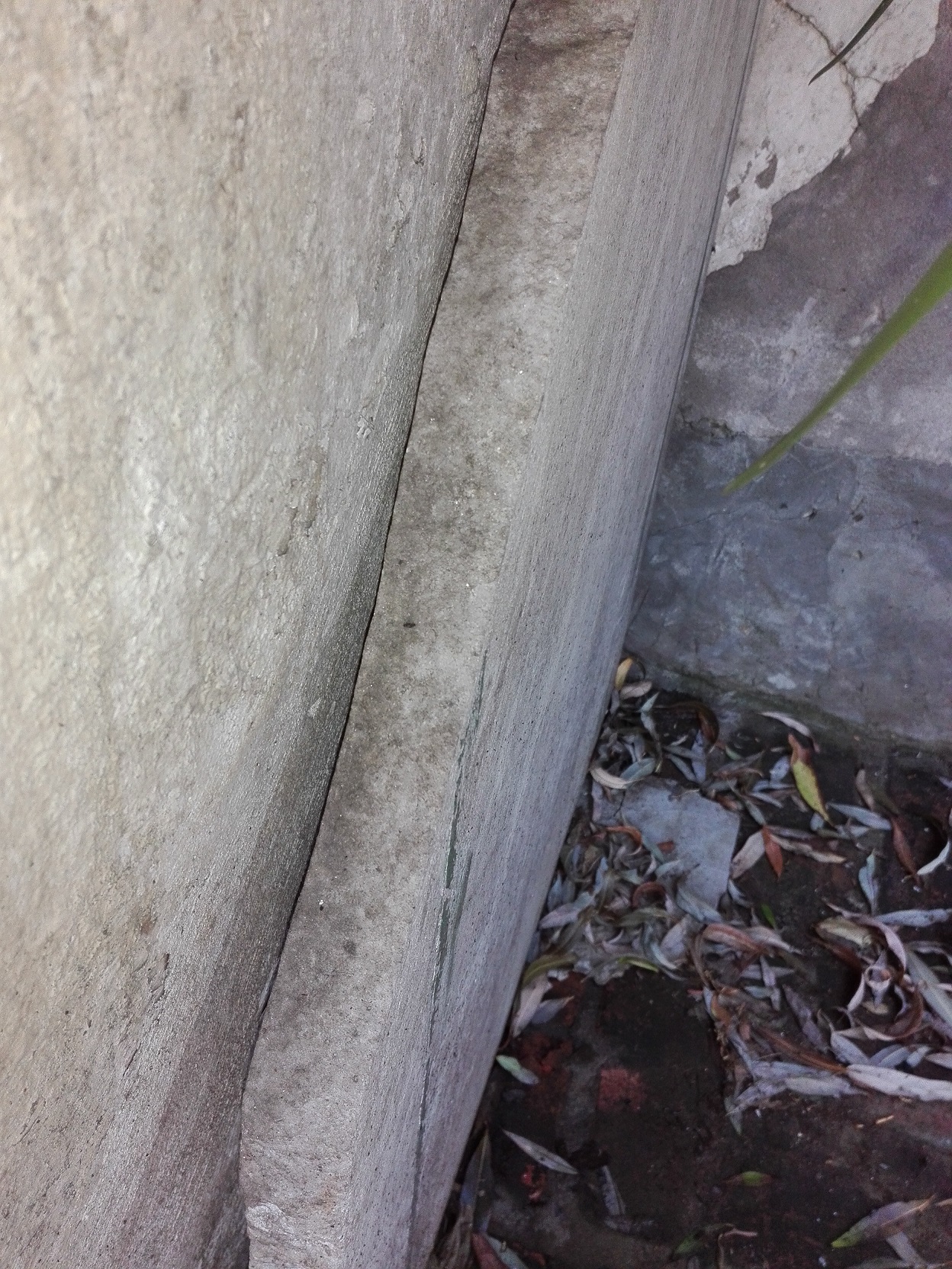

I read somewhere your post about how they loaded an Altec cabinet with bricks .....
Because of this, I am looking with interest at a block of marble that is tucked away in a yard .....
Do you think it will really improve the sound of my 150 liter sealed construction? I could cut it out and put it inside. (in the base, obviously)
Keep in mind that my spine already has its breakdowns, I would not like to receive new reprimands from my doctor about it ....😱
