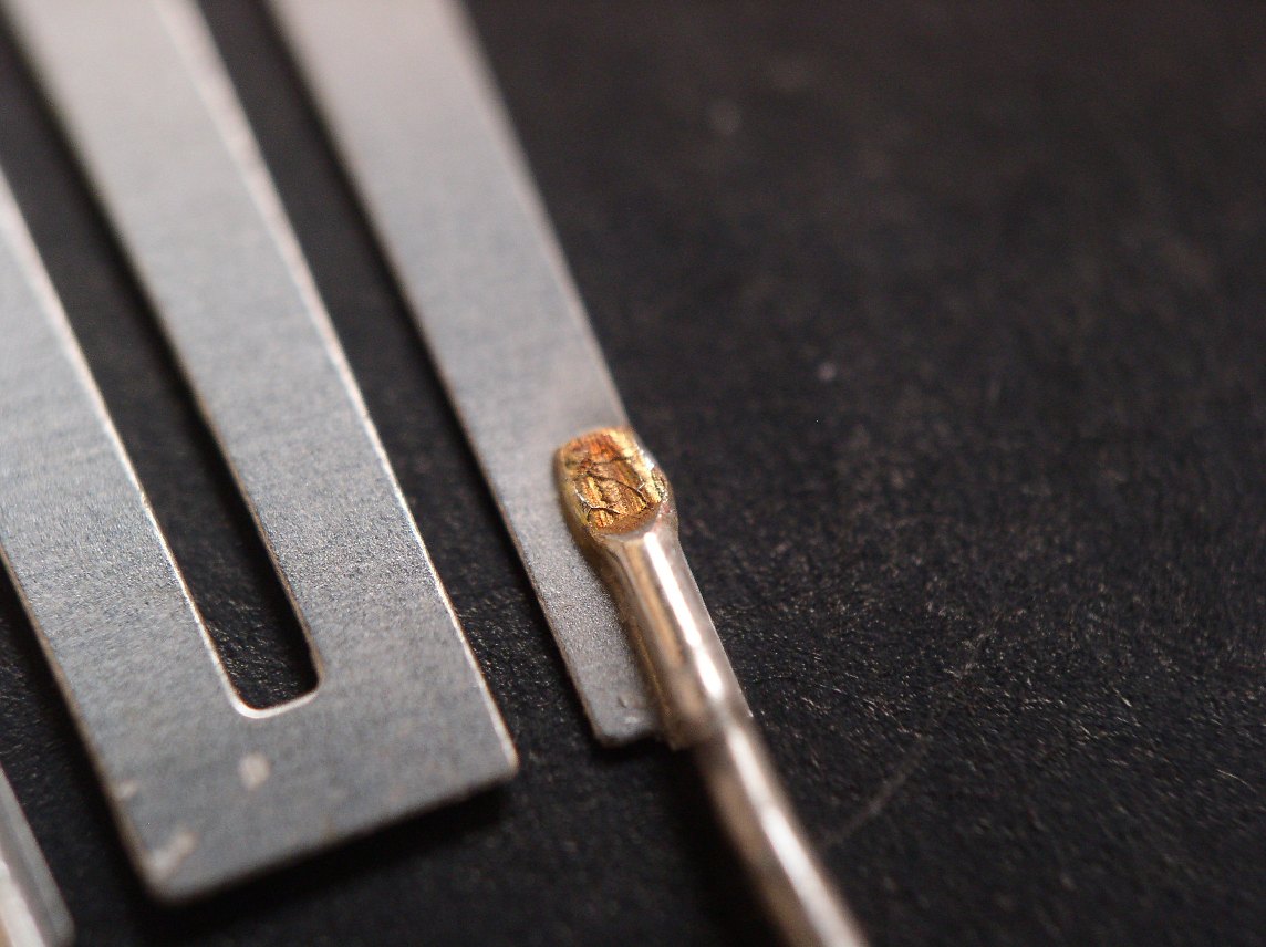

Gives me some ideas, like eliminating the leads and soldering direct. Perhaps it would be possible to trim it to give the exact resistance one wanted?

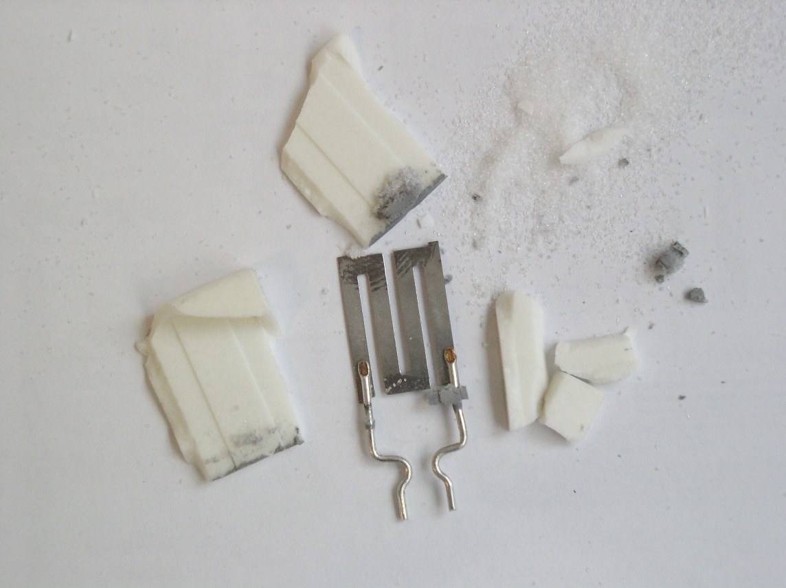

What to see how it looks like inside ?
Patrick
Thanks. Which part of the F5X is this? Looks like a very tedious work.
