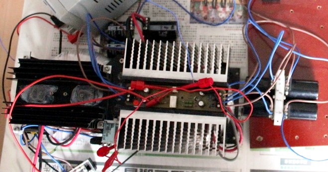

I just finished my measurement to Zhou's N-P match sets and my 10+10 random buy.
First, I can pretty much confirm that Zhou didn't match at 2A. It was more like at the 500ma range.
From Zhou, the 8 pair of devices have:
2SK1530 Vgs: Zhou's measurement, 1.9770 to 1.9705, diff 6.5ma
From my single point 2A matching, I got 2.453 to 2.388, diff 65ma.
2SJ201 Vgs: Zhou's measurement, 1.9772 to 1.9720, diff 5.2ma.
From my single point 2A matching, I got 2.419 to 2.411, diff 8ma.

As reported earlier, we had a sizing problem with the regulator heat sink.
As a result, we have shipped the original heatsink with a CRC PCB, and provided MPC74 resistors, at our costs.
This enables you to build the F5X using a CRC supply.
We are pleased to inform you that we have successfully tested a ultimo solution.
Thanks to Mark for all the testing efforts.
This solution uses 2x Fischer SK466-38 heatsink, bolted to a custom machined U-channel.
On the channel are mounted 8x TO220 rectifying diodes, as well as the original MOSFET regulator.
At regulator full load (output +/-16V 4A), the temperature rise from ambient was 32°C.
We are therefore happy enough to release this solution as it.
See attached picture.
For comparison the original heatsink is on the left, and the caps on top & right.
Patrick

To implement this solution, you will need to GB, for each case 4x, SK466-38 heatsink extrusion from Fischer.
Probably best done by someone living in Germany, Holland, or Austria, preferably with a company.
There are two through holes required to bolt them onto the U-Channel.
If Fischer charges too much for the drilling, there is no reason you cannot drill yourselves.
Then you would need a conversion kit from us, consisting of the 2x custom machined channels.
In addition, some of the original standoffs and cross bars for supporting the heatsink would need to be replaced.
We can offer this conversion kit at cost, at 60 Euros per case including Paypal and registered post.
The cost of the SK466s would be additional.
At Buerklin, a standard length of 50mm costs 6 Euros incl VAT at quantities of 100.
So total cost is around 90~100 Euros.
https://www.buerklin.com/default.as...yp-Fischer-SK-466&event=ShowDvNr(B114400)&l=d
Thermal solutions are unfortunately not cheap.
We cannot use a standard U-channel because they simply do not have enough thickness for proper heat transfer.
Other simpler (lower cost) solutions we tried always exceed 40°C temperature rise.
You might perhaps use the CRC first and wait till the test team to report on subjective impressions before deciding.
Patrick

Patrick,
Does the "conversion kit" require a GB effort or is it something you could already make available on an individual basis?
As I will be building two amps I obviously would like to try both the regulated and the CRC solutions.
Nic

The conversion kit we can supply on individual basis.
The Fischer SK466-38 is however not standard length.
So you would need a GB for that.
We are also looking for a similar heat sink locally.
But this takes time to verify by test.
Patrick
