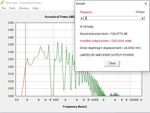

Patrick and friends, how would this 10" peerless do in a triple reflex?
It would make a very large and very potent hometheater subb if pushed into a corner. 😀
It is an 8th order BP (triple reflex but with quarter wave resonators).

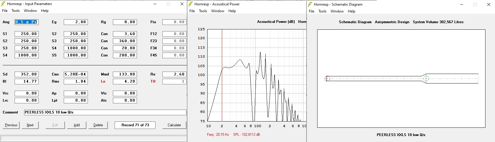

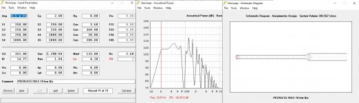

@circlomannen here's a 2pi model comparison of the max spl of your design to the table tuba with the peerless xxls
20hz tt 99.5 8th 114
30hz tt 114 8th 113
40hz tt 118 8th 119

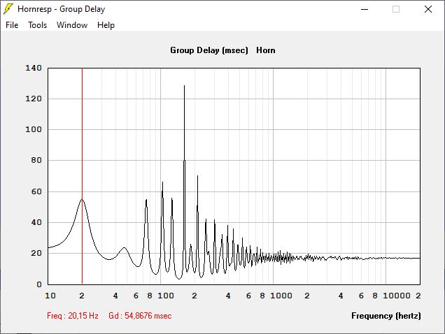

So yours kills it down low just not sure I want to build a 300 liter box and have 44ms group delay at 71hz.
