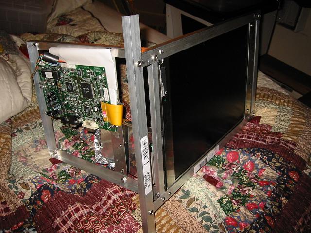

My results with VG151 15"
After testing with old laptop lcd I finally got my VG151 and made an encolsure for it - there are 2 boards that need to be mounted at right angles to the LCD and the ribbons are not in the best position (I have pics of the tear down process if anyone wants). I'll put down a few pics - the first is the LCD and the enclosure - the second will be finding nemo at around 90" screen, and the third is the same with me inthe image using the camera timer but the camera shifted a bit.

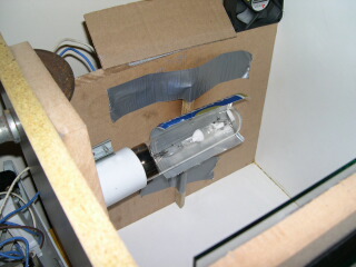

my projector is :
- 150W hqi /d bulb in a 500w halogen reflector/spot
- fresnel and triplet lens from DIY labs
- LCD 15" unknown name (bought on august 2003, 175$) with ribbon
- projector style is like the MK II (only a mirroir betwen buld and LCD) to stop the heat
- only one 120mm fan running at 5.5V, very quiet
picture have been took with a kodak CX 6330
