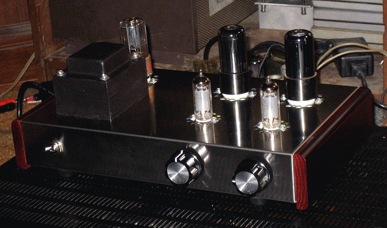

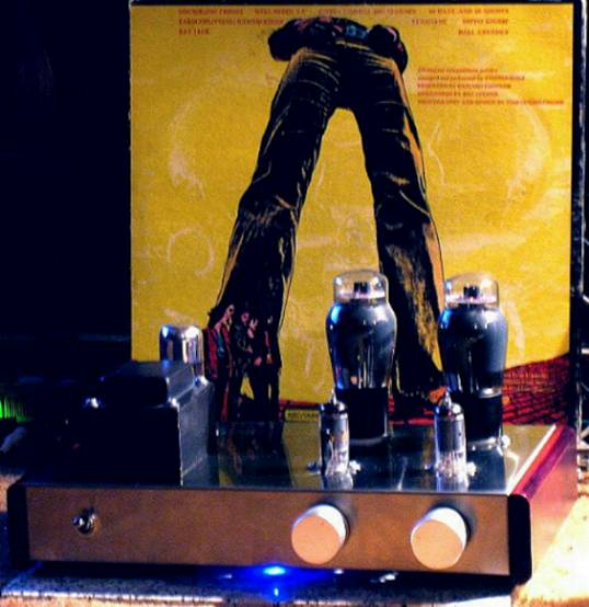

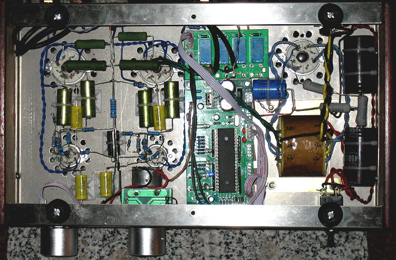

6P3P tube amplifier asemblyed by neob

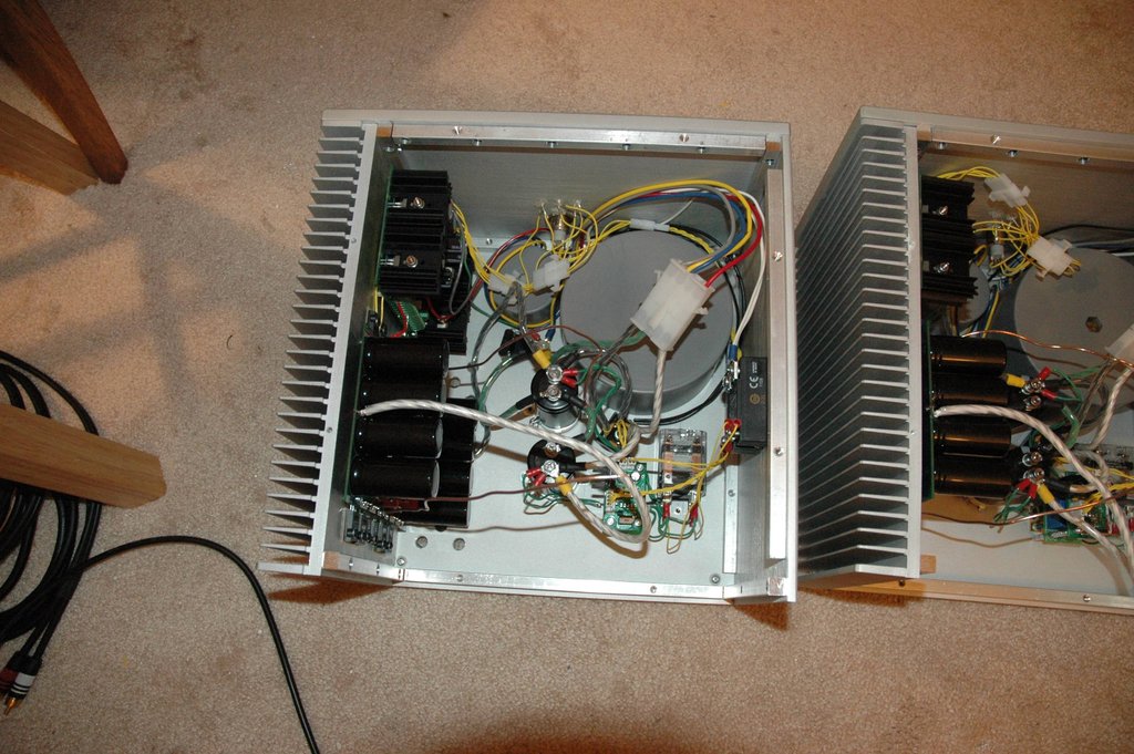

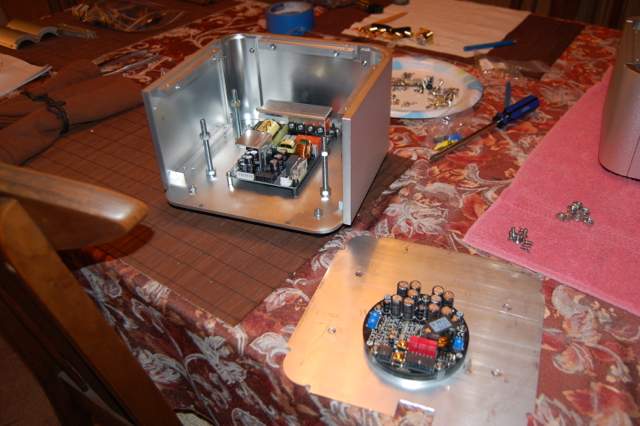

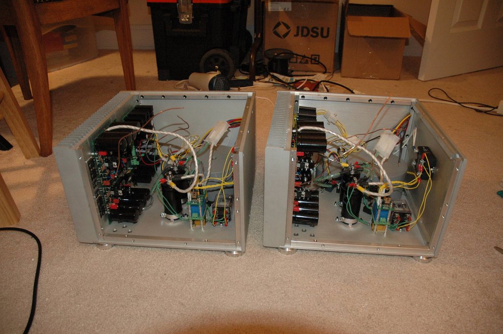

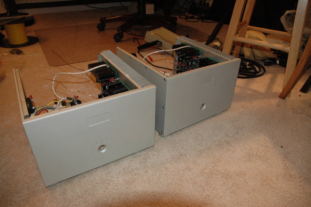

RE3220WH (x2)
Came with latching bulgin style vandal switches (led was 24v?) but I did not use them because I needed momentary, but nice nonetheless. Also, IEC sockets and a panel mount fuse holder. I requested they not come with any cutouts on the back panels, which are not pictured here. They did not charge me anything for this. Also the height is listed externally as 24mm taller than internally, this is because it comes with 4 16mm high aluminum feet and top / back / bottom are 4mm, front is 10mm, left side is 6mm.
I just put it together... need to do some heat shrinking and general tidying of wires, waiting on my rear panels.
Inside surface of heatsink is 300mm x 192mm and I think it's 42 mm thick, but about 24 mm of the 300 will not be usable due to the rectangular corner pieces and how the back piece is attached. (1cm per corner piece 4 mm for back).

Great work! is the grey round thing a transformer?
Just god an idea. it looks a bit odd when the 2 boxes are put together. Do you think it could be better if the heatsink are on different side? Shall we made 2 different enclosure and sell in pair?
Yes, the grey round things are transformers.
It would be nice if the heatsinks were on opposite sides but for me they will be mostly hidden behind my speakers anyhow. I think you would only have to mirror the front panel to make the heatsink go on the other side though.
