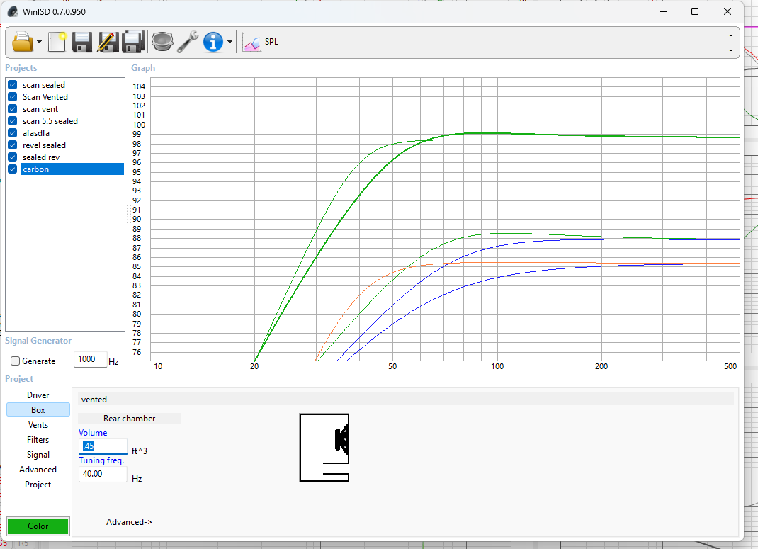

Madisound has in the description to not use it ported because of the QTS. Why is it that high QTS drivers are bad for porting?I don't think that i so expensive, the alternatives that i know are way more expensive, like the Kartesian Wom145_vHE or the Seas E0115-8 or so. Maybe a Dayton RS180 or the Peerless HDS-P835025 can come close (but not there). You ask a lot from a small woofer in a small box, and those who can handle that are pricey i'm afraid. It's not easy to do. But if you can have an outside port tube, that scanspeak is perfect.

A high qts and a low vas (like this one) does not work in a classic bookshelf as the vent is way to long to fit in the cabinet. But as you will use an external vent it can work. An aperiodic vented or restricted vented does also work as the port is a lot shortere (but is harder to design right). But most who read those comments won't build those as they are not so easy to design. So it's true, for a classic ported bookshelf these are not fit to be used vented and that is why madisound probally put that comment there.
Sealed. 35L towers, 2 midbass per side, so about 17L per midbass driver. I think that is a bit bigger than expected, but it works well for me.

Yup, that revelator does hit significantly lower than the SB. Looks like it runs out flatter where I'd be using it as well.There are better drivers for this like the Scanspeak 15W8531 that go low in 0.5cu. But you also need space for the port, and that is a long port for such a small space and low tuning. That is just physic. In 0.5cu tuned to 40Hz the port is 3" dia and 22" long. The same driver (or even your choices) are to smal lto give bass loud also, so don't expect high impact bass from something like this. I would recommend to use seperate sub with it if you want that and limit your midbass to 100Hz. That gives a lot more possibilities with what you got.

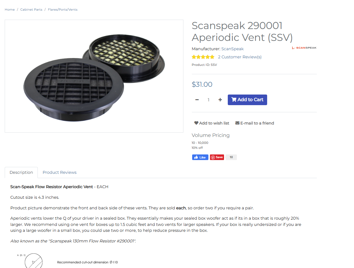

So port noise will be a problem then. Any tricky ways around this? Bends in the port, lining it, make it face a wall, etc?You probably have to deal with a nice vent resonance.
What exactly does this thing do and how are you supposed to mount it?A high qts and a low vas (like this one) does not work in a classic bookshelf as the vent is way to long to fit in the cabinet. But as you will use an external vent it can work. An aperiodic vented or restricted vented does also work as the port is a lot shortere (but is harder to design right). But most who read those comments won't build those as they are not so easy to design. So it's true, for a classic ported bookshelf these are not fit to be used vented and that is why madisound probally put that comment there.
Would it throw the Q of the driver so much as to reduce it to the same specs as one of the SB drivers?
1) Going back to the Satori vs other drivers. IF you are trying to keep costs down (which I don't think is a high priority) I just measured two Dayton RS180-8s and they model very good in 0.50-0.60 cubic feet. F3 of only 43-45Hz.
2) If the length of the port is too long, consider a passive radiator. (If you don't go sealed, that is.)
