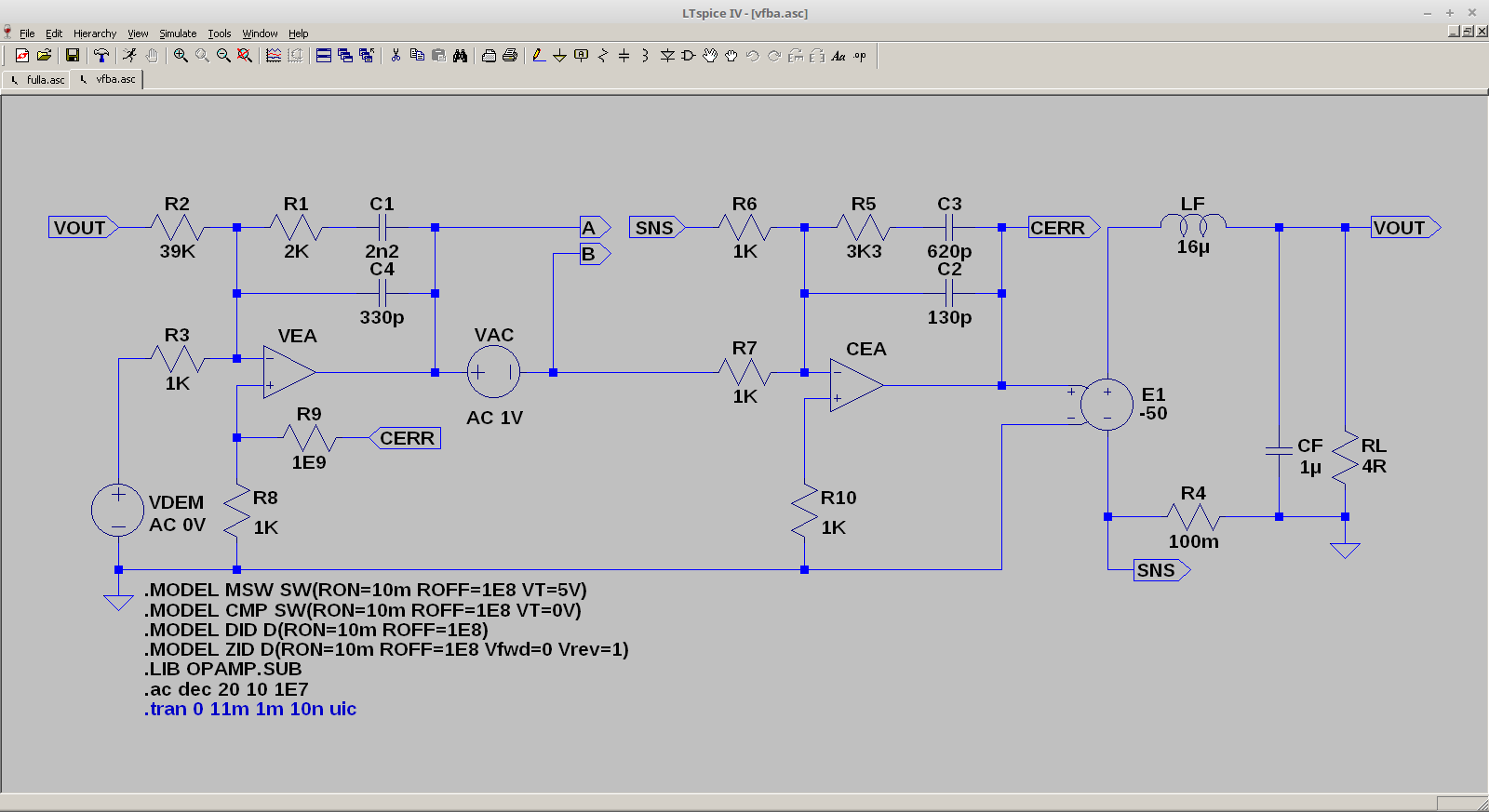

Post Filter Feedback with Average Current Mode Control
These things are known.

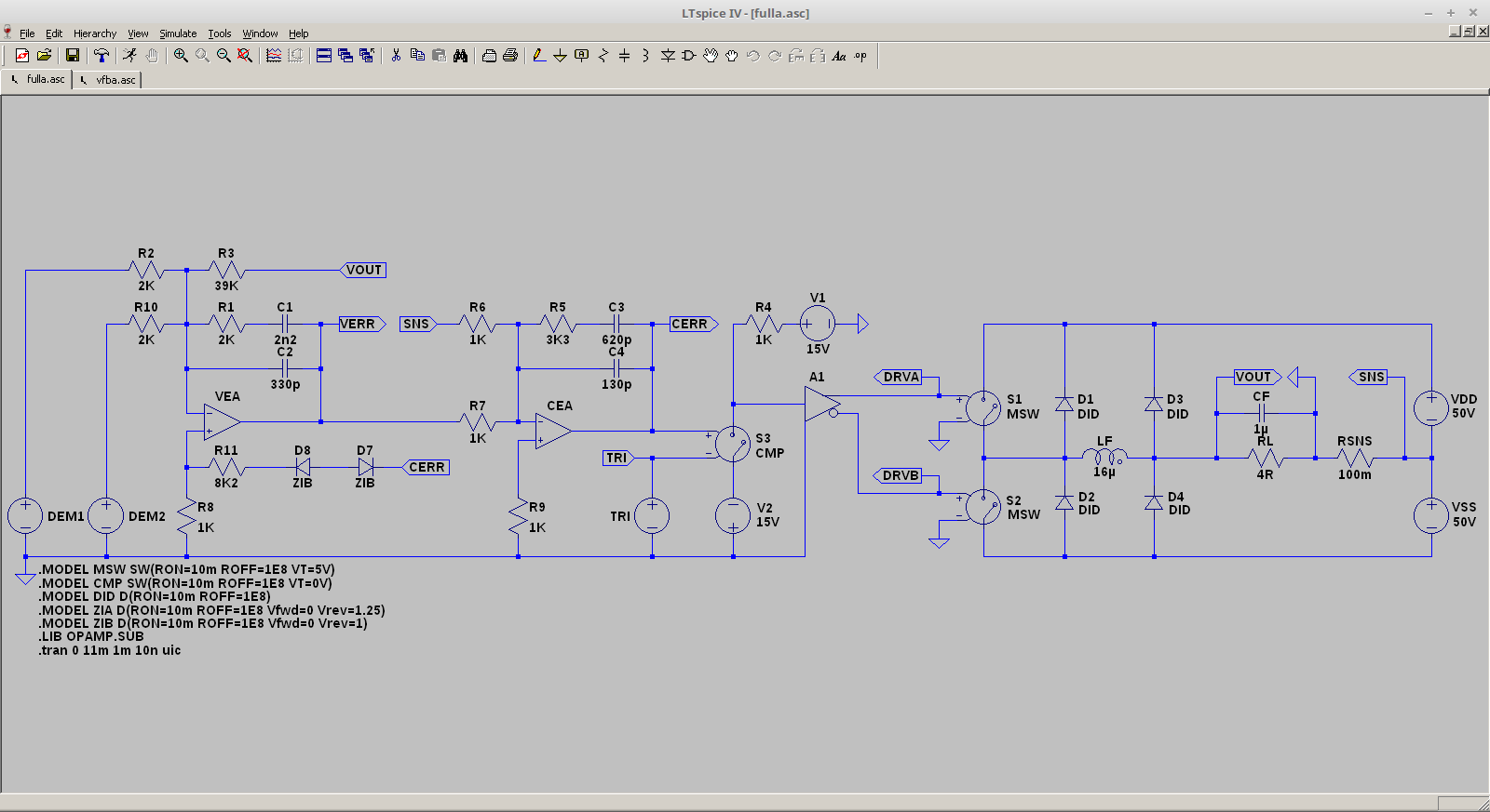

Current sensing could be improved a bit by sensing both rails instead and deriving a push-pull output thereby facilitating bridge operation as well.
Yes these things are known in the trade but seldom used by the fraternity due to lack of skills in the art.
Places the inductor in an internal loop to control its current reducing the second order LC filter response to a first order current driving a capacitor response. The filter resonance is 'hidden'.
In the case of a triangle wave modulator achieving slope matching defines the crossover frequency as being Fs/Pi, both edges are sampled.
The voltage loop is closed around the current loop. Say Fs is 500KHz the current loop crosses over at 160KHz. If the current loop has a sensitivity of 10A/V crossover would nominally occur when the capacitor has an impedance of 0R1.
1uF would be 1.59MHz. Closing the voltage loop at, say, 80KHz gives the voltage error amplifier gain as being 0.05. Pole capacitors are added to the amplifiers as required.
Unfortunately achievable bandwidth is still limited however it is still possible to get something that seems to get the job done.
https://e2echina.ti.com/cfs-file/__...-Mode-Control-of-Switching-Power-Supplies.pdf
Here is a rehash... Switching model and Linear model including an effort to control things when clipping occurs. Plot V(a)/V(b) to see the loop gain with VDEM set to AC 0V and VAC set to AC 1V.
Do the same with E1 set to -0 and R9 to 8K2 to see the loop gain when limiting occurs.

Thanks for the link.
I haven't seen Current mode control discussed for Class-D amplifiers, usually it is associated with Switch Mode Power Supplies.
They are similar, of course, but have a different context.

In your first attachment there is no earth reference for the Vdd Vss power supplies, I assume there should be?
Best wishes
David
The method and location of the current sense element is sometimes, always, a problem.
TroelsM suggests a differential location. Presumably two resistors with a diff amp to sense supply current which is in effect inductor current.
It would still mess up or otherwise influence system ground especially if you were trying to use multiple amplifiers on the same power supplies.
Ideally you might/would wish to sense inductor current directly. Perhaps that is what TroelsM meant. Sense in series with the inductor with a differential amplifier to reference the result back to ground.
