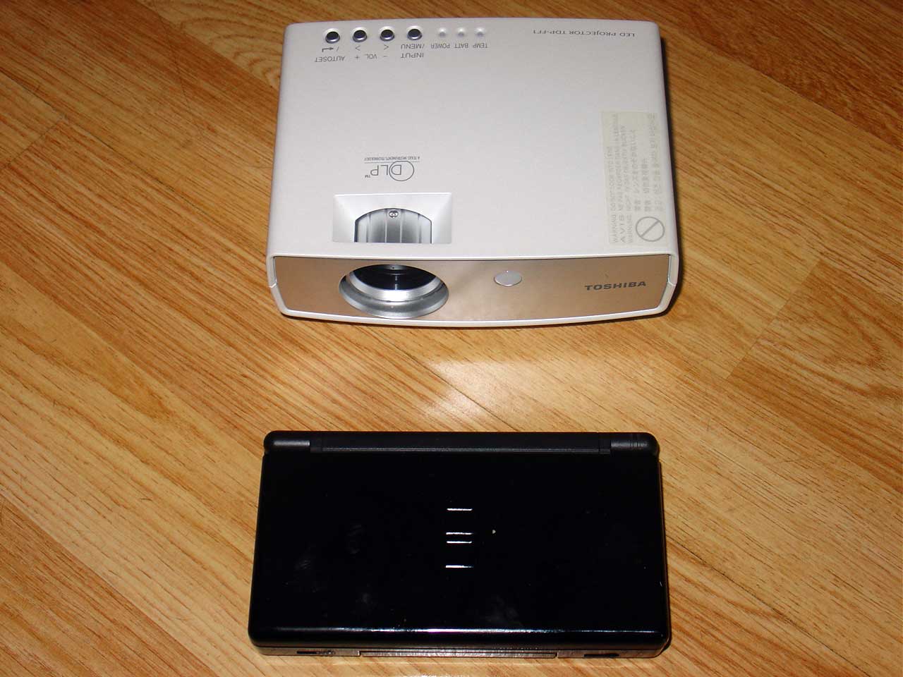

This is AWESOME. I've always enjoyed your work CrazyGuy. I'm thinking that this can be vastly improzed using the same method but on LCoS but they are just too dear. How bright is it? I've actually got a Toshiba LED DLP projector (TDP-FF1A). Have attached it so I can show off this beauty. Been meaning to open it up and have a nose inside but just can't make the time these days. That Toshiba pushes out 35 Lumens. Not good for movies just the odd presentations. What do you reckon your mod does?
You can't remove the lamp like you can do with normal projectors. I will have to open the projector up to get to the LED Lamp. I will definately open this up for guys and take some shots but I just cannot make the time. Will definately keep you posted and hopefully by the end of this month I will have some time on my hands. I think the setup will be like a standard DLP with a colour wheel but really can't be sure until it's open.
