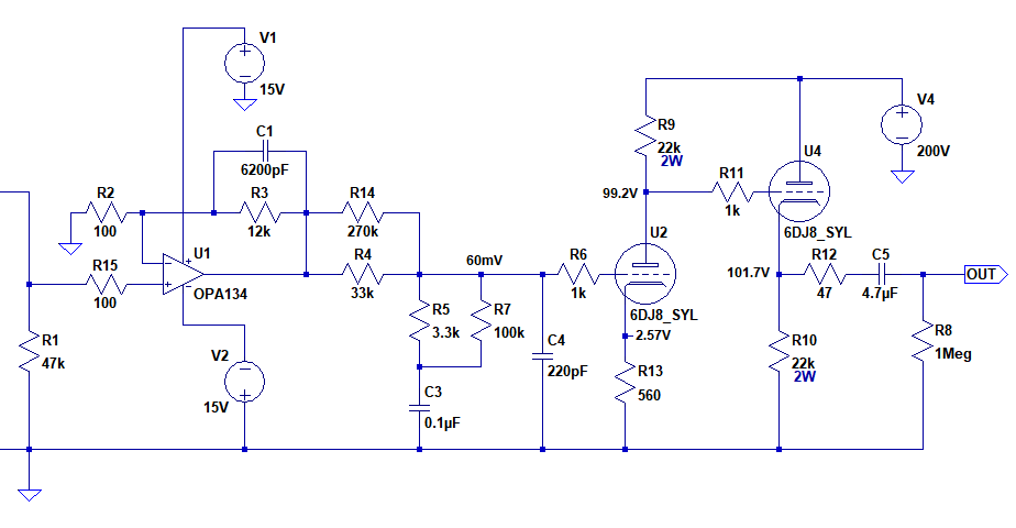

Hi Eli,
You're absolutely correct, of course. Either a 6DJ8/ECC88/6922 cascode or a good pentode would greatly reduce Cin (due to Miller effect).
I bought a sleeve of 6AC7 from the late lamented ESRC a few years ago. Would be fun to experiment with those. But is that type really a good choice for the input stage of a phono preamp? Metal can, octal base and all?
12AX7/ECC83 with unbypassed Rk as the 2nd stage looks like it should work with extremely low THD as long as it's (lightly) loaded by a follower.
6DJ8-cascode to 12AX7 (unbypassed Rk) to cathode or source follower would be a really good topology, I think. BUT... that solution requires a more complex power supply, since the cascode or pentode will have poor PSRR, right where it hurts—at the input stage where signal levels are lowest.
The op-amp has very high PSRR and only requires a +/-12V DC supply delivering 16mA or so. It also does not need a heater supply. That's just too cheap, easy and high performing to ignore. Then the triodes run at higher signal levels so the power supply has to be merely 'good' instead of 'damn near noiseless'.
Now, whether or not I'll enjoy the sound from it is another story. I do like that 'tube sound'...

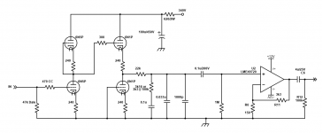

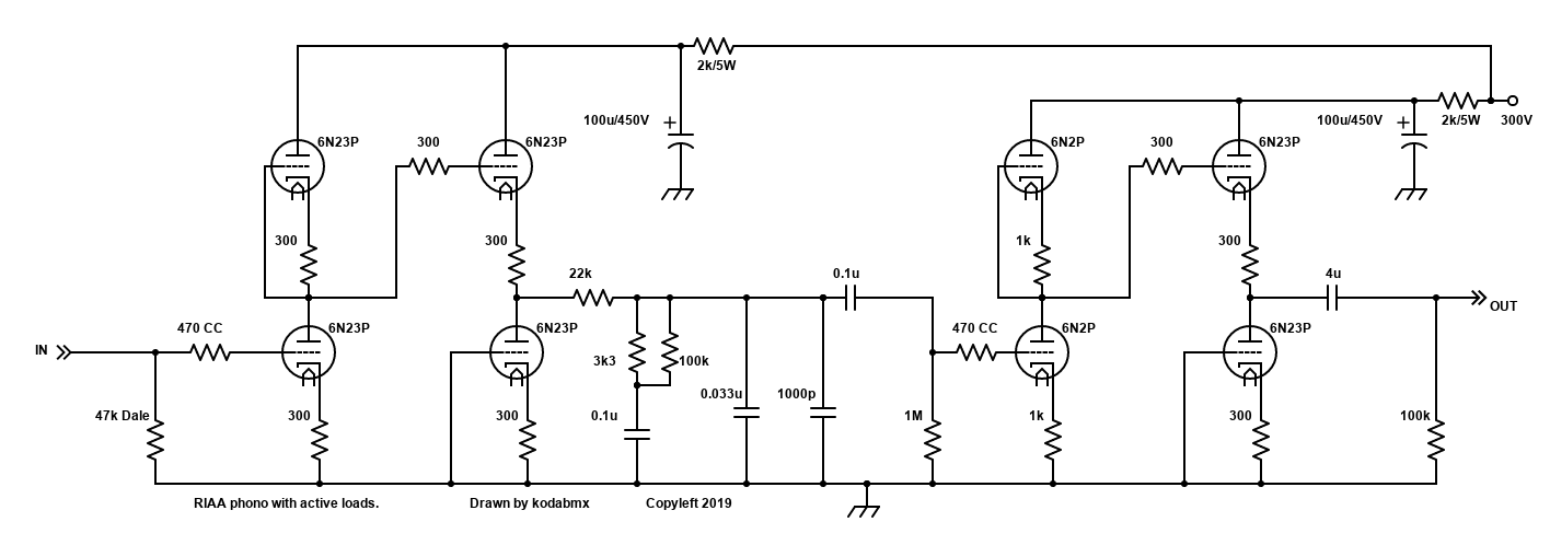

Idea 1 is basically a simplified Aikido Phono Stage, no? The active load ('half-mu') stage has half the gain of a common cathode amp, which would probably push me to put a 12AX7 or 6N2P for the first two stages.
The second one is interesting. However, in a phono stage, don't you want as much clean gain as possible up front in the first stage, to reduce noise? Interesting idea to use 6BQ7 as the input tube...

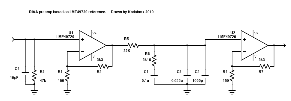

The third one is basically the same as the Bugle, but using a different opamp (I'm using OPA2134s). It's pretty good, actually.
Idea one is an Aikido without the Aikido... So I just call it active loading.
The second one I designed as an alternative to using 6N6P or the like to drive low Z Hi C load/cable.
The third one should be interesting. I want to modify it to use a single 9V supply. Battery RIAA 🙂
The actual design I use is the first, but I use 6N1, 6N3, 6N2, 6N3 for it. Same parts though. Powered by a 12V SMPS for the heaters that also powers a DC-DC boost bodule to make 280V for the B+. No noise/hum is disearnable with headphones so I call it plenty good clean enough.

Koifarm, where did you find this hybrid prono pre? Is the PCB for sale somewhere?
Regards, Gerrit
Regards, Gerrit
Hello Gerrit,
it is my own design and part of the sound and comfort preamp also here on diyaudio.
You can use the mm phone preamp also standalone as i did i my preamp.
The PCB i made myself but in the thread i can publisch the gerber files so you can order the PCB yourself.
Hey Koifarm, nice one!
So you had the op-amp do all the RIAA EQ in its feedback loop, and the 2C51 mu-follower for the output stage.
Why 2C51 (or 6N3P or 5670)? Any special reason? Would an ECC88 or 6DJ8 work as well?

Or ditch the tubes entirely and go with the third one......The third one is basically the same as the Bugle, but using a different opamp (I'm using OPA2134s). It's pretty good, actually.
The third schematic looked familiar, so I looked in my computer and it is. I built one of these right into the base of by old 1980 vintage Technics direct drive TT over 10 years ago. The schematic comes from the front page of the National Semiconductor (before TI) LME49720 data sheet.
Since there is no cable between the arm and the PC board I put a larger than 10 pF cap at the input. If I remember right there are two sets of caps and a jumper plug to accommodate two different carts.
I haven't opened the TT up in several years, so I may not remember if that's true. I did make two or three different boards. One was tiny enough to fit inside the headshell, but that idea didn't work out. Power must be muxed with signal since there are only 4 wires in the arm......I never got it working right.
Hello,
bendix 2C51 is just my favourit preamp tube. I use it in the outputstage of my shanling cd T100se CD player , MHZS CD33 cd player, phonodude mm preamp and the sound and comfort preamp.
But shure you can use ecc88. Amplication changes from 40 to 100 times, so the opamp needs to amplicate less.( change R28 to 4k7). Maybe you must change the resistors of the tubestage to get the right setting.
PL38 is the phono input without impedance loading, you must ad resistor and capacitor according to your cartridge. And you can use several other opamps. At the moment i use AD847 but you can also try OPA134 or NE5534.
